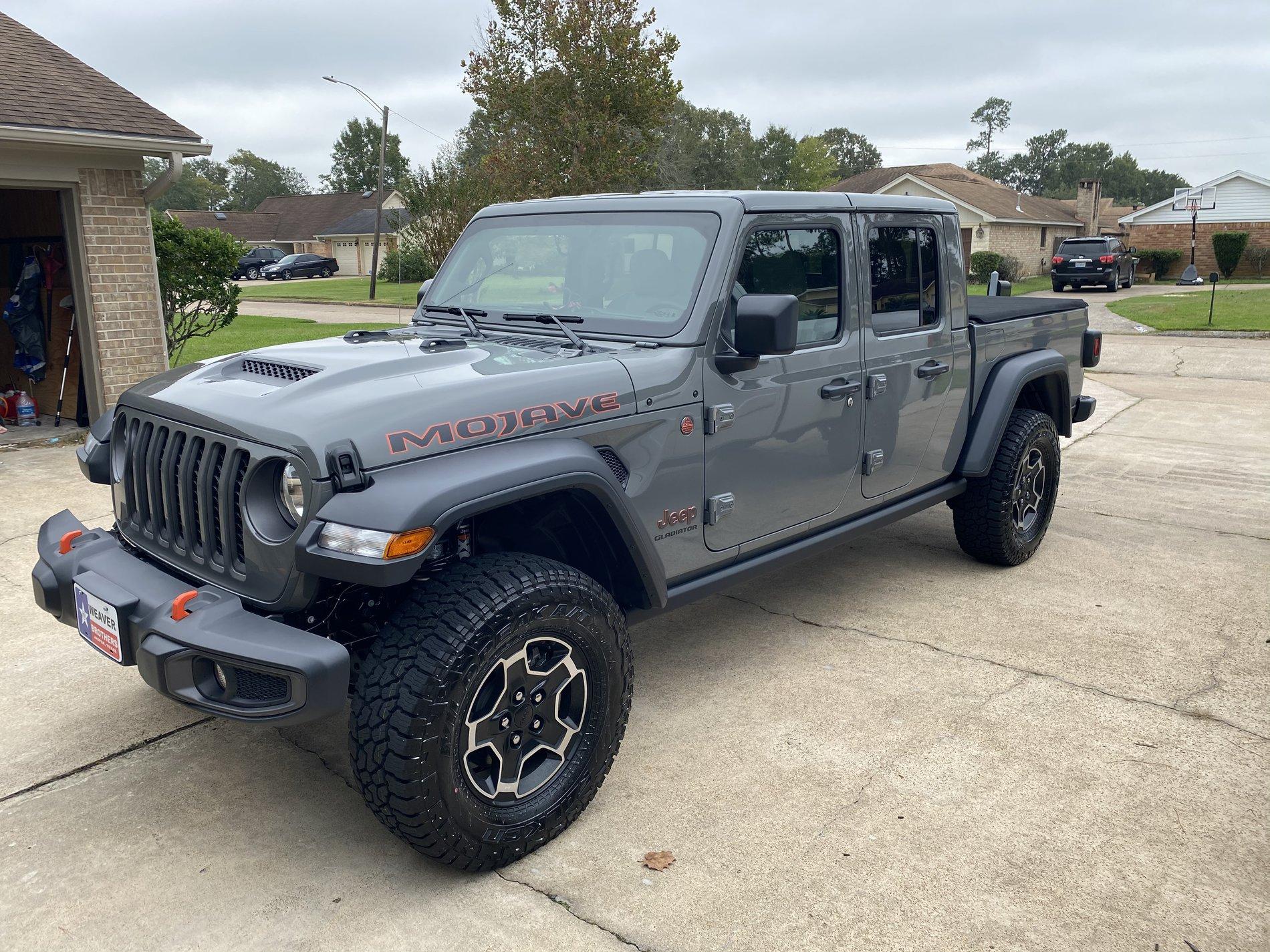

Just traded by sport s in for one. By far the best riding Jeep ever made. Even if you don’t get one to do what it’s built for and only mall crawl it’s worth it for the suspension alone. That’s if you want to ride around in a Jeep of course.

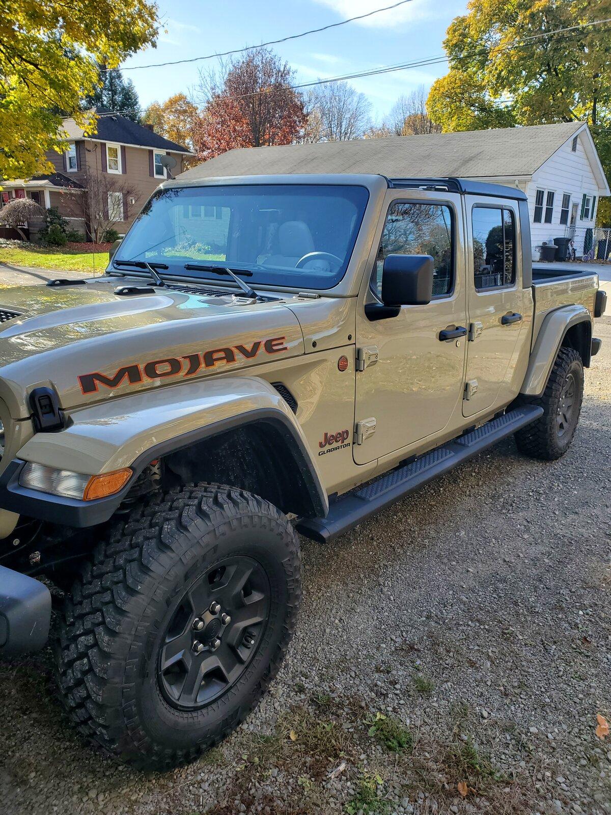

Wondering if Mojave has eluded the gremlins that have caught on with the other trim levels, such as the steering dead spot or the dreaded cylinder misfire issue.
What say you Mojave owners... anything problems yet?
Just got mine about a month ago and I love it. It's got about 1500 miles on it after driving it from Florida to PA. The only issues I have are finding mods/customizations specifically for my bad ass Mojave.
