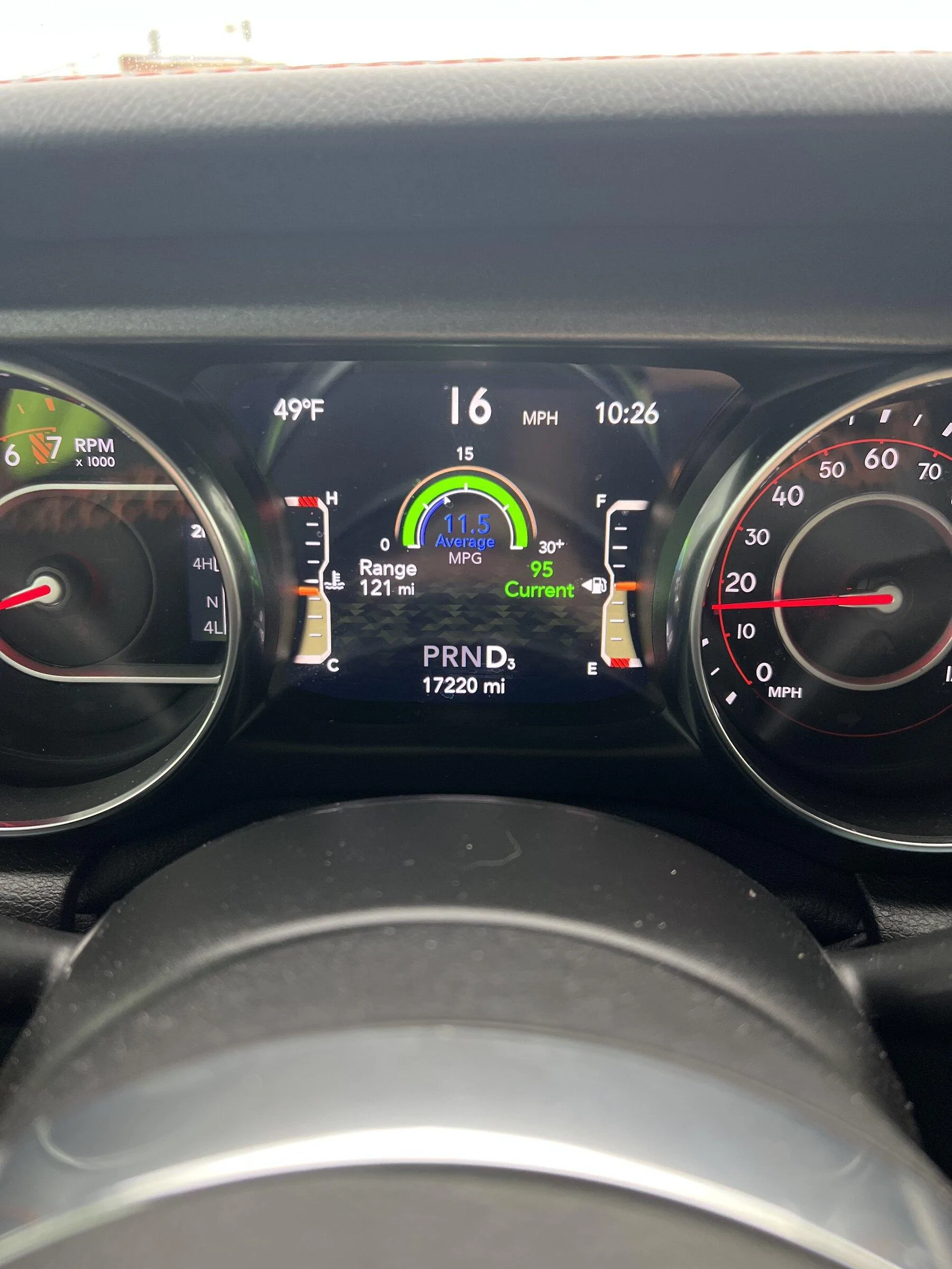

Haha! You know Morgantown! Definitely uphill both ways but damn, 11.4 MPG!! Seems like something has to be wrong. I let it go to break in but I'm at 1,600 miles and no change.
I do. I grew up in Western MD, not terribly far from you. 1600 miles isn't a whole lot, so it might get better still, but on hills, it's just not that good in these. Knowing your terrain, and knowing the 3.6, I wouldn't expect a whole lot better.
They didn't name the WVU mascot the Moutnaineer for nothing. You're basically pulling a boat anchor uphill into the wind both ways

Y'all think its worth a trip to the dealer or should I wait it out a little longer?
Unless it has stored codes in the computer, the dealer will tell you there is nothing they can do. You could ask them to check the transmission fluid level and put it back in learn mode to see if it helps.
Wait. Or move to a flatter area. Does your Jeep sit taller than your wife's Grand Cherokee? Notice the angle of your windshield and body compared to hers.

Flip the hook over and you won't accumulate water in the pin.
Yea not moving anywhere flat. And yes its taller than the grand cherokee and yes the windshield is a different angle. But do those few factors warrant a 6-8 mpg difference especially when she has a HEMI????
In your conditions, the hemi would probably actually get better mpgs, if it's the 5.7. Wranglers and Gladiators are big heavy bricks with 0 aero profile. The 3.6 doesn't make much low end torque, which you need to climb and to push through wind. You'll get single digit mpgs uphill, and major losses into wind.
