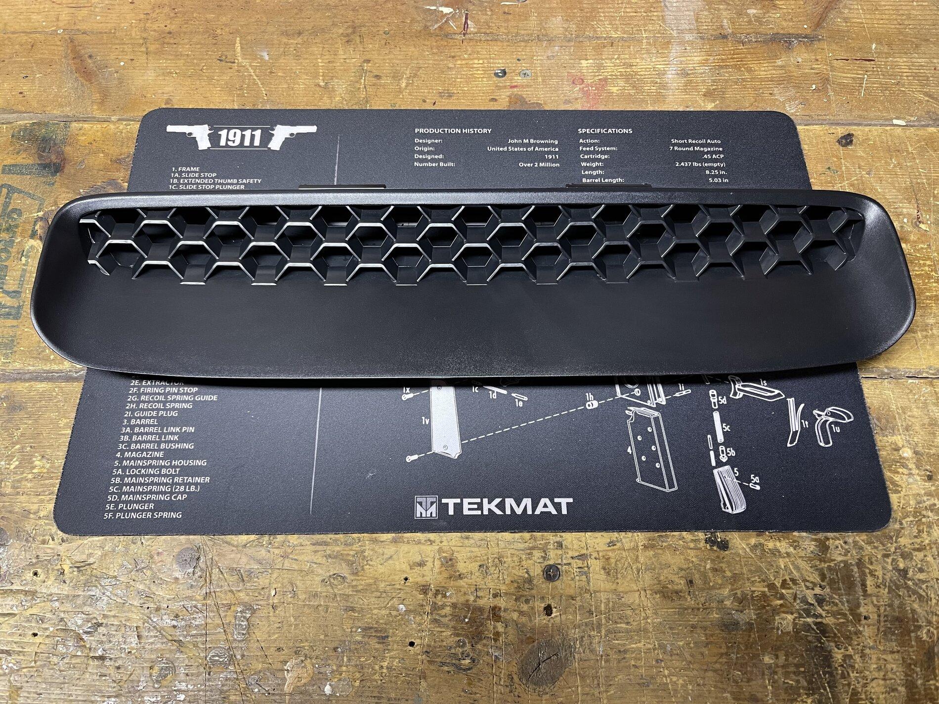

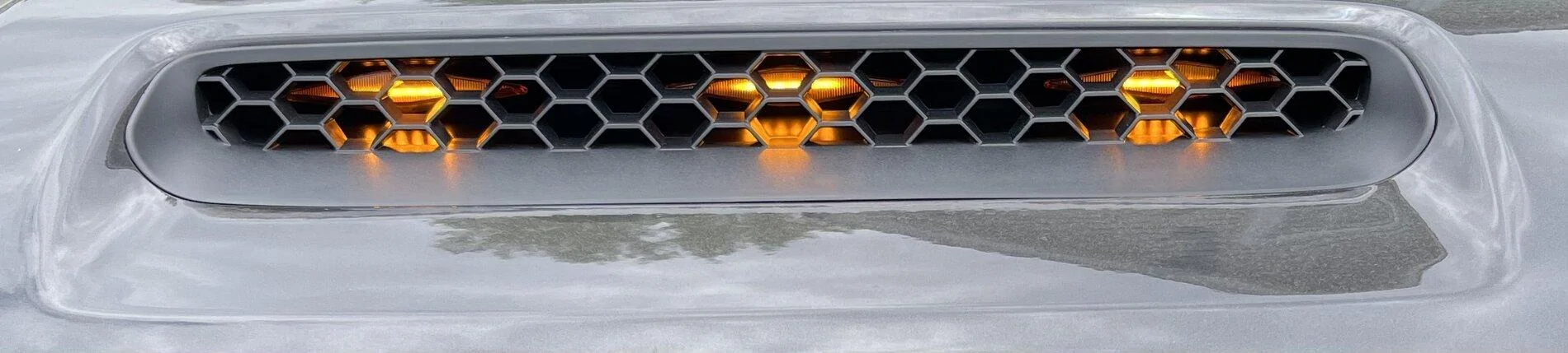

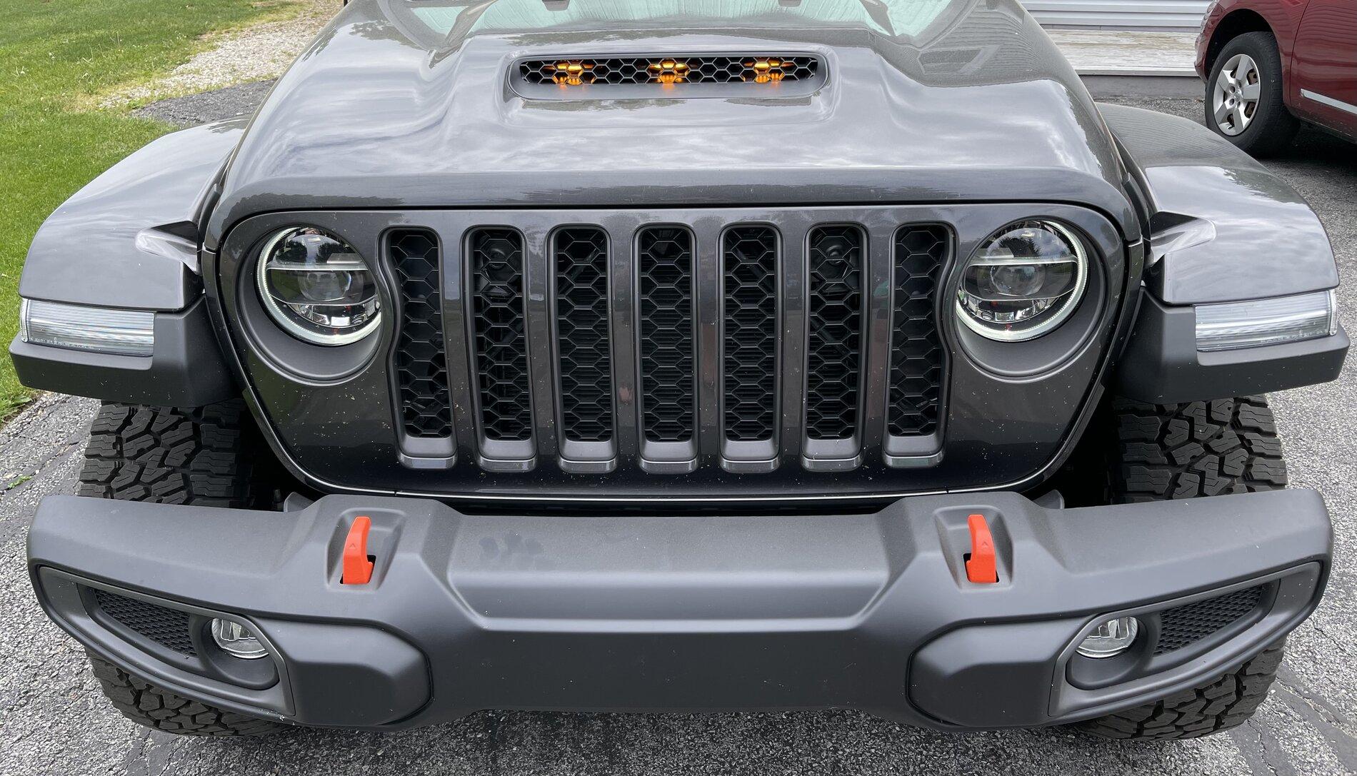

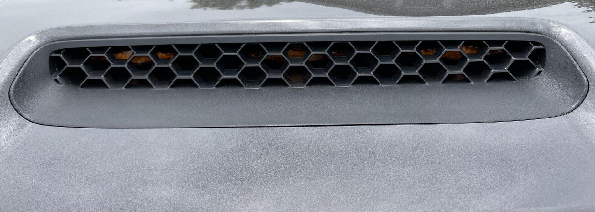

I wanted to install running lights in my Mojave hood scoop that were more oblong (like the Ram TRX hood scoop lights) and less round like the Quadratec/Oracle pre-runner light kit offerings.
Jeep Gladiator Mojave Hood Scoop Running Lights 842FCA7E-FA06-456A-BF9F-8D8B06E0DC13
Jeep Gladiator Mojave Hood Scoop Running Lights 49FF9DA2-A832-4488-9662-4B463032EFF6
Jeep Gladiator Mojave Hood Scoop Running Lights D087BC7F-A080-4E38-96B4-C01903EF75B9
After searching around Amazon, I found an amber light kit designed for use on a Toyota that I thought would work with some modification.
Jeep Gladiator Mojave Hood Scoop Running Lights 8227D8C5-314A-44C9-929F-38D3074429C5
https://www.amazon.com/Seven-Sparta...jbGlja1JlZGlyZWN0JmRvTm90TG9nQ2xpY2s9dHJ1ZQ==

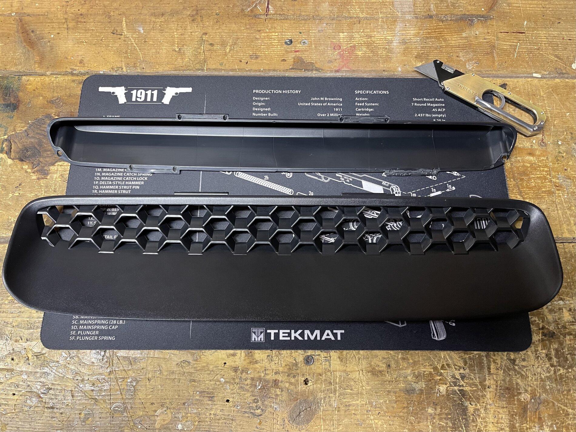

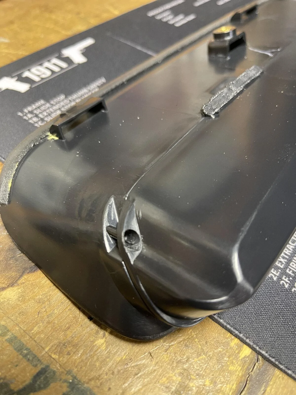

I started by removing the hood scoop and separating it into two pieces.
Jeep Gladiator Mojave Hood Scoop Running Lights 42BB1997-C1C9-4FAF-BD30-0020E334850D
Jeep Gladiator Mojave Hood Scoop Running Lights 72A78DDC-B75B-4C21-8086-552609BB32A9
Jeep Gladiator Mojave Hood Scoop Running Lights 33BDEBC4-F39C-4BFB-AFE0-8FB858A1B8C7

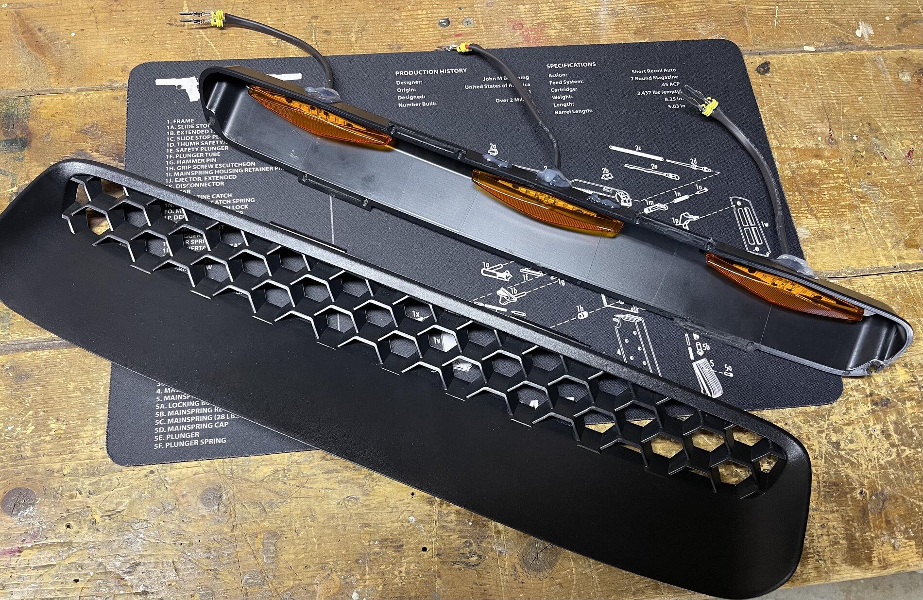

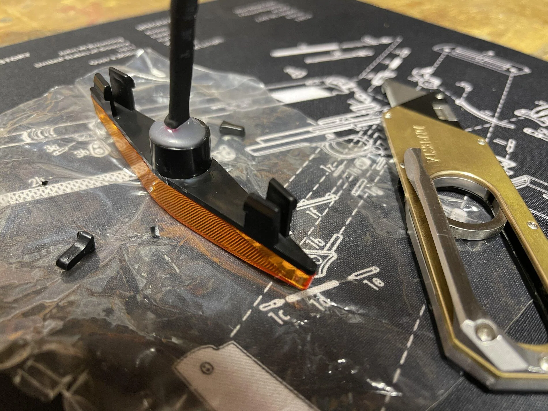

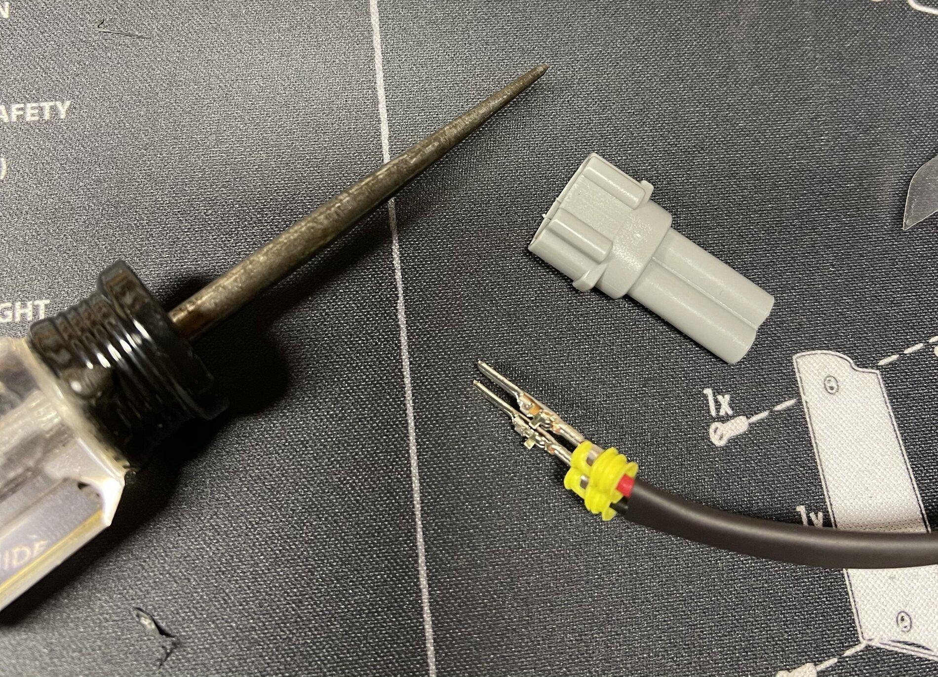

I de-pinned the wiring plug connections (to more easily fit the wires through the holes i drilled in the back of the hood scoop) and trimmed the Toyota-specific mounting tabs on three of the lights.
Jeep Gladiator Mojave Hood Scoop Running Lights 9C3C45D0-623A-48FE-8893-76E35E96F512
Jeep Gladiator Mojave Hood Scoop Running Lights 4DE08675-36DC-4F28-AD75-6773A11DCA83
I used hot glue to “seal” and mount the lights to the back hood scoop piece.
Jeep Gladiator Mojave Hood Scoop Running Lights B1D8C8B8-CEEC-43CE-BF82-4CB155242C2E
There are a few ways you can wire the lights up depending on your needs and the control that you want. I wired them to one of my AUX switches. (I also taped-off the fourth connection included with the wiring harness, since I am only using three lights.)

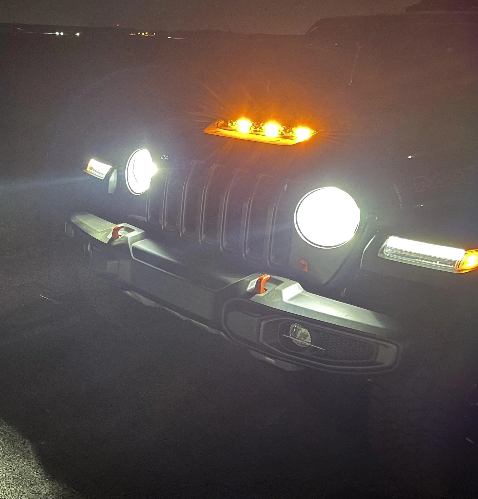

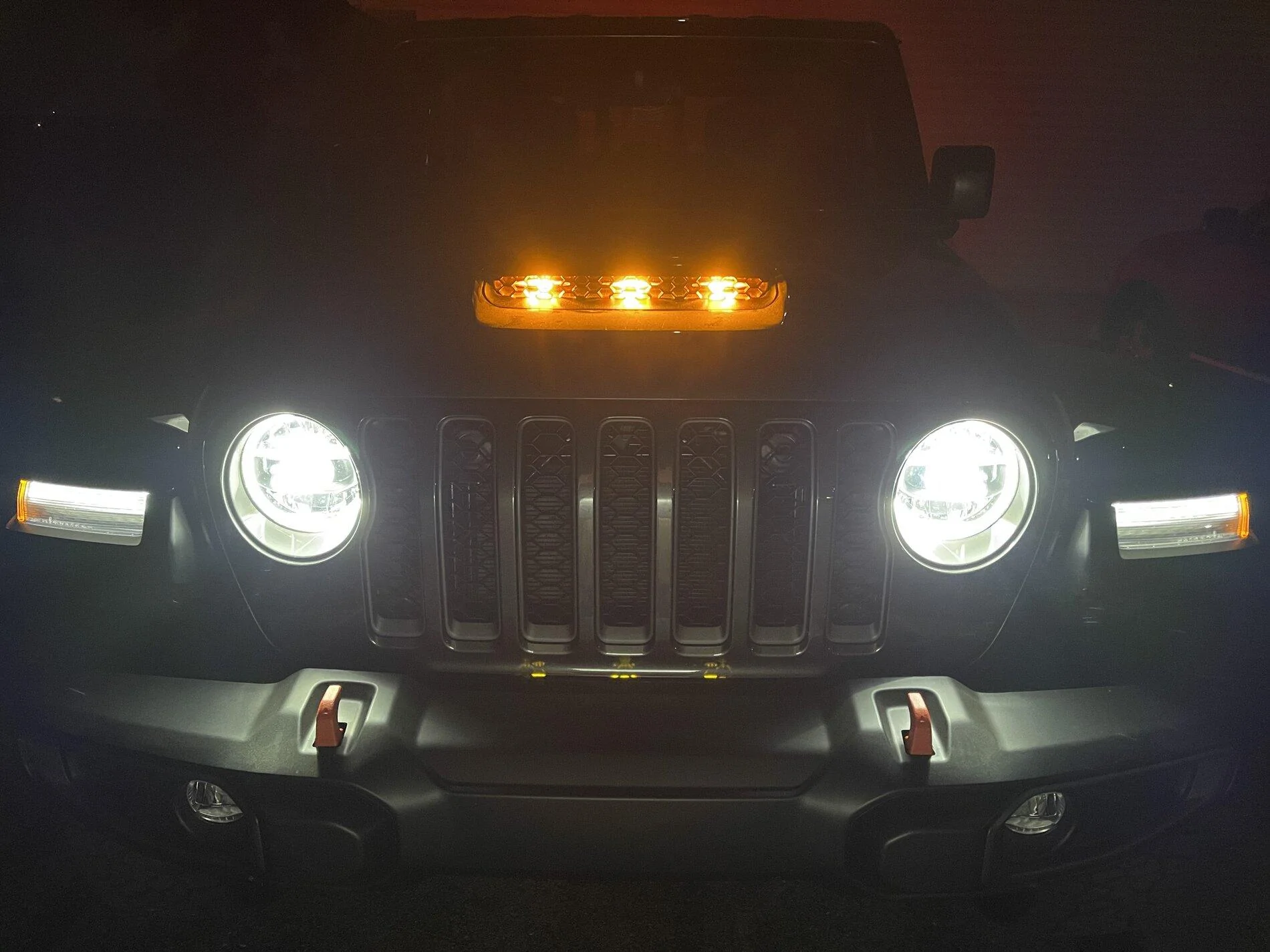

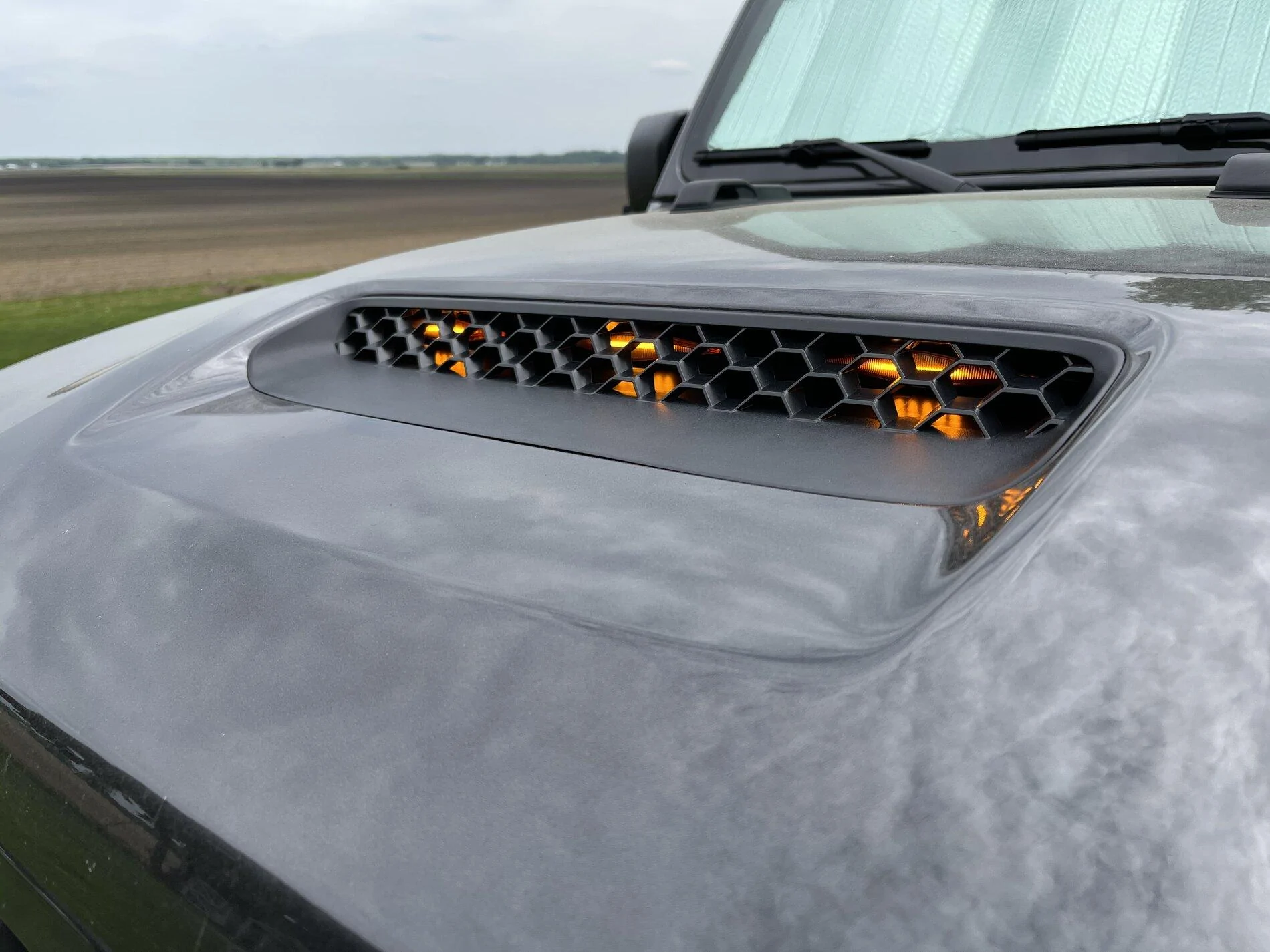

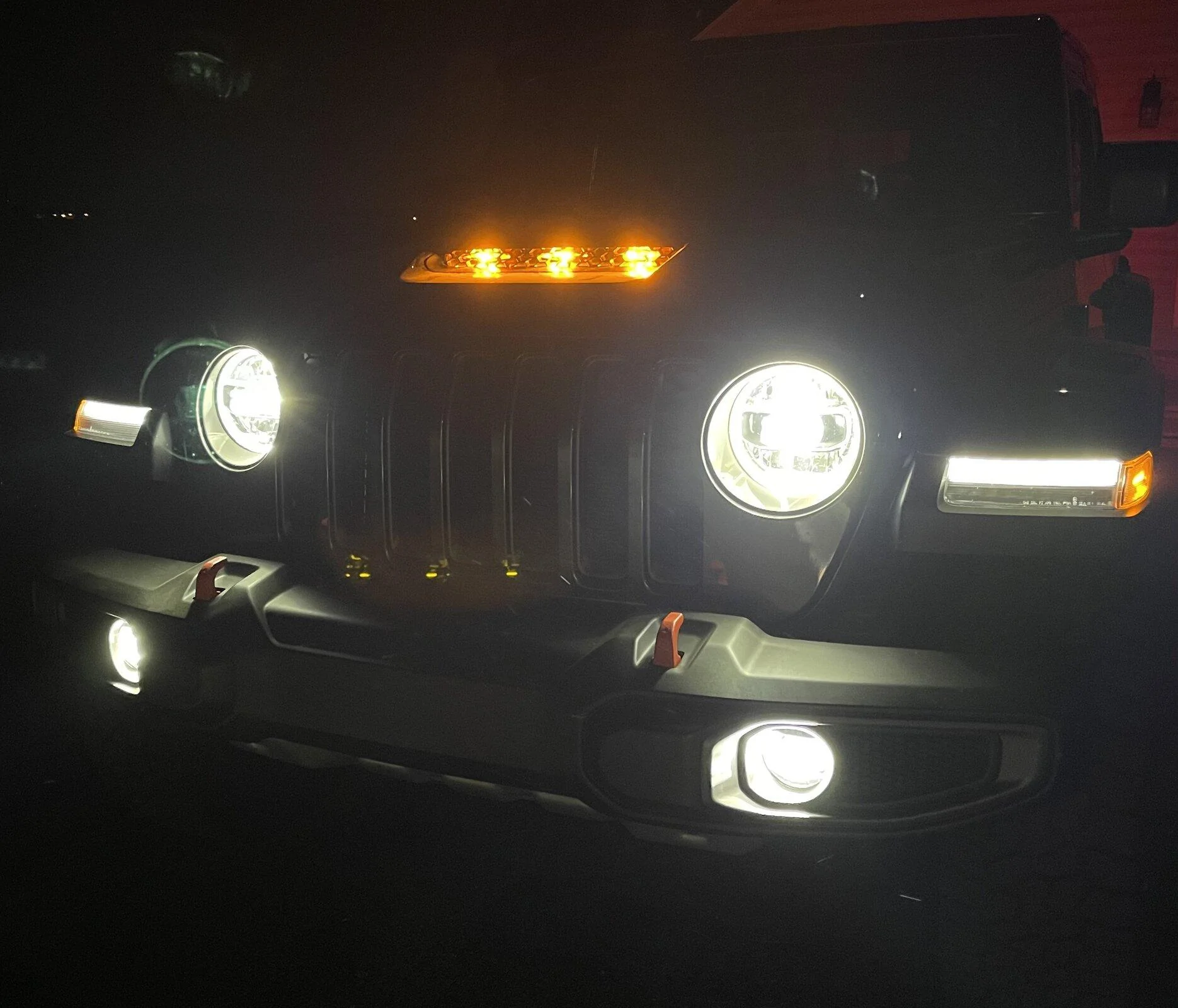

I am happy with how it turned out. Only time will tell the longevity and advertised “waterproof-ness” of the LEDs. I tried to take pics with minimal glare and reflections, especially in the night pics.
Jeep Gladiator Mojave Hood Scoop Running Lights 739C7723-4B47-4206-93A2-C877F9FCD588
Jeep Gladiator Mojave Hood Scoop Running Lights 57B4425B-D0C3-4EBA-A2CD-FE2C2CD5CB99
Jeep Gladiator Mojave Hood Scoop Running Lights F11519DA-FD8D-4BB1-9A89-BF05DBFAB23C
Jeep Gladiator Mojave Hood Scoop Running Lights C0E14563-1CB2-4B02-BC7F-89F7F5FA052C
Jeep Gladiator Mojave Hood Scoop Running Lights 72813798-E141-4BE8-9CF4-77AF4BF88BF8
Jeep Gladiator Mojave Hood Scoop Running Lights 6E736AB2-5929-4DFC-8CDF-AA3C6F01B846
Jeep Gladiator Mojave Hood Scoop Running Lights C7FAE009-5BDC-4B4A-B8CD-AD798E6779CC

Nice clean discrete install. Just curious as to why you didn’t mount outside the grill? Aesthetics? Tabs wouldn’t line up?
R0BSTR0SITY
R0BSTR0SITY
Rob
Apr 6, 2021
56
137
Ohio
2021 Gladiator Mojave
HVAC-R
The LED kit that I used is designed to fit in the grille openings of a Toyota. Not the same shape openings in the hood scoop on the Mojave. I do prefer the discrete look behind the outer hood scoop also.
