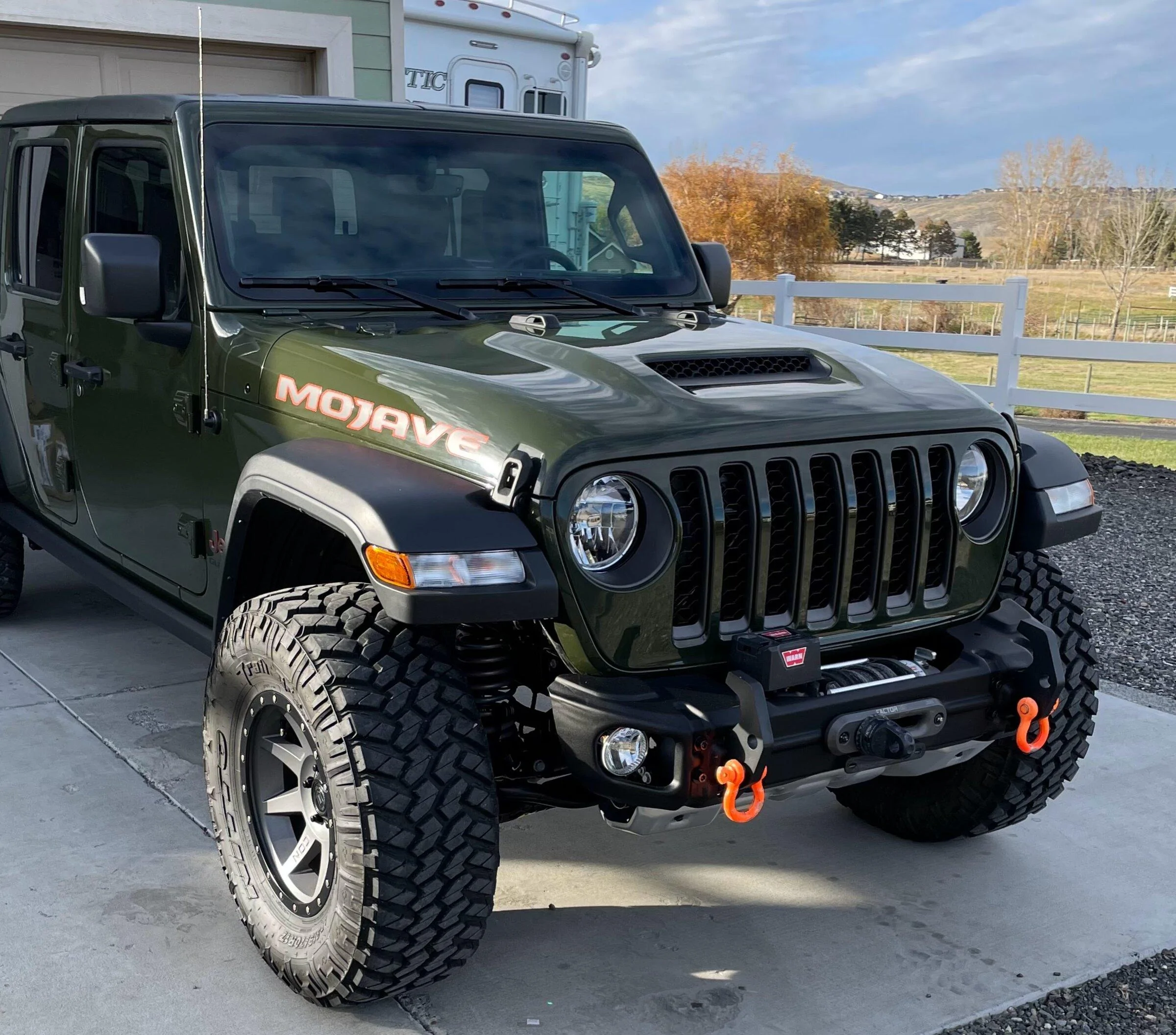

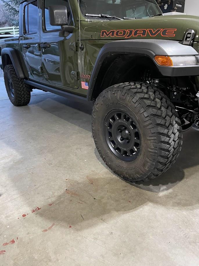

I moved some icon wheels from my jl to the jt and did not like the poke -6 offset for the icons. Purchased the AEV with +25 offset and like the look way better. Sorry not great photos
This calculator may help
https://tiresize.com/wheel-offset-calculator/
Aev Salta +25 offset
Jeep Gladiator Mojave - Method 701s IMG_0150
Icon Rebound -6
Jeep Gladiator Mojave - Method 701s IMG_0146
Icon Rebound -6
What is the wheel width on the AEVs? Looks almost flush flush with the fenders.
i have been looking at those AEV wheels. They look great! Is that the satin or onyx black?
