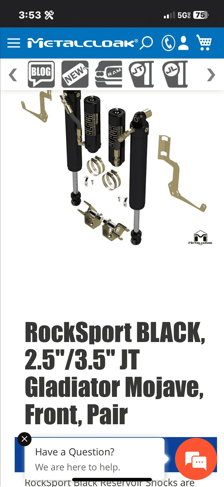

I did check with MetalCloak and they said that they do not have shocks for to fit a pure Mojave.
How long ago did you check? I was told it would be a month a few weeks back when they first came out. Checked the site yesterday and saw this along with the rear set. I will reach out tomorrow and confirm.
Over three weeks ago…he did say that they have something coming out soon.
If you try them and they work out for you, great let everyone know.
Now go back and read the whole thread & you will see that my Mojave is pure stock and I am trying to get my rear shocks covered under warranty as in free, free And not $1,400

I did check with MetalCloak and they said that they do not have shocks for to fit a pure stock Mojave.
So you contacted Metal Cloak just for future knowledge? I may have misunderstood. Happens often on forums. Best of luck getting your shocks replaced for free.
No problem, I was thinking that I would get a lift from MetalCloak someday and buying their shocks now “might” be better in the long run, but decided best to get free now and do the lift all at once later.

I did not read through all the posts here so forgive me if already discussed on this thread. I was thinking about Rocksports by Metal cloak. My shocks are making noise as well @ 33k miles.
These are in consideration for sure, waiting for real life reviews before I go all in. Especially at the co$t. But OMG are they sexy!!!
RockSport Black Adjustable Reservoir Shocks Mojave JT | Metalcloak
actually thats a decent price. Thx for sharing, I was considering getting nicer FOXs in the future but this is much more user friendly and cheaper.
