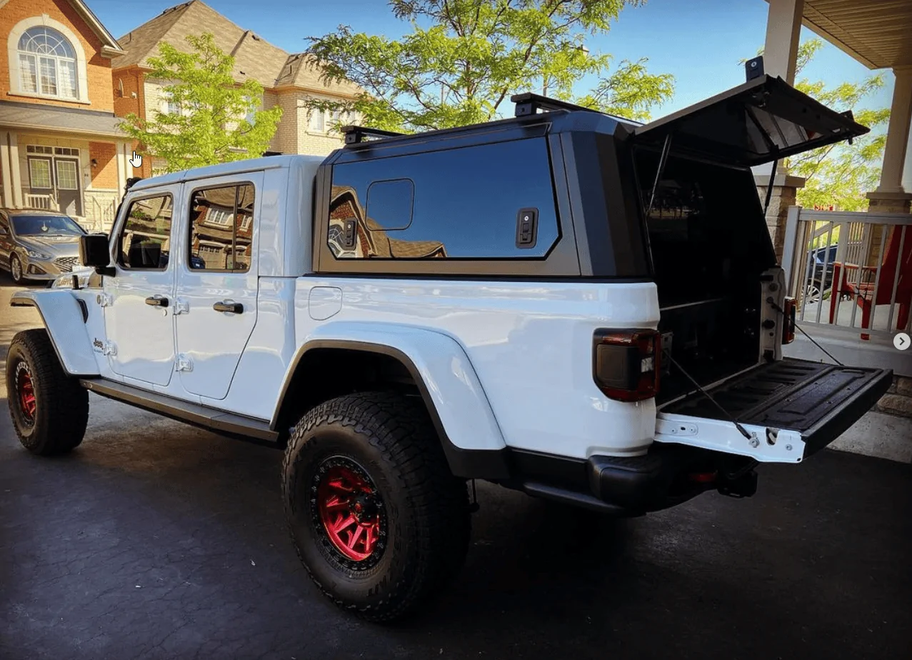

i had the RSI Cap & Decked system put on a few weeks back and the jeep looks more level now..this was the day i had the cap on ill take new pics this weekend it looks alot better now
