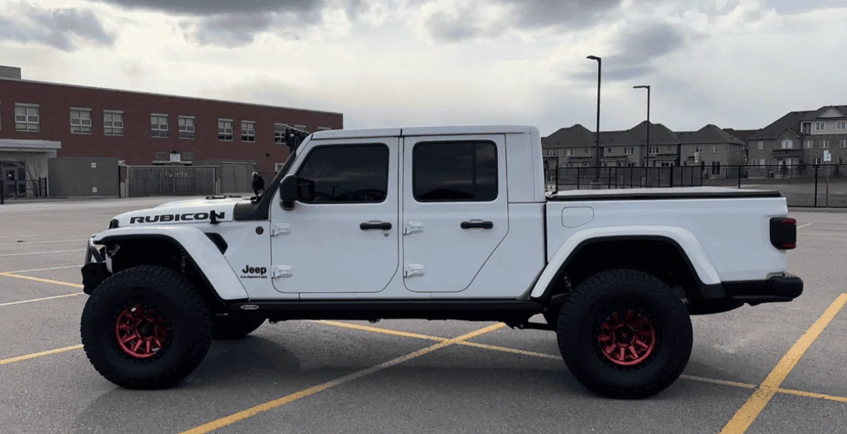

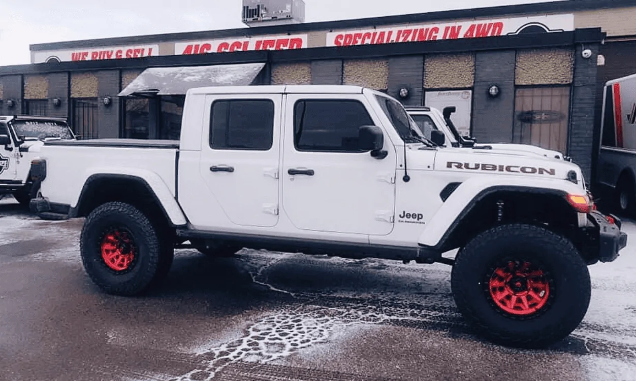

getting a bit annoyed with the Mopar lift, had it for almost a year now and it rides great. I do have a daystar 3/4 front spacer and TF front track bar
the front has started to sag when i first got it it was less than 1/2 inch lower in the front.. no big deal couldn't really tell
Now with the bumper and winch its over 1 1/2 inches lower in the front :( getting RSI cap next week lets see if it "levels" out
