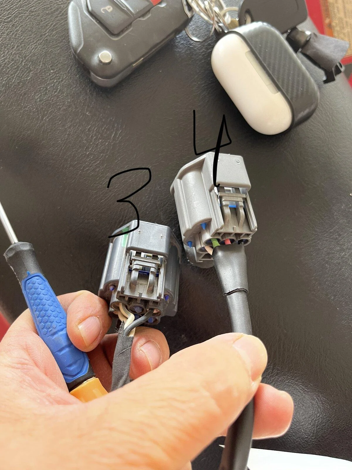

I just upgraded to the MOPAR LED headlights. I have 2021 Mojave and on the plug to the back of the lights has 4 wires. I am still not able to get my halos to come on with the ECRI option for activating halos.
Do you have that 4th cable even on the passenger light? We posted the cable that we had to buy separately to make it work. Mine worked fine once I swapped that cable and had the dealership flash it.
i will check again, but I’m 99% sure both plugs into the back of the headlights were 4 wires.

That small cable is located in the passenger side only. If you do have it then you need to tune it properly. The tune is called LPX at the dealership

So I just checked the harness all at the plugs the lights and BCM. Wires are all there and connected. Using the ECRI module and still not activating the halos.
