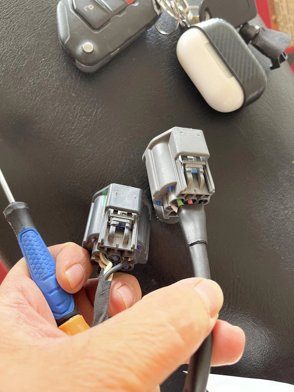

yes. One was a tan with blue stripe and the passenger side was tan with red I believe
That makes sense--I have 4 wires on the driver side, on 3 on the passenger side. Frustrating, since they ran the 4th wire on the passenger's side all the way to the front of the vehicle... but didn't want to put in the extra 16".

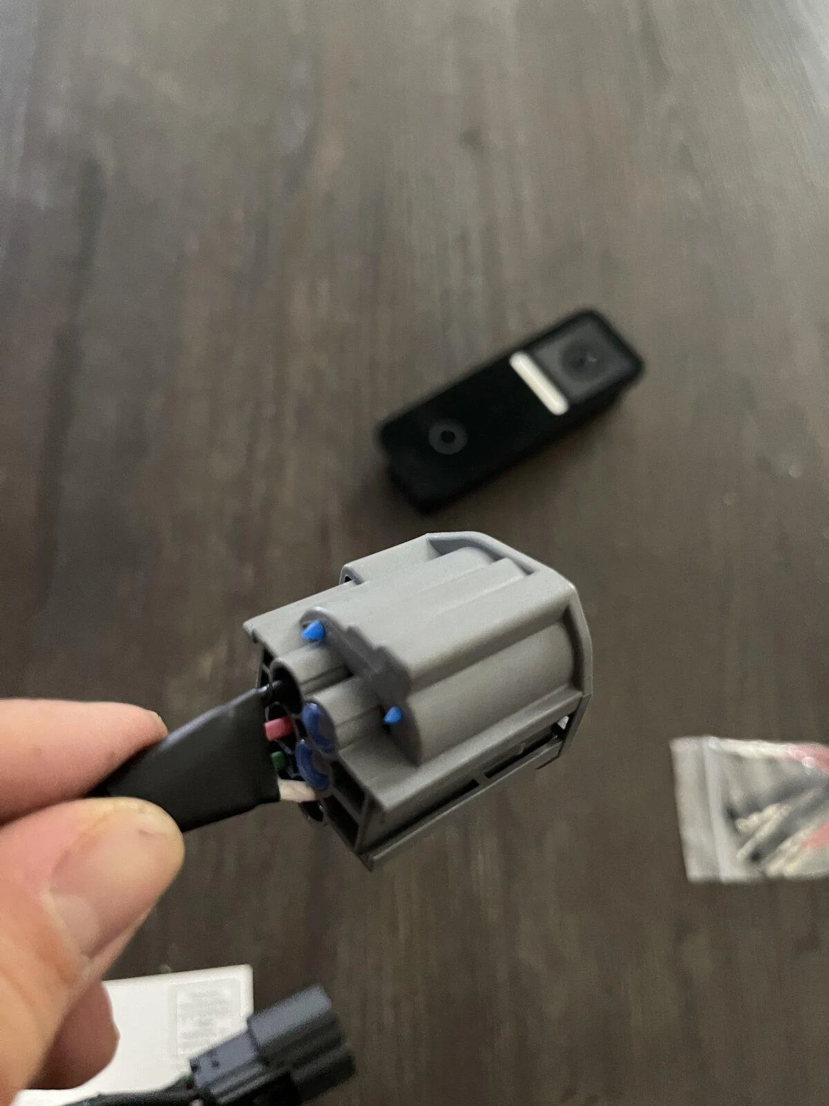

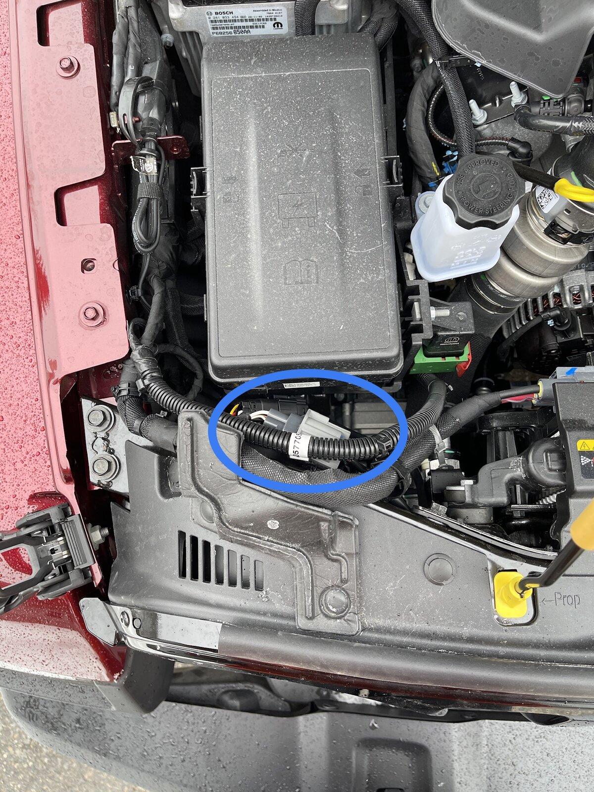

The headlight plug on the drivers side had 4 pins already going to it. For the passenger side, there were only 3 at the headlight, but that went up to this plug located near the front, circled in blue. The left side of the harness had 4 wires, and the harness that I replaced only had 3. This was about a foot long harness that I replaced with the one from eBay, so that it had 4 wires and I didnā€™t have to run any extra wires.

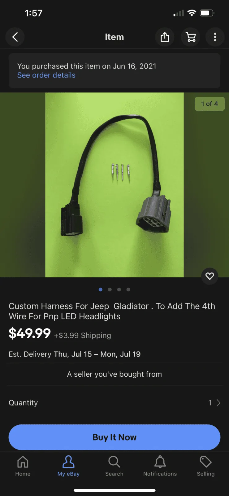

Hey futureOdin. I got the wire form the guy you got it from. He is selling it for 40 now haha but it looks good. I installed the wire today but had my jeep flashed at the dealer about a week ago and it doesnā€™t work ā˜¹. Hopefully they didnā€™t put the correct flash for the headlights hence thatā€™s the reason why inst working properly at the moment. But I just wanted to thank you for the hook up šŸ˜ƒ

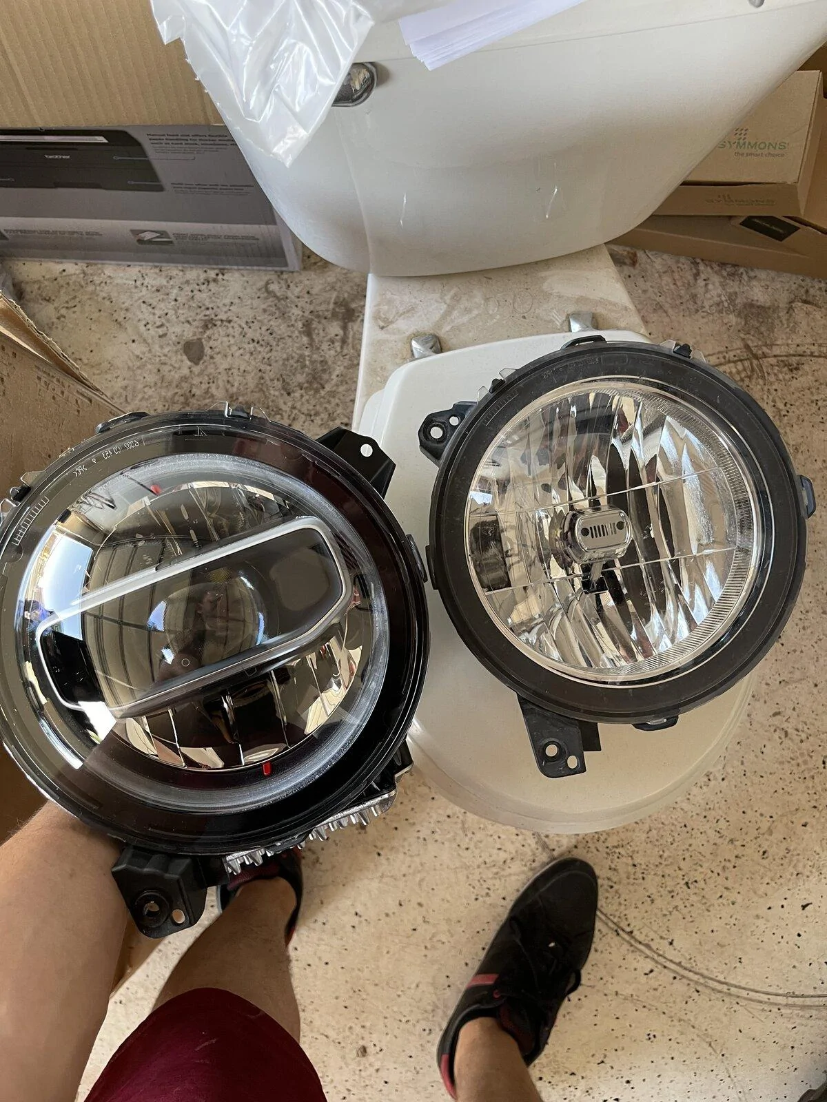

I was going to go with the Oculus lights, but I'm not really a fan of the style... the single bulb in the middle makes it look like creepy eyes... heh
I went with Bunker ones from Amazon--decent reviews, and the cheapest 9" I found. Hoping they aren't crap.
But to continue the discussion... I took a quick picture of the plug that goes to my passenger's side headlight:
Jeep Gladiator Mopar LED upgrade on a 2021? 442A0FBA-91F6-48D5-9D34-B97654BD6780
This plug was at the very top of the headlight. As you can see, top picture has 4 wires going in, and the bottom picture has 3 wires going out. So I assume that extra wire that's going in is for DRLs and is not used (since I have halogens).
I assume buying the Mopar LEDs changes the plug from the headlight to include the extra wire?

It is impossible to make the LED OEM led headlights work without the 4th wire. one of the post that I saw said that the 2021 gladiators come with the 4th wire already. Mine did come with the 4th wire. I have a JTDR. There is a small cable in the passenger side that didnā€™t have the 4th wire but it was easy to swap out, it literally took me 2 minutes to get it done. However, the hassle of making everything work was worth it. I love my jeep šŸ˜
