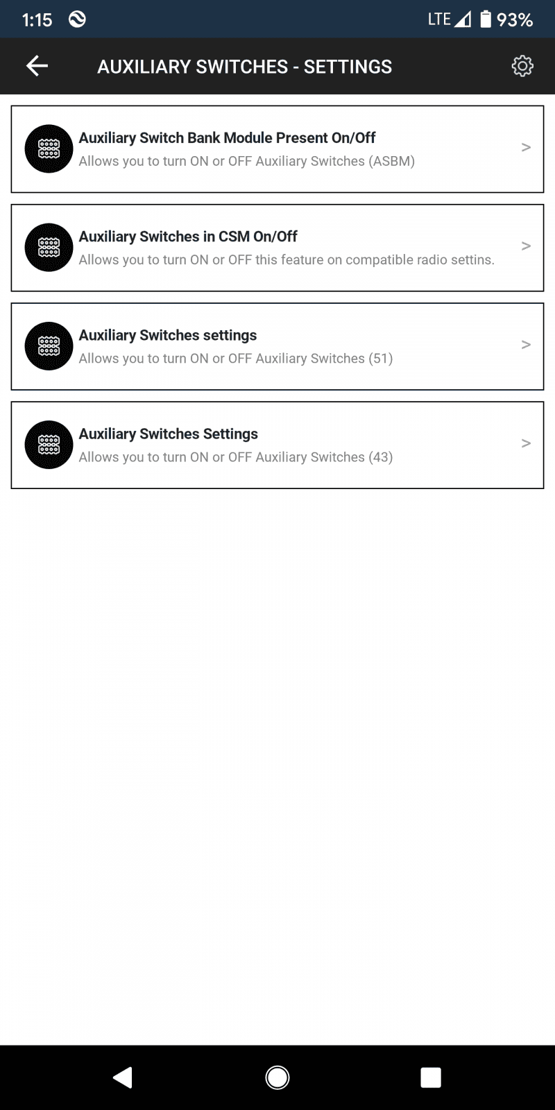

Here is the whole thing for $319. JScan I got can flash everything. What's it cost as a added option?
https://www.quadratec.com/p/mopar/auxiliary-switch-bank-jeep-wrangler-jl
Here is the screen shot from JScan app

Is the harness there to install the aux switches or does everything got to be bought to install them. I have read some say everything is already there and others say not. There are two sets for sale locally to me for $150
You have to run the harness. IMO it's pretty straightforward but that's also coming from a former tech who did electrical 80% of the time. I have the kit sitting next to me and I'm only expecting it to take about an hour.
You will have to pull a pin from a factory connector and build a couple plugs so if you are not at all comfortable with electrical, I highly suggest having someone else do it for you.
edit: I was wrong. Holy shit fuck this harness. Grommet is a tight fit and I can't get in there with my big hands so I'm tearing the dash out and running the harness, some 6awg for an interior fuse block, some 4awg for an inverter, and I'm swapping out the knee speakers for 6.5's and some pods. Also a high probability I'm going to modify the harness on the switches to get rid of the excess I don't need like the interior lines and the run from side to side over the engine.
