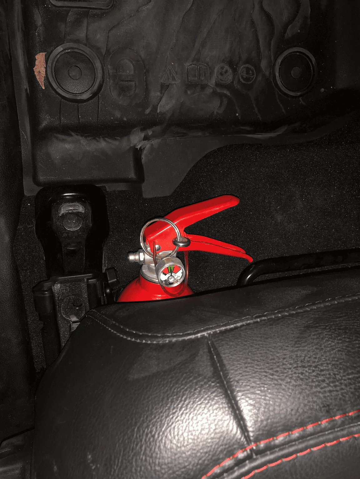

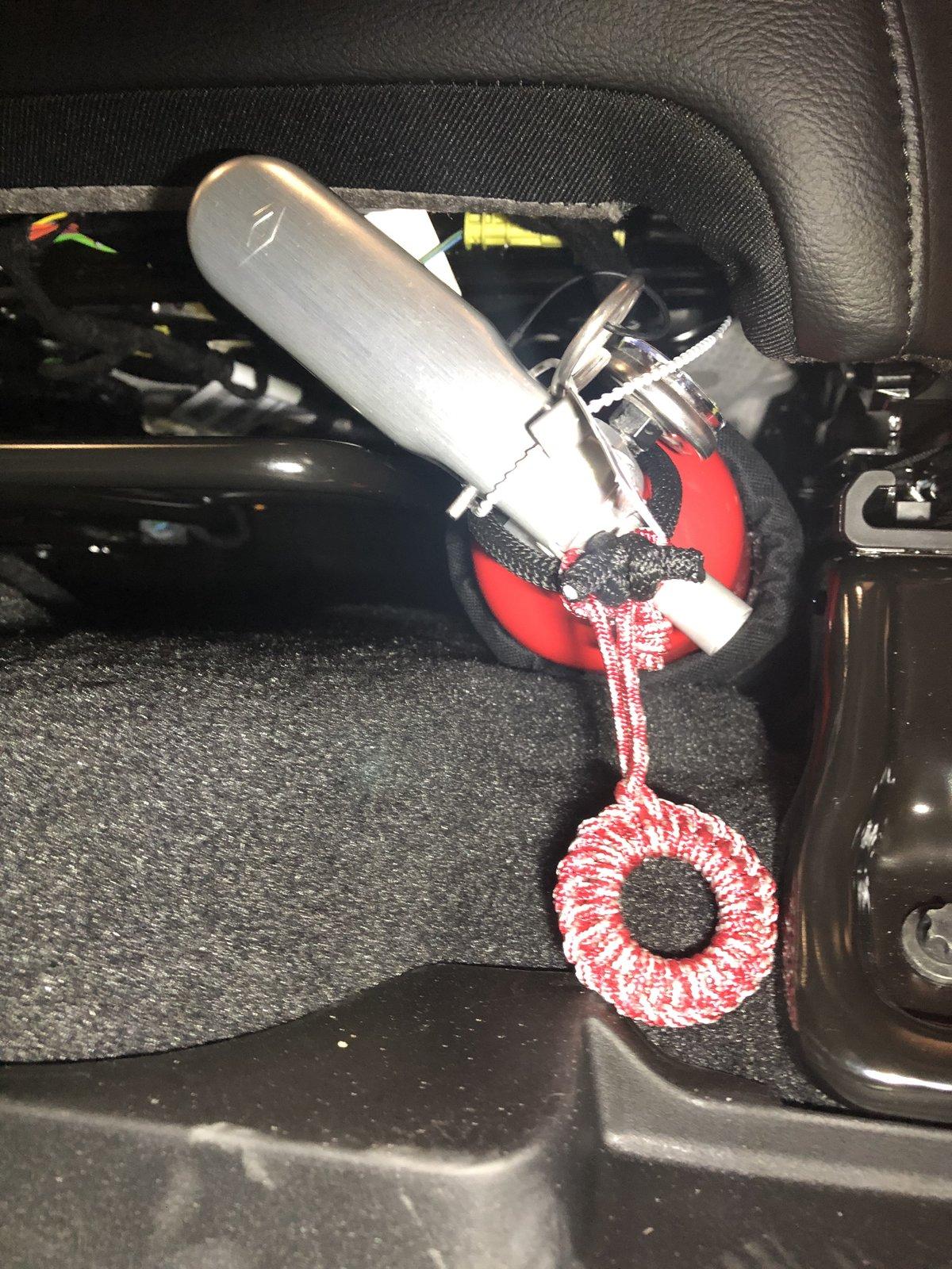

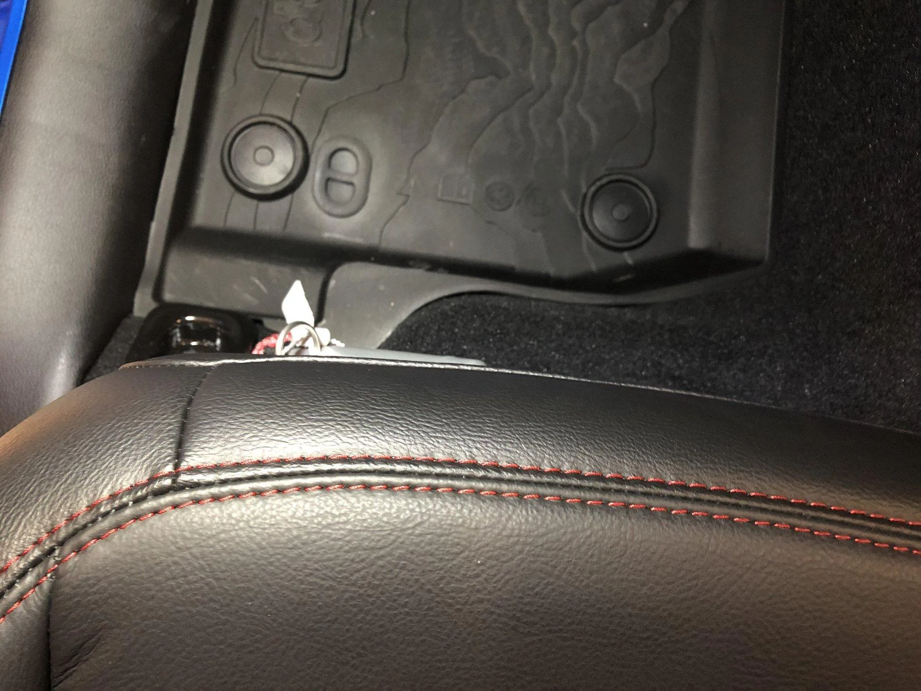

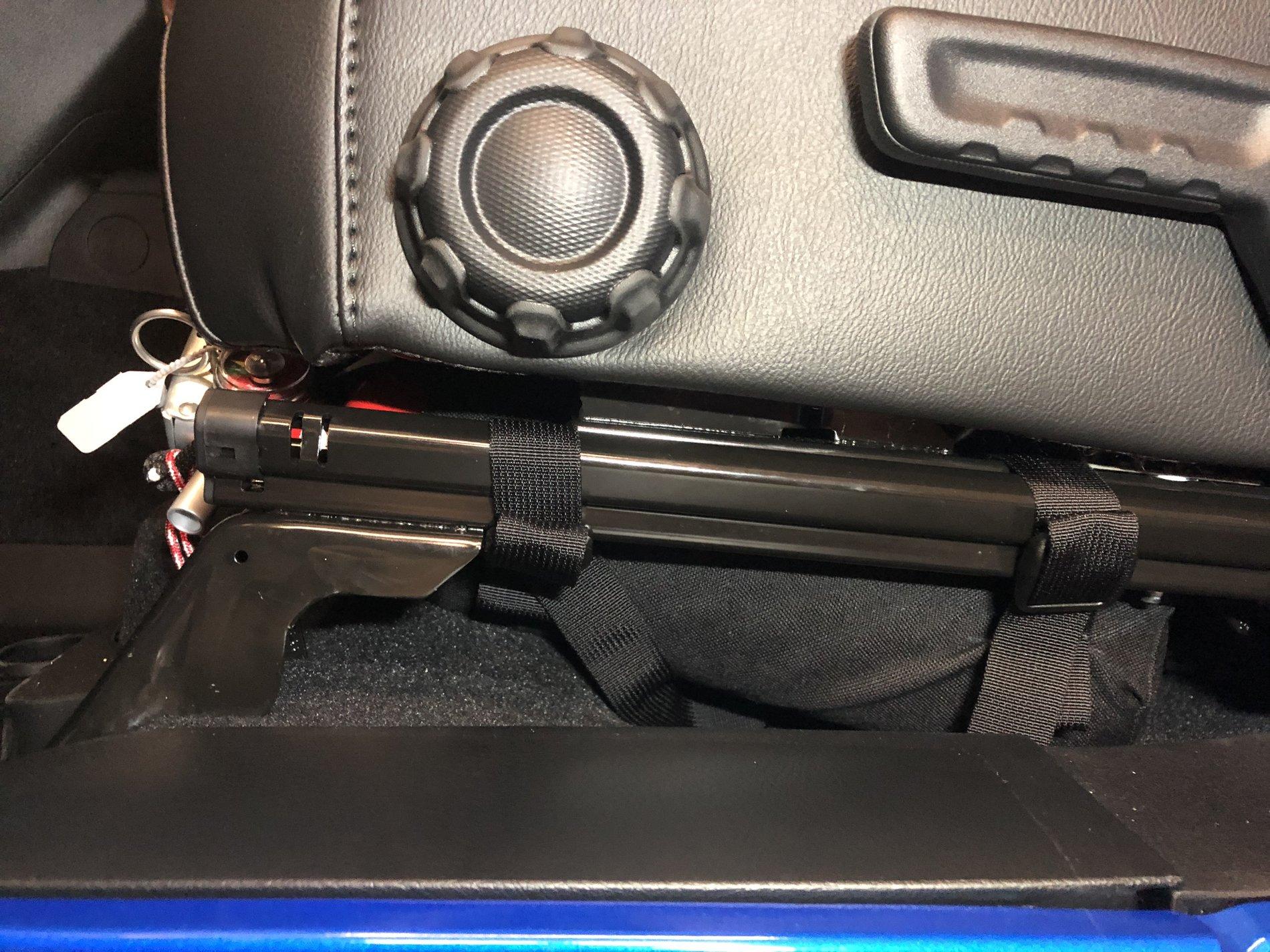

Here is V1.0 after looking through the threads and at various readymade options. My requirement was to have it readily accessible with either hand, as with my IFAK. This is a 2.5# extinguisher in a fuel bottle pouch that I repurposed from my moto kit. I replaced the purse string closure with 1/4" shock cord which also acts as a retention band around the discharge nozzle. To it I added a pull string that I fashioned from a stainless ring with reflective cord ringbolt hitching. I do like that it sits perfectly in this spot, although with a little fore and aft adjustment interference of the driver's seat. My dislike is that it does take a little extra time and finesse to access than the billet quick release mount I had in my JK.

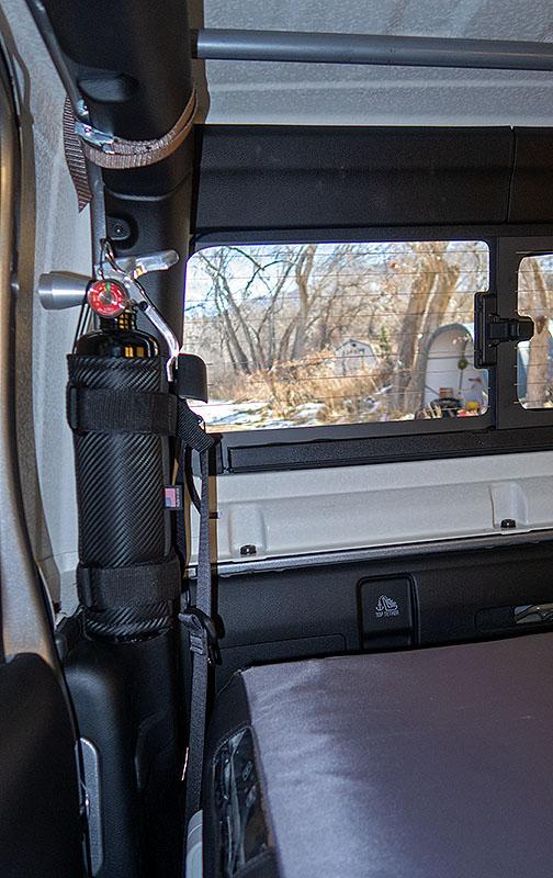

I spent 18 years with a volunteer fire dept. and your point is somewhat correct. But long-term storage in any position in a vibrating vehicle could cause the dry chemical to become compacted. However the extinguisher is mounted, it is a good practice to remove the extinguisher from its mount once or twice a year and shake it up, invert it, etc. I've always kept mine stored upright in vehicles. If you've rolled your Jeep recently, don't worry about de-compacting the extinguisher for a while.
H3R Performance HalGuard MX250B in Warn's Premium Holder (back seat has been removed):
Jeep Gladiator Mounted my Fire Extinguisher! IMG_6494
20+ years as a firefighter and second what he says. When the fire extinguisher company services your extinguishers at work and put new tags on it most of what they’re doing is putting it in something like a paint mixer to un-cake the powder (they also hydrostatically test them every 5 or 10 or whatever years).
my additional thought on extinguishers would be carry 2 and keep them separate. If the cab is on fire you can grab the one in the bed, if the bed is on fire get the one in the cab...

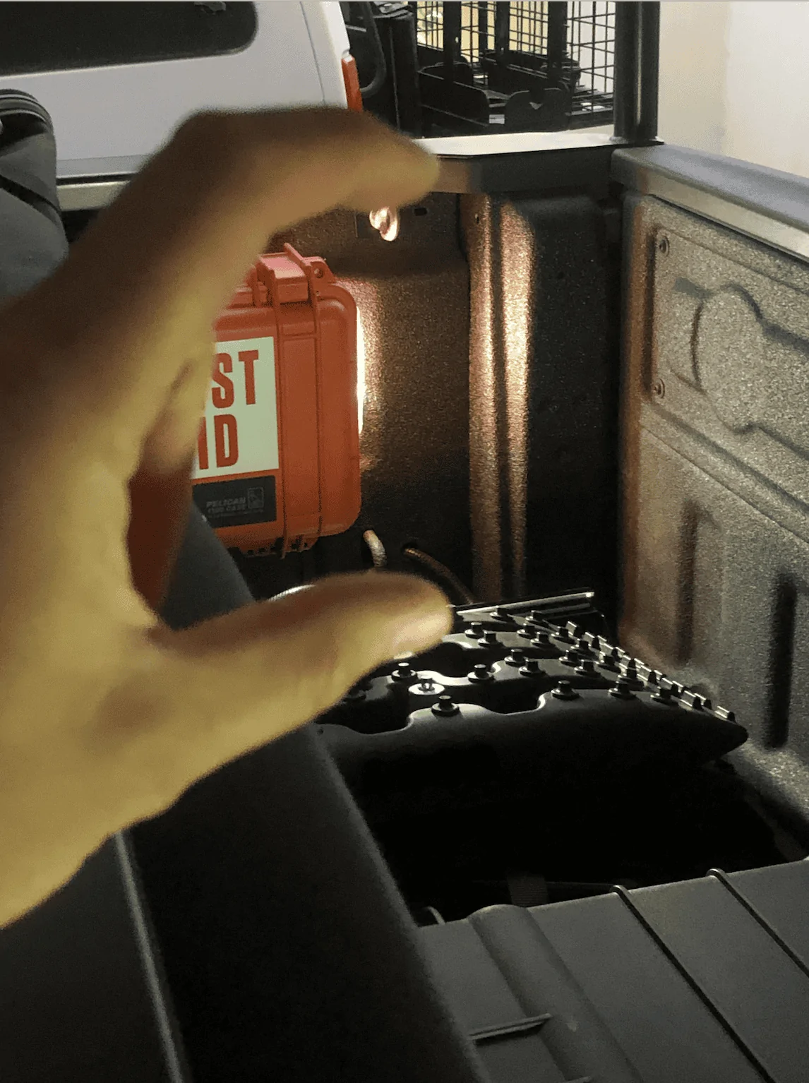

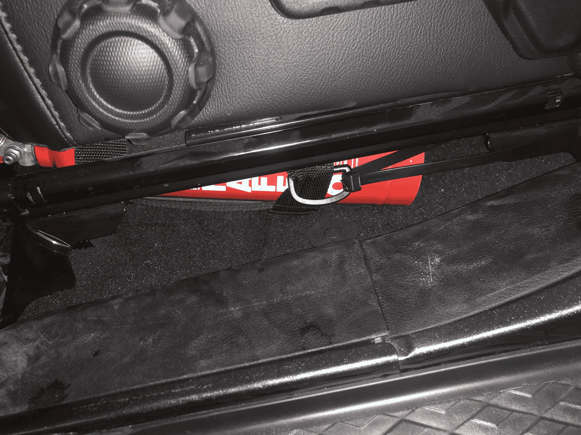

Tried ABNL's under seat mount and it works "ok" with the Atomic Monkey behind the headrest mount...(had a spare)...I'll get a better sleeve and mount it there...I think it is a spare location and practical...even if you lose a couple of second getting out of the truck and using two hands to pull out...

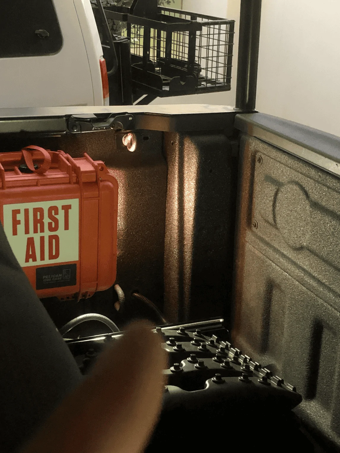

Also will install one standing up in the bed in the location pointed to...just need to get my nutserts installer from my buddy...
With the Atomic Monkey mount, that makes 3 extinguishers...2 in cab, one in bed...

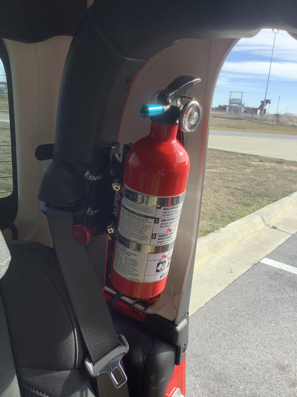

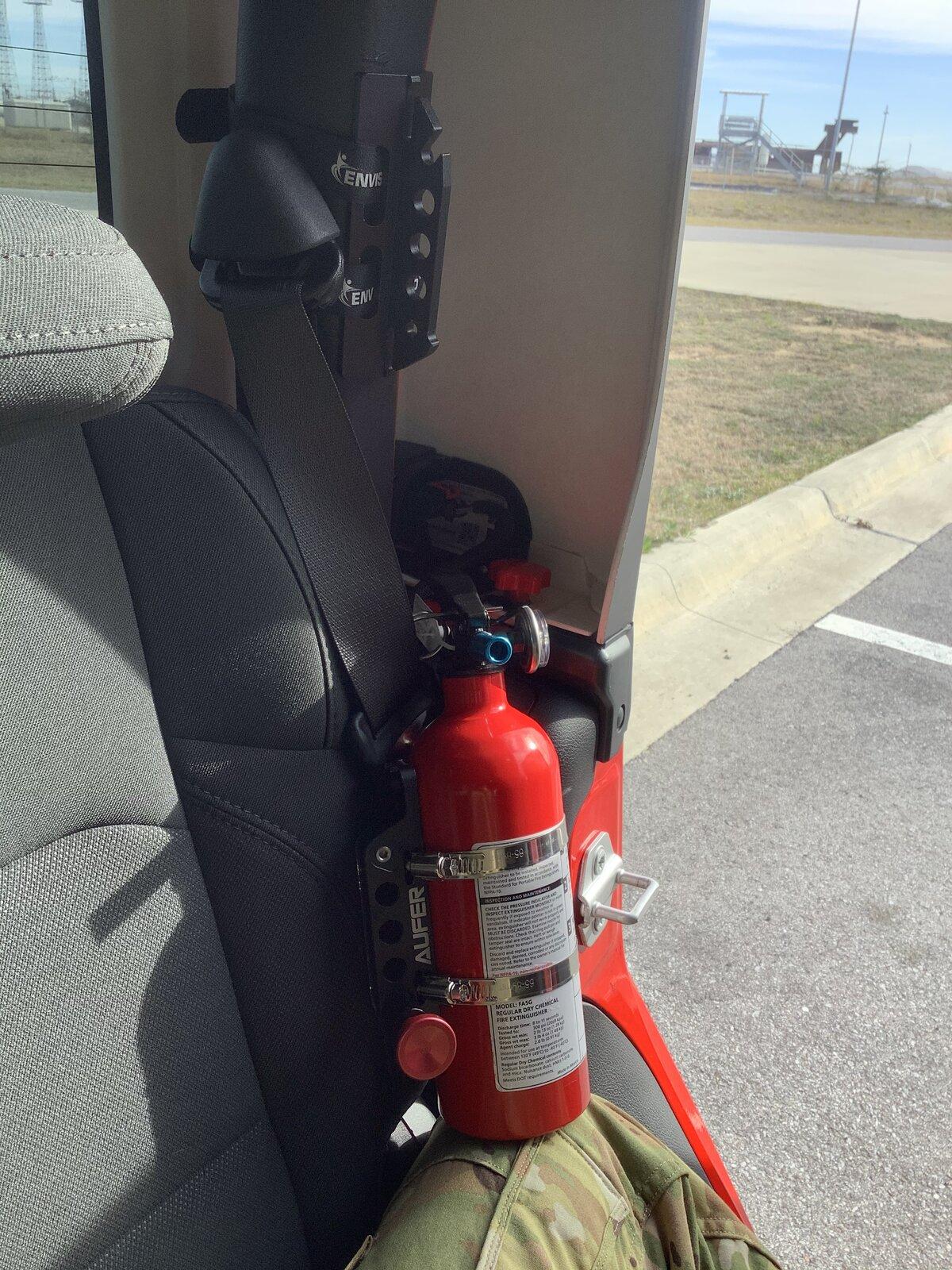

Here’s mine. It’s a quick release style. I like it, even though messing with it and tightening down marred my plastic a little bit. But I feel better knowing I have an extinguisher with me now.
