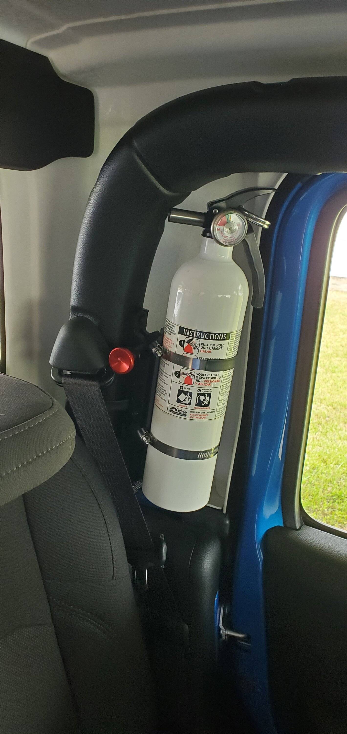

Quick detach mount in my truck. Got it from Amazon. Mounted inside driver rear door to roll bar.

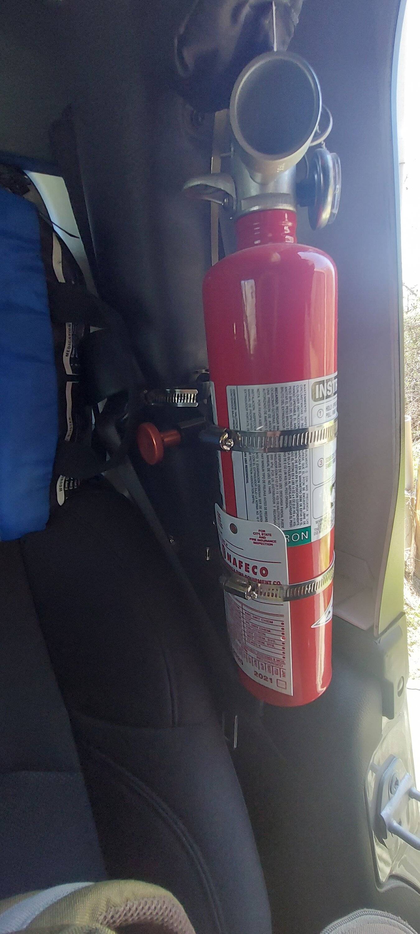

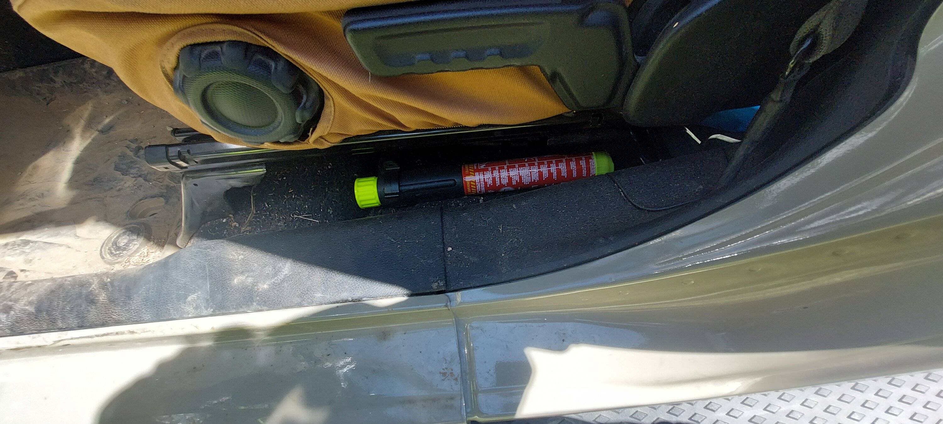

Well I'm of the overkill on fire extinguisher(s) I've got 2 mounted like "Mav4x4Chris" one on each side and 2 of the stick fire extinguisher next to front doors seat area on floor. Almost every time you need a fire extinguisher you need 2. Rightside one is "box store standard" with a Halguard on left side. I'm my experience the more prepared you are the least you need things.

I think most of these are fine. I spent 16 years building and running late model stockcars. I've seen cars roll over and cars stop suddenly, never have I seen a fire bottle get dislodged. My b-i-l's dad went on his roof and slid down the front straightaway on fire. My b-i-l tried knocking the fence down and ended up with a broken fuel pump siphoning the 20 gallons out of the tank which ended up igniting. I've also had a crew guy get in the car to clean it and bump the fire button that the driver forgot to pin.
If someone's in a crash strong enough to dislodge a fire extinguisher with most of these mounts, I don't think it's going to make a difference.
I would trust the aluminum mount & hose clamps over the velcro mounts. Those are a big nope from me.
:like: I didn't use the cheap hose clamps with mine I bought good quality ones. I've had the "pleasure" of being in vehicles rolling over and though vehicle roll over trainer's. After any of those things you normally strap down every thing. Being in a few M113s and 36 ton APC that flips or gets nosed at speed sucks let alone a aircraft. I've had a few of them
