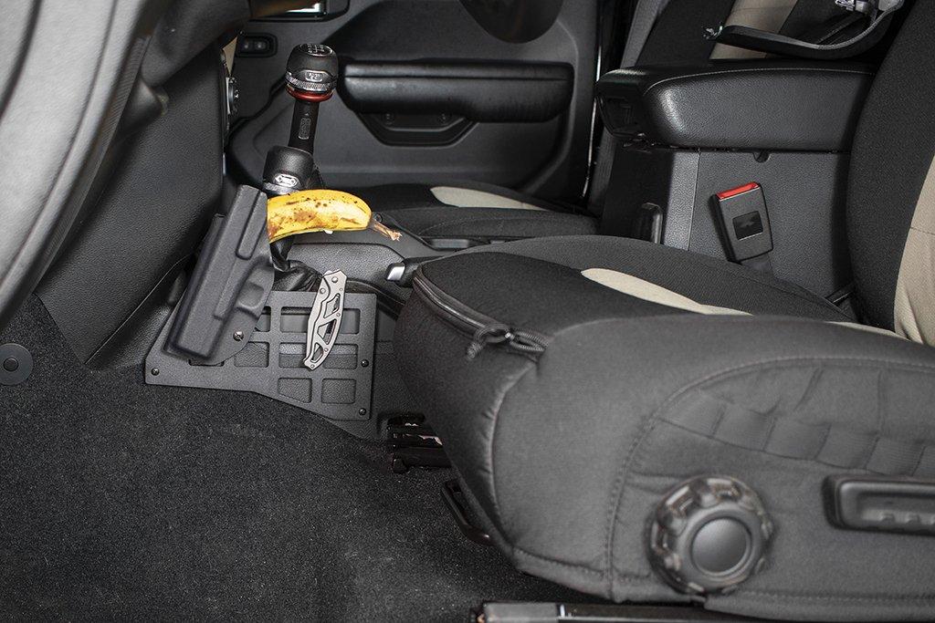

I like the banana holder. Where can I get it.

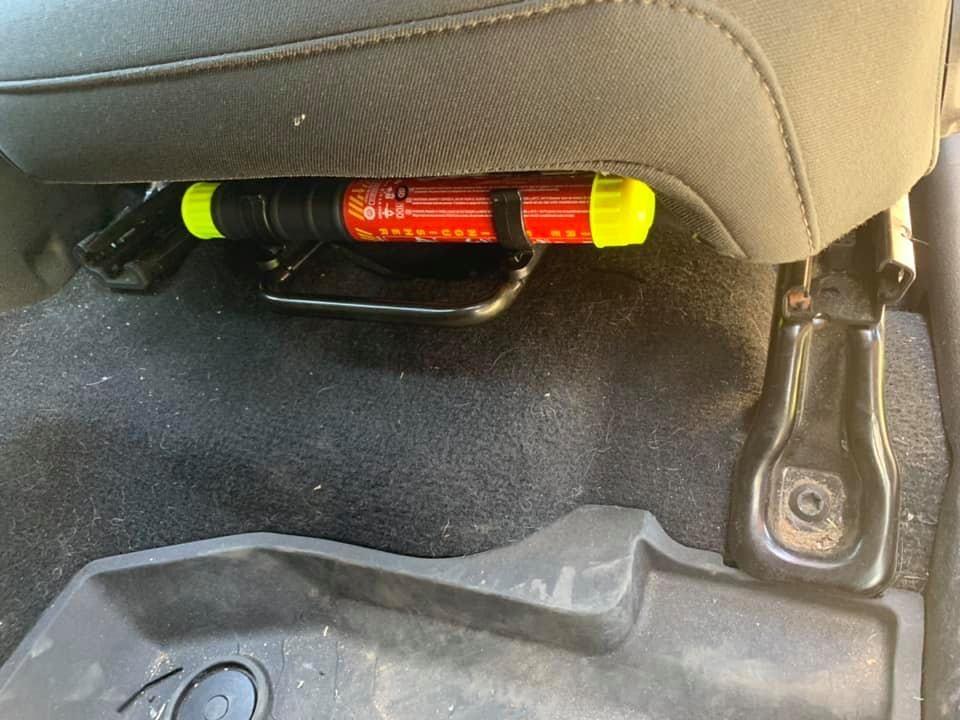

I’ve got an Element secured to my drivers seat. Instead of the magnet, I took two of the plastic clips they sell and secured them to the seat adjustment bar with zip ties. It’s very secure and easy to get to.
Great idea! Any interference with the operation of the seat? Any interference removing it from the clips - look like you have to lift up or are they flexible enough to pull straight out?

Optimally, holding the bar down while pulling up on the extinguisher is the best way to get it out. However, those clips have enough give that you can pull it forward to free it with one hand.

Thanks. With the 10% off coupon, I decided to order one for each of my vehicles with an extra clip each to have them mounted under the driver's seat. I appreciate the picture and feedback.
