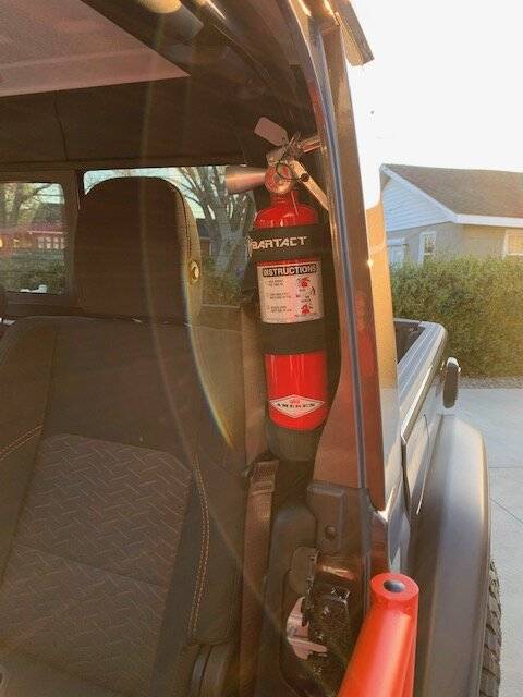

I can assure you, 3 - 1 1/2" industrial velcro straps will hold a fire extinguisher.
I'm not sure I'm buying that.
How is the velcro secured to the vehicle? With a screw and a washer under the head?
What kind of screws?
And if the passengers head slammed into the bottle.
Sorry. For the cost of an extinguisher, just mount it in the bed and if someone steals it, you buy another one.

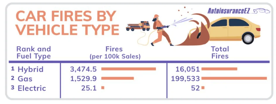

More than 80% of fires are in passenger vehicles.
The National Fire Protection Agency estimates that 33 cars catch on fire every hour in the United States alone.
One source says over 100,000 passenger cars catch fire every year in the U.S.
About 1/5 are caused by electrical malfunction. My F250 had a recall because the brake light switch could get hot and start a fire. But only a fraction are caused by defects.
Overheated engines, overheated converters (think of how hot those get normally anyway)
The fire in our own car could have been a total disaster if a quick thinking and observant person hadn't seen it.
I agree it's not common, but not uncommon either.
Considering something in the neighborhood of 110,000 auto fires a year - experts do recommend an extinguisher.
Dunno the date on this or any other details at all - the causes or what, but it's sort of interesting.
They say most hybrids catch fire when parked and NOT plugged in.
You are not buying something you don't understand........oh OK! Screws and washers?? There are no screws and washers!! The Bartact nylon mount has 3 nylon straps that wrap around the roll bar and then 3 around the extinguisher. They all are secured with Velcro. No screws or washers!
Everything has trade offs! I have had someone in the back seat only a few times. It would be a concern if I had adults in the backseat all the time. I weighed things out and chose to put my extinguisher in the cab, you can choose where to stick yours.
Brother, let it go. I tried using reason and it was not accepted. The reality is that your three velcro straps (which are likely sewn onto nylon webbing) have a breaking strength of between 300 and 5000 lbs force, depending on the strap's width (1/2" is around 440...oh yeah...three of them).
A 5lb object moving at 65mph exerts a force of 325 lbs. As long as the straps are in good shape and not torn or age worn, you'll be just fine. At least that's what the physics and math say. Opinions...well, are opinions.
Personally, I have a rear seat delete so I have no worry about rear seat passengers banging their heads into it and it sounds like you have that consideration, uh, considered (lol).
Rock on man.
