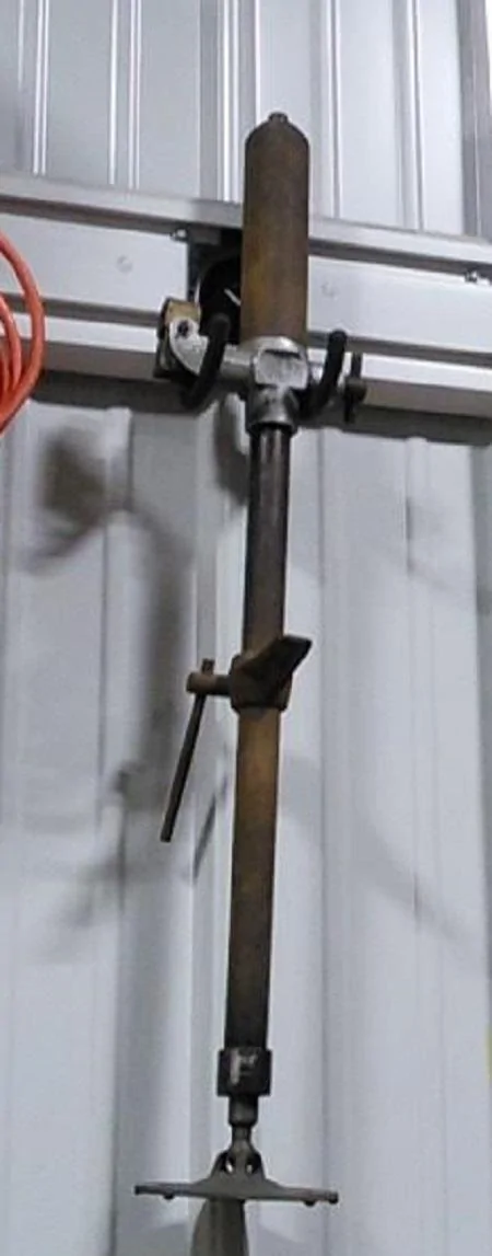

Here is a light-weight hydraulic jack and should do what you want......... and it's very adjustable. But it won't lift as high as the farm handy-man jack will.
But it's a fraction of the weight - I can lift it off the wall with one hand - can't do that any more with my handy-man jack.
My boss from the old AMC dealership shop I worked in gave this to me when he was forced to retire (along with most of the Kent-Moore/AMC tools he still had left from those days)
I don't know where he got it, how long he had it, etc. - but was thinking of restoring it and either keeping it for display - or rigging it in the JT somehow.

Geez that needs to be in a museum

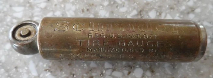

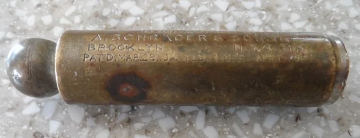

Here's something every Jeep owner needs to carry with them..........

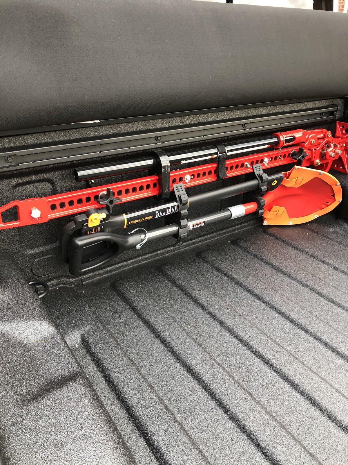

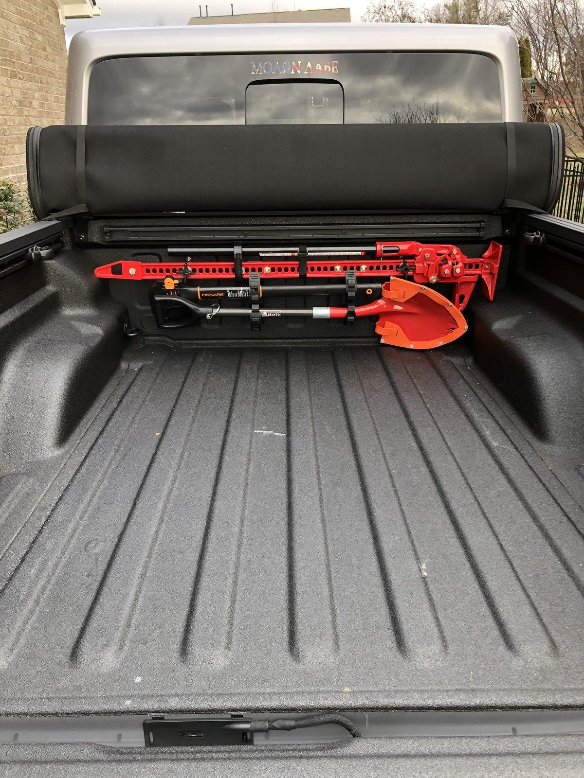

Mounted Hi-lift Jack, Fiskar Axe and Krazy Beaver Shovel to bed with EAG hood jack mount and Dominion Off Road axe and shovel bracket. Mounted hood brackets with rivet nuts to the bed.
LOOKS great!

I REALLY like that solution. It's not only practical and keeps stuff out of the way when they aren't needed - but it looks sharp as heck, too.

How'd you mount the axe and shovel to the bed front - what hardware did you use to mount to the bed wall and also to hold the axe and shovel?

I used EAG hood mounts to mount the lift to the bed wall. Mounting them vertically instead of horizontally. Drilled 4 holes in the wall and utilized rivet nuts. Measured it 6 times and drilled once.
The axe and shovel are not mounted to the bed wall. They are attached to the lift using Dominion Offroad’s mount. The D O mount is originally intended for a JL roll bar mount. I have it on my JLUR. Same concept as originally intended with a twist. it’s a Frankenstein configuration but it works.

Thanks for explaining - looks great.
I personally refuse to use Rivnuts. Just say no to Rivnuts :headbang:

It was a first time for me with the rivet nuts. Watched a few YouTube videos. Gave it a shot and it turned out perfect. Bolts with nuts could probably be used but the space between the back of the cab and the bed wall is tight. McGiver it and I’m sure there’s a way to get it done. I was considering coat hanger wire and duct tape to thread a bolt and lock washer through the bed wall from the cab side. Rivet Nut sounded better.

And people wonder why I keep old hangers, duct tape - in fact all sorts of different tape, and other stuff out in my shop.
If I was going with bolts and nuts, I'd use serrated flange nuts so once they started to catch, you'd not need a wrench on the back side.

Exactly! The hard part is feeding the bolt through the hole.
