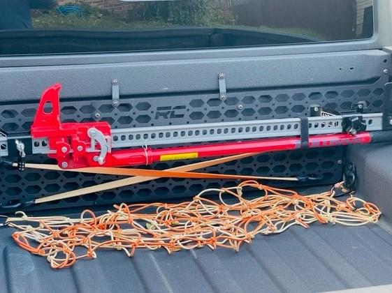

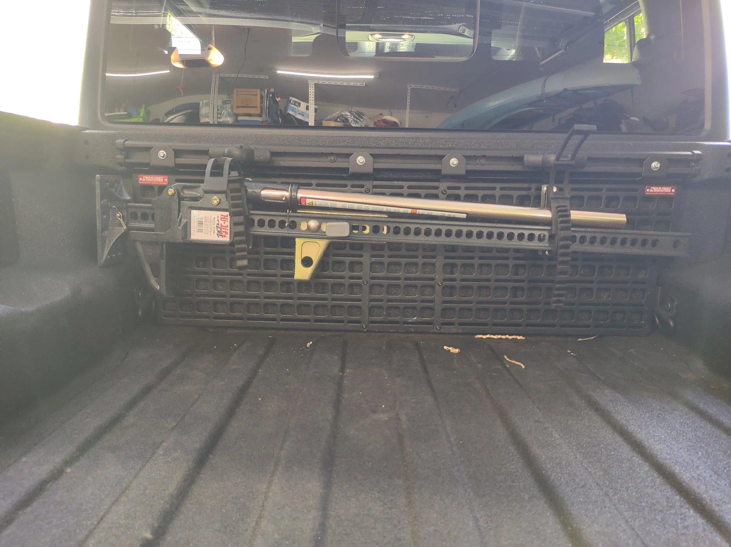

I’ve been stuck for 3 hours with my son because no one had a hilift. First thing I bought before going out on the trail again.
A 48” with the bed side mounting bracket on unistrut works great and is easy to access.

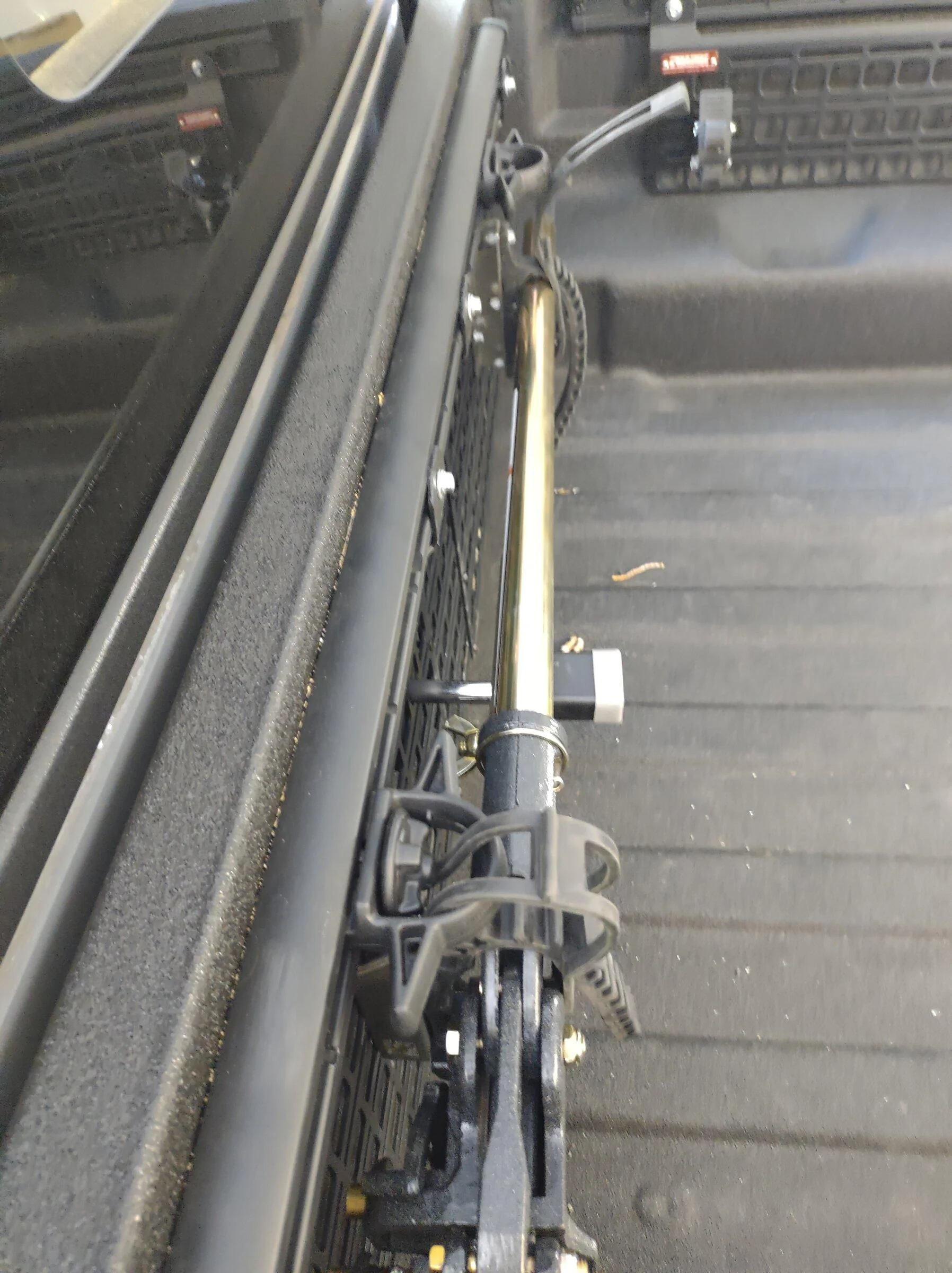

Another mounting option

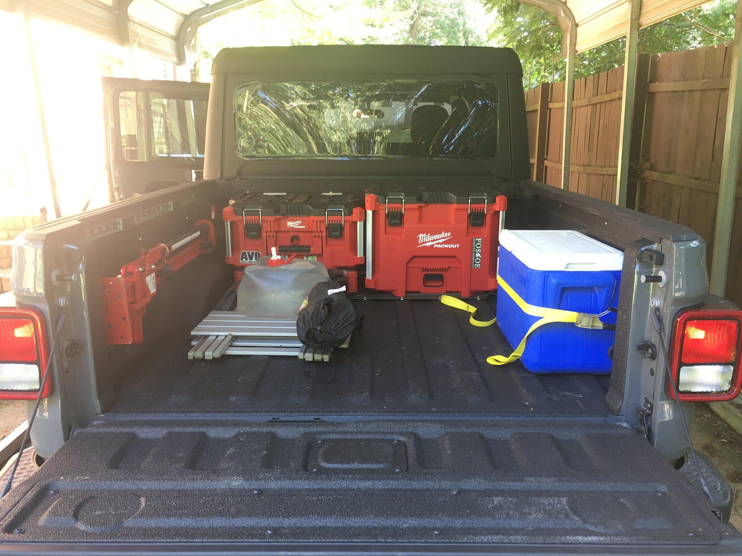

I had gone with the 60 extreme, because I had room for it (cause you know, FJ stuff)... I've used it for countless odds and ends at work, but only once or twice to change a tire, and once to winch with.
Being the extreme, it has that chain plate thing, which I've always kept on the end as a smooth/round termination for the I-beam. Spoiler alert, when I took it off the FJ and tossed it in the Jeep's bed to go to work, its so long it has to ride diagonally, wrecking bed space for everything else. Even removing the chain plate just brought it down to a "Barely" fit, due to the foot.
I vote 60" and chop it to an application specific length, for wherever you mount it.
You'll like the extra stroke if you do ever wind up winching with it.
Just a thought, if you want it in the bed where one would expect it to ride.
