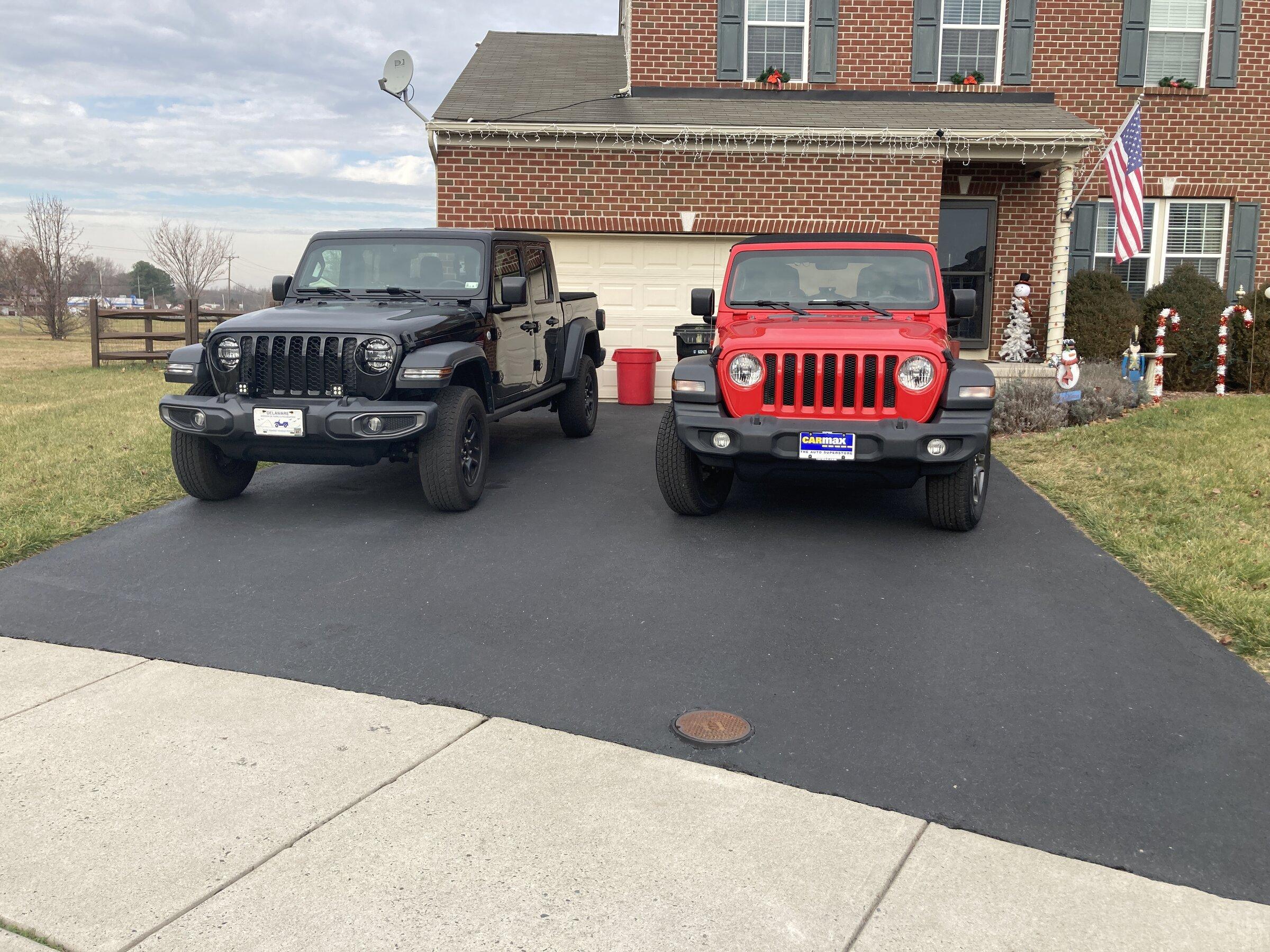

With lift and tires
Jeep Gladiator MPG Experiment A5A137B4-4CC8-45EF-8E4A-388FEAA15F73
next to a stock height JL
Jeep Gladiator MPG Experiment 7480262D-8A9B-41E4-8FF4-A5084C89366E

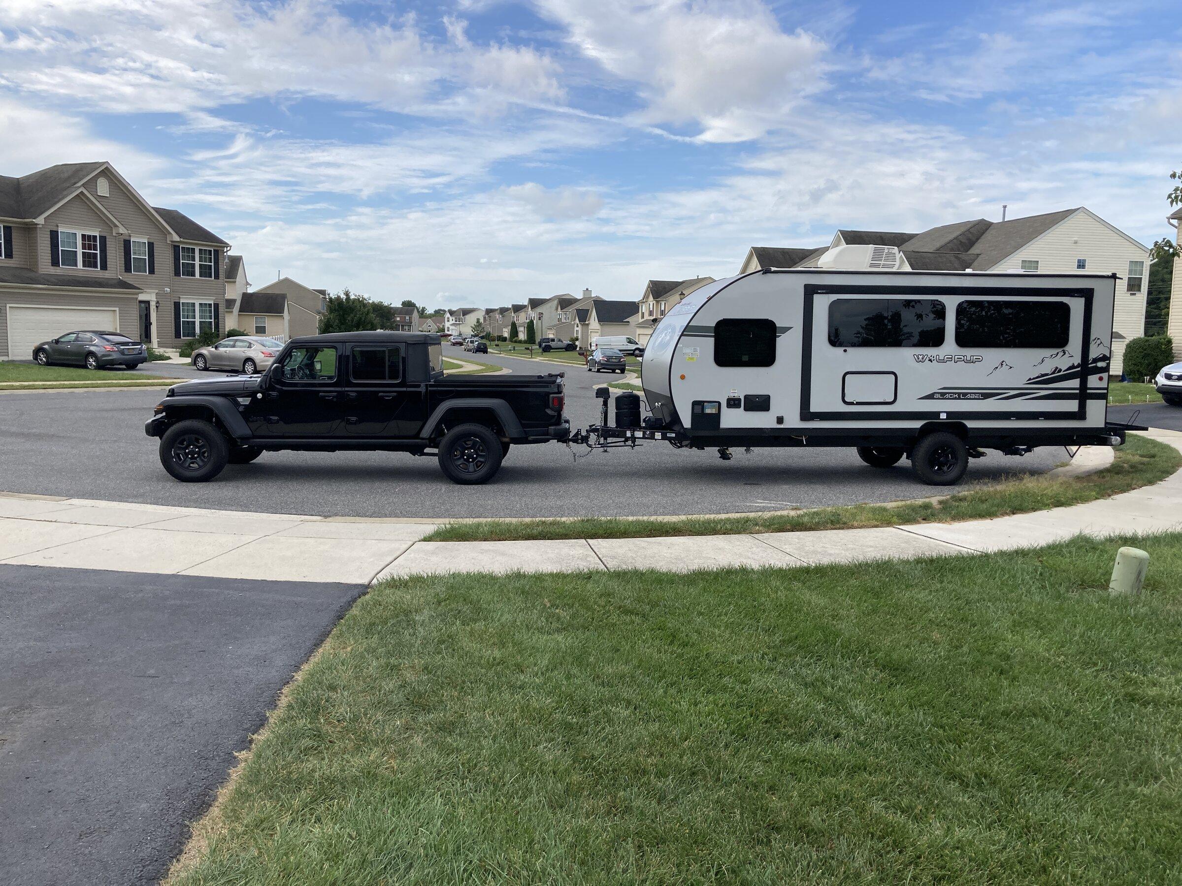

With my TT tagging along for a ride
-airbags inflated in the rear
Jeep Gladiator MPG Experiment AE0FA53E-E8ED-4E62-8D7D-009FE3269706

With lift and tires

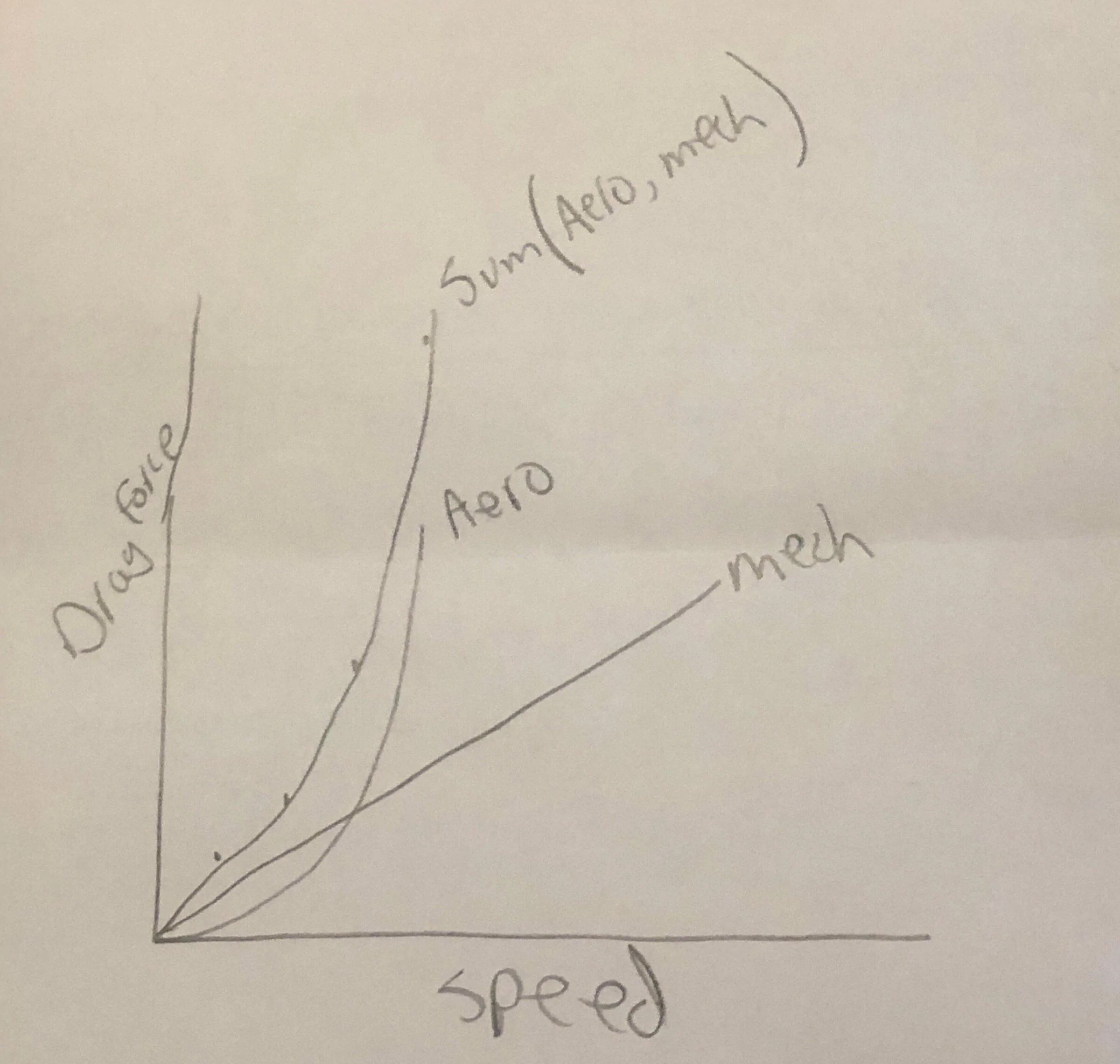

To the OP.
Google "coast down test". Basically you get the truck up to a certain speed on a certain road and shift into neutral at a certain speed.
If you are a 1990s car magazine the accelerometers you mount in the car or the "5th wheel" help you determine actual HP used at each speed. But if you are just a regular guy with no test equipment, you can see how much farther you coast on this same road/same speed/same gas load/same tire pressure.

To the OP.

Exactly. One interesting thing is that aerodynamic drag forces change as a square function, whereas mechanical drag, including tire drag changes as a linear function.
If you get really fancy you can calculate the mechanical drag vs aerodynamic drag by tracking the rate at which the speed changes.
i.e. speed change is much greater at higher speeds because aerodynamic drag is a greater percentage of total drag.

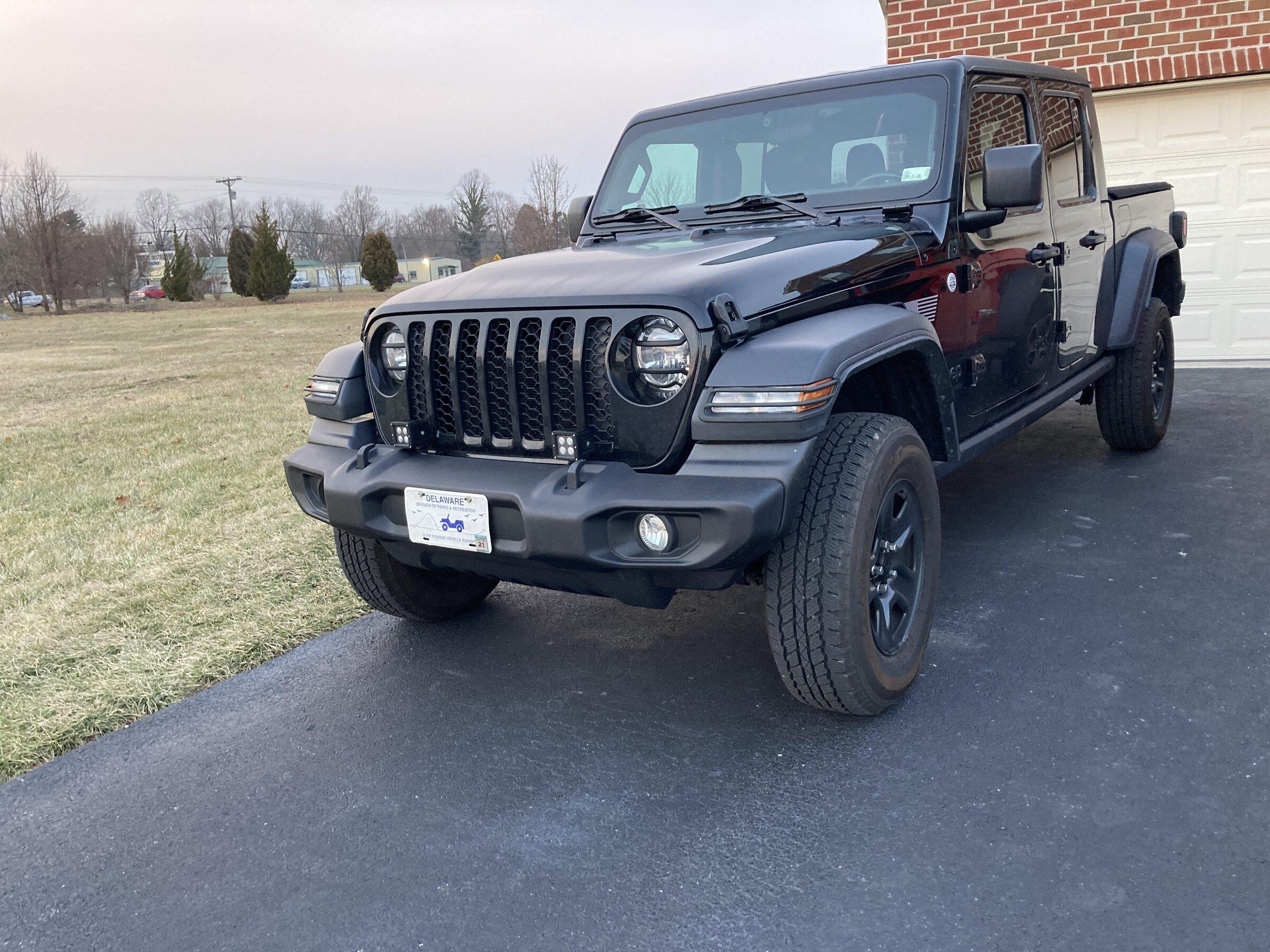

Day 2
trip 1
22.9mpg
-notably colder this morning. Day 1 AM temp was 29d, today it was 21d. Not sure if that is a contributing factor or not. but there are no other changes Im aware of that would change the trip 1 average so much from day 1. Time will tell.
-anecdotal finding relating to shifting on an incline (now going to call this AF2) was not repeated today. The JT down shifted into 7th IAO the same place it typically would.
-anecdotal finding relating steering inputs (now going to call this AF1) seemed consistent with day 1. Fewer small steering inputs were needed during normal driving conditions.
I haven't read the study yet so forgive me if this is in there.
Why does mechanical drag increase at a linear rate? Wouldn't it either decrease as speed increases since the tires are now rolling and have a "fixed" resistance at a fixed speed with consistent road conditions? I could even see it remaining a constant as the mechanical components aren't changing? I see how some would heat up, or shift a bit, which could change the drag I guess.
Mechanical drag is linear if you ignore things like component temperature. It is essentially a fix "drag" on the mechanical system that makes it linear. Double the speed only doubles the mechanical drag. Kinda hard to explain.
Aero is exponential. If you double the speed it takes 4 times the energy so it goes up really fast.
Try using your scan tool to monitor % engine load. You will see the load goes up really fast when you go from 30 to 60mph which is MOSTLY wind drag. It could be a helpful tool to document with.
interesting, thanks.
would it maybe plateu at some point? Using tires as an example..tires can only create so much resistance. At higher speeds they would almost create less resistance as the centrifugal force would cause the tire to become more narrow, and decrease its contact with the surface...decreasing its resistance. Am I way off here? I know this is down a rabbit hole, but I like this stuff.
I will plug that scanner in during the second trip today and keep an eye on engine load.
No, resistance continues to go up as speed increases. Forever.
So at very high speeds the aerodynamic drag becomes an even larger percent of total drag.
If you look at my hand drawn graph you can see that at low speeds mechanical drag is higher. At a certain speed the graphs cross and from that point aerodynamic drag is the dominant drag component.
