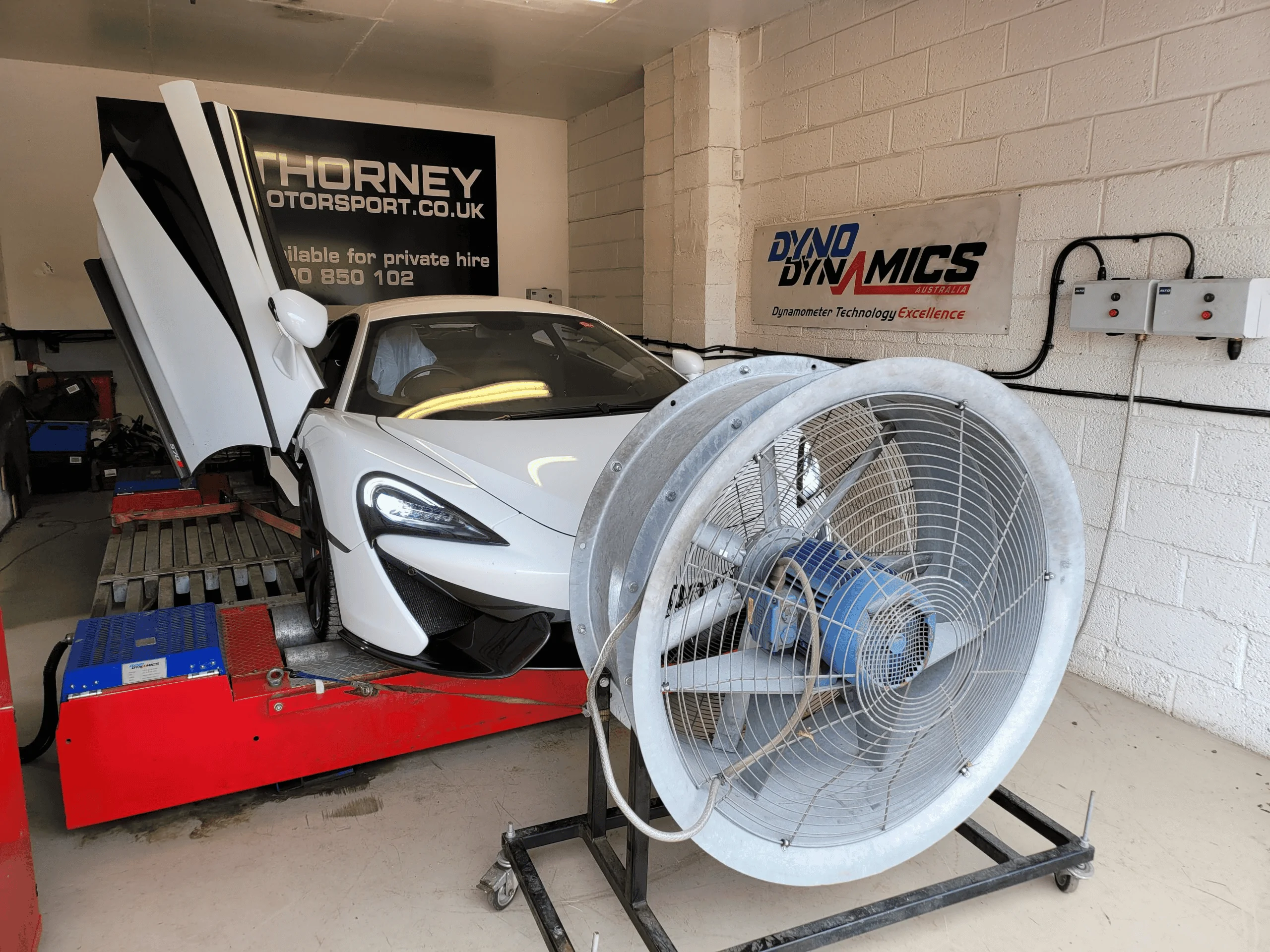

Blower fans. We used to do it all the time, especially for air-cooled motorcycles.
That's about the only way - blow 65 mph into the front of the truck.
Since these don't run hot in normal driving, You'd have to emulate the load of towing in a headwind.
There won't be any benefit to cooling one of these on a normal highway drive. So you need the wind, the load of towing. You'd need to make a stock system run hotter than normal, swap grills, and make another run.
We're not trying to find if these will cool better on the highway because there's no problem on the highway. It would require loading the engine about the same way a headwind while towing would load it

You can add resistance to a dyno to increase stress on the engine. It’s all there, everything you need to do controlled tests. It’s one of the reasons why they exist, not just to pump out hp and tq numbers.
If you’re willing to fund a dyno rental im in for it haha aftet the $450ish for the grille, paint to make the grille bearable to look at while testing, the $200ish ill be spending for the pressure testing equipment, and the time, im in this for a good bit already!

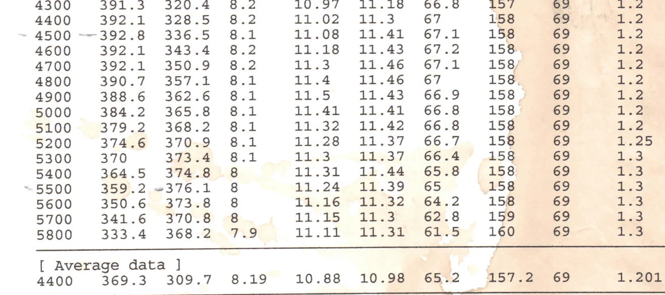

Right - and it doesn't take much to figure out what sort of output is needed to match towing. (or just max it out) JSCAN and others will show torque.
Yeah, have the dyno sheets on my car after all of these years............ not great compared to the HP and torque from today's engines, but really good considering it's more than 1 HP/cid
