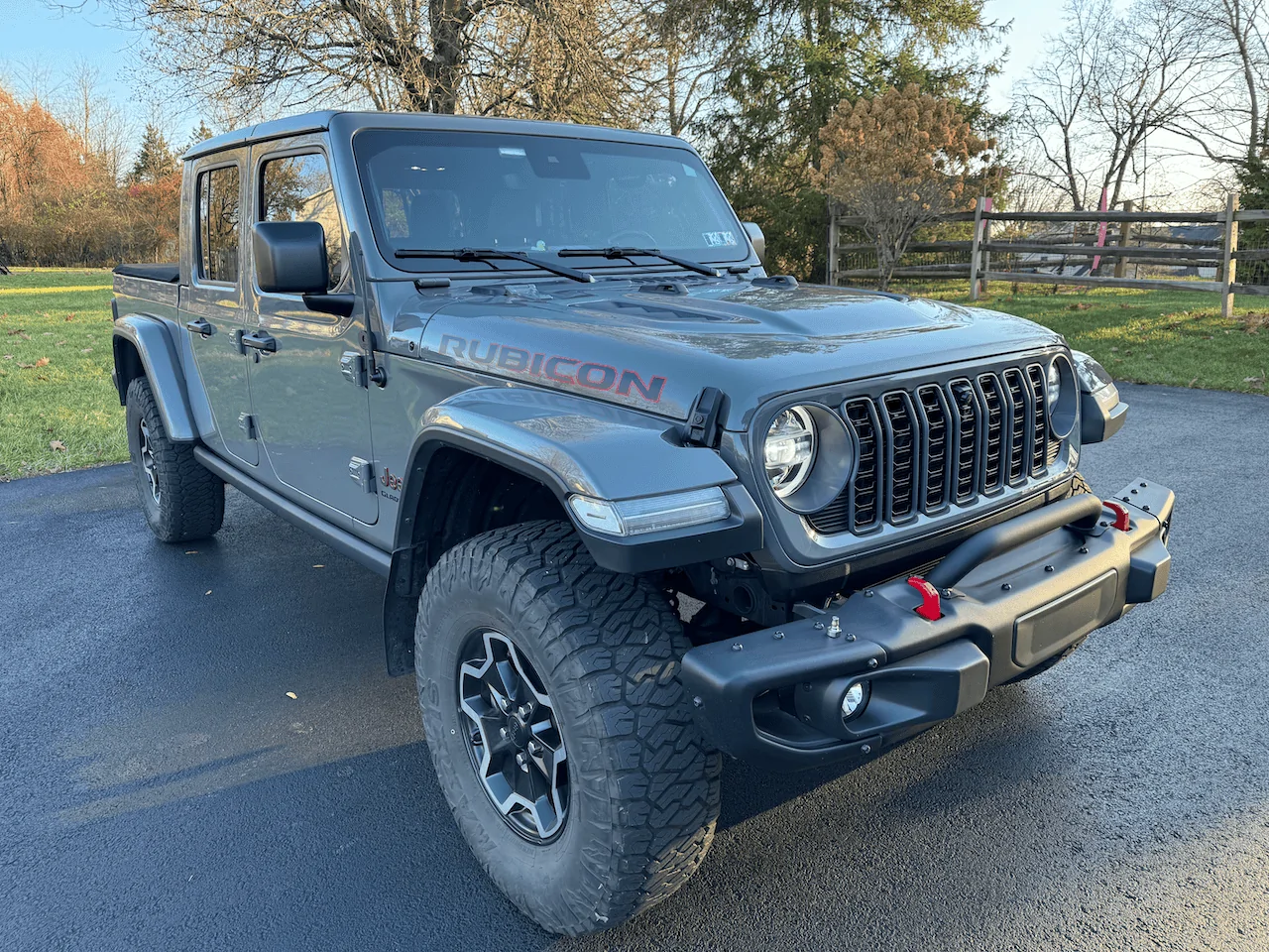

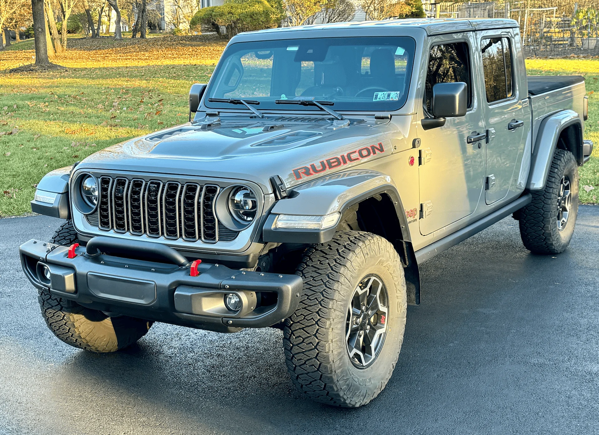

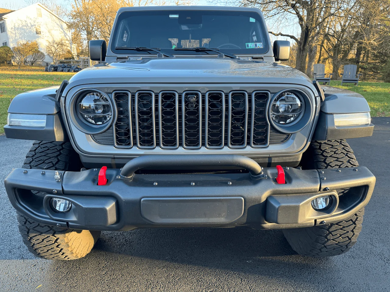

As promised, the 2024 grille in SG. Now I need to 1. figure out how to secure the front cam wiring (not the same clamp or clamp placement as the old grille) and 2. remove the cam wash nozzle from the old grille and install it on the 24.
Neat! Im still waiting for mine to continue the experiment

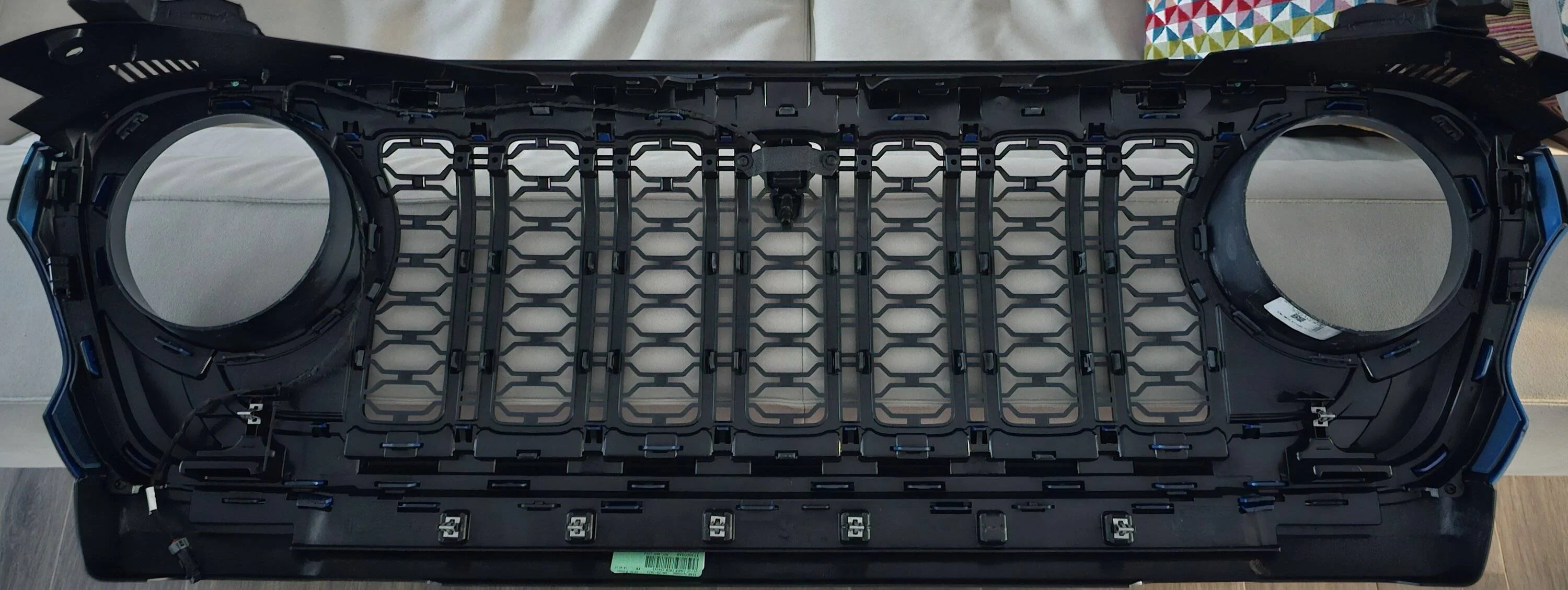

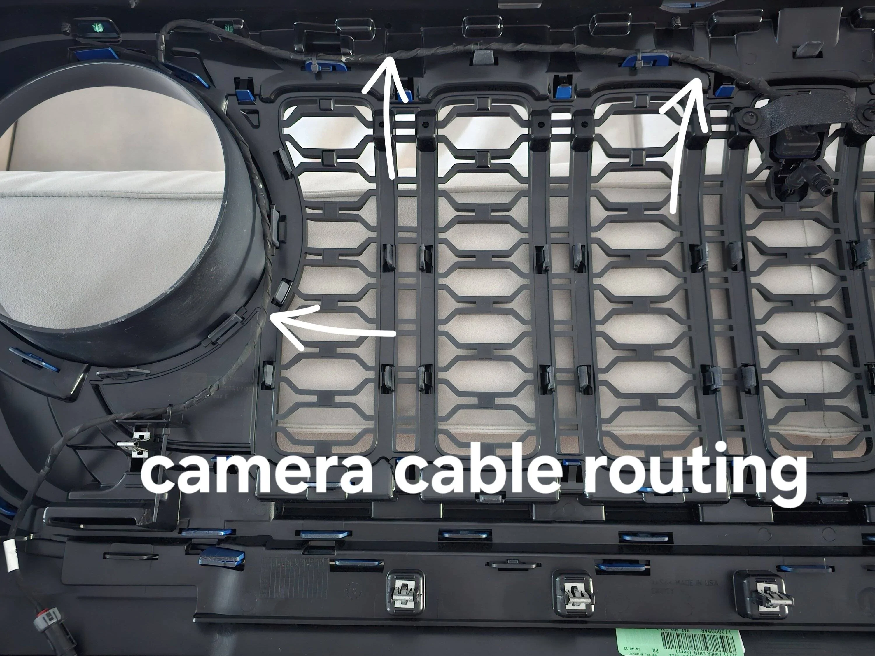

So I finally received my '24 grill from @AllMoparParts.com early this week (3 months wait time). Unfortunately there was a 3" crack on the top, passenger side of the large black base, plus one of the lower mounting tabs into which the metal clips are fitted was also broken off. Because All Mopar Parts could not estimate the time for replacement of the broken part other than "at least 3 weeks or more" I decided to repair it as best as I could with plastic welding techniques (took an extra hour of work but turned out OK).
All Mopar Parts said they would process a partial refund for the broken part but have yet to determine the amount. Let's wait and hope it's considerable.
Now, I've not seen any posts as to the actual grill swap and exactly what's involved, so here's my take on it.
Got the body colored surround pieces (4) painted at a shop, and I painted the slot trim/ headlight bezels in dark gray.

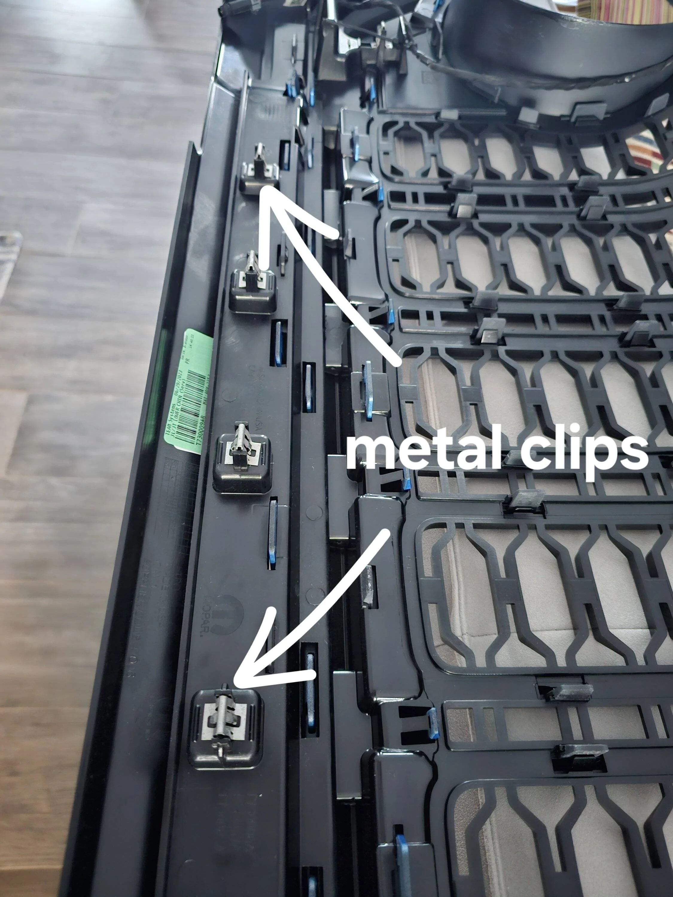

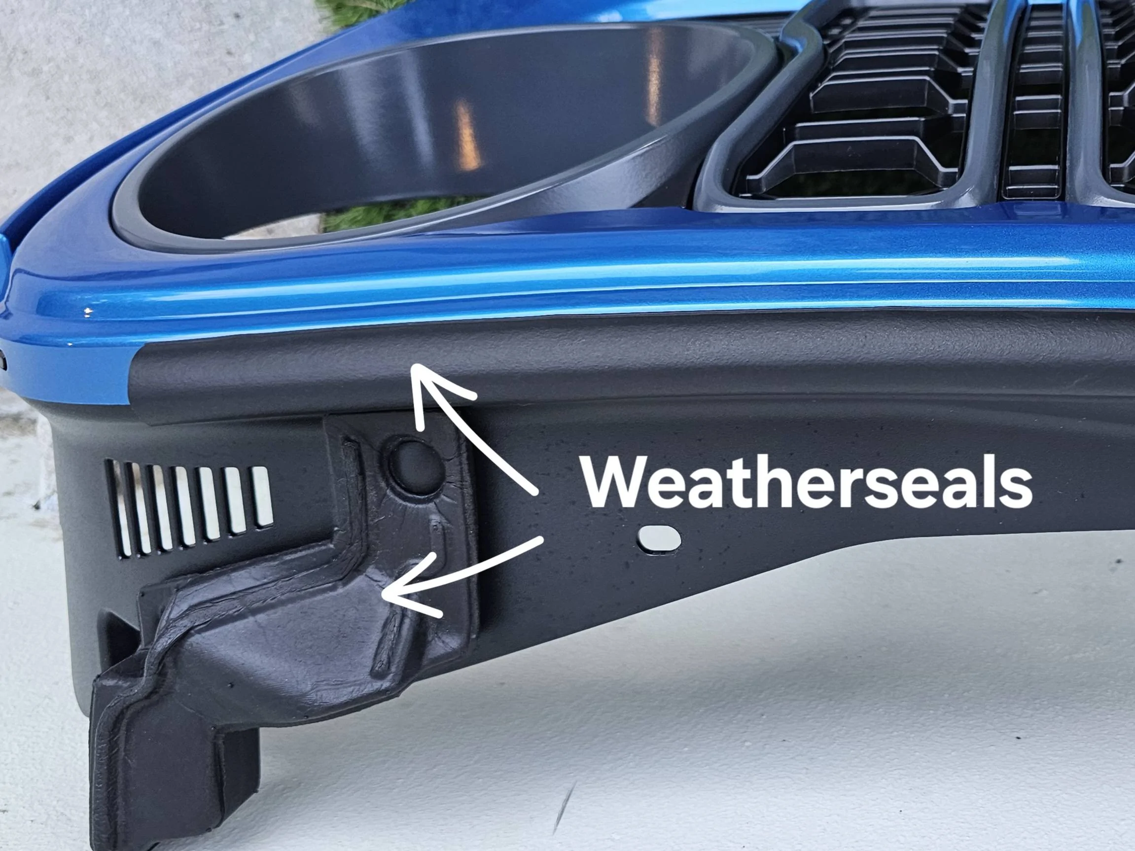

All the parts for the new grill snapped into place quite precisely. To complete the job you will need 8 new plastic rivets (and gun to install them) along the top edge, two self tapping screws on each of the inside lower corners, transfer and re-use 6 metal clips along the bottom, swap over the weatherstripping along the top edge (fitted with Xmas tree plugs) and the foam rubber seals on both top corners (fitted with Xmas tree plugs and contact glue).

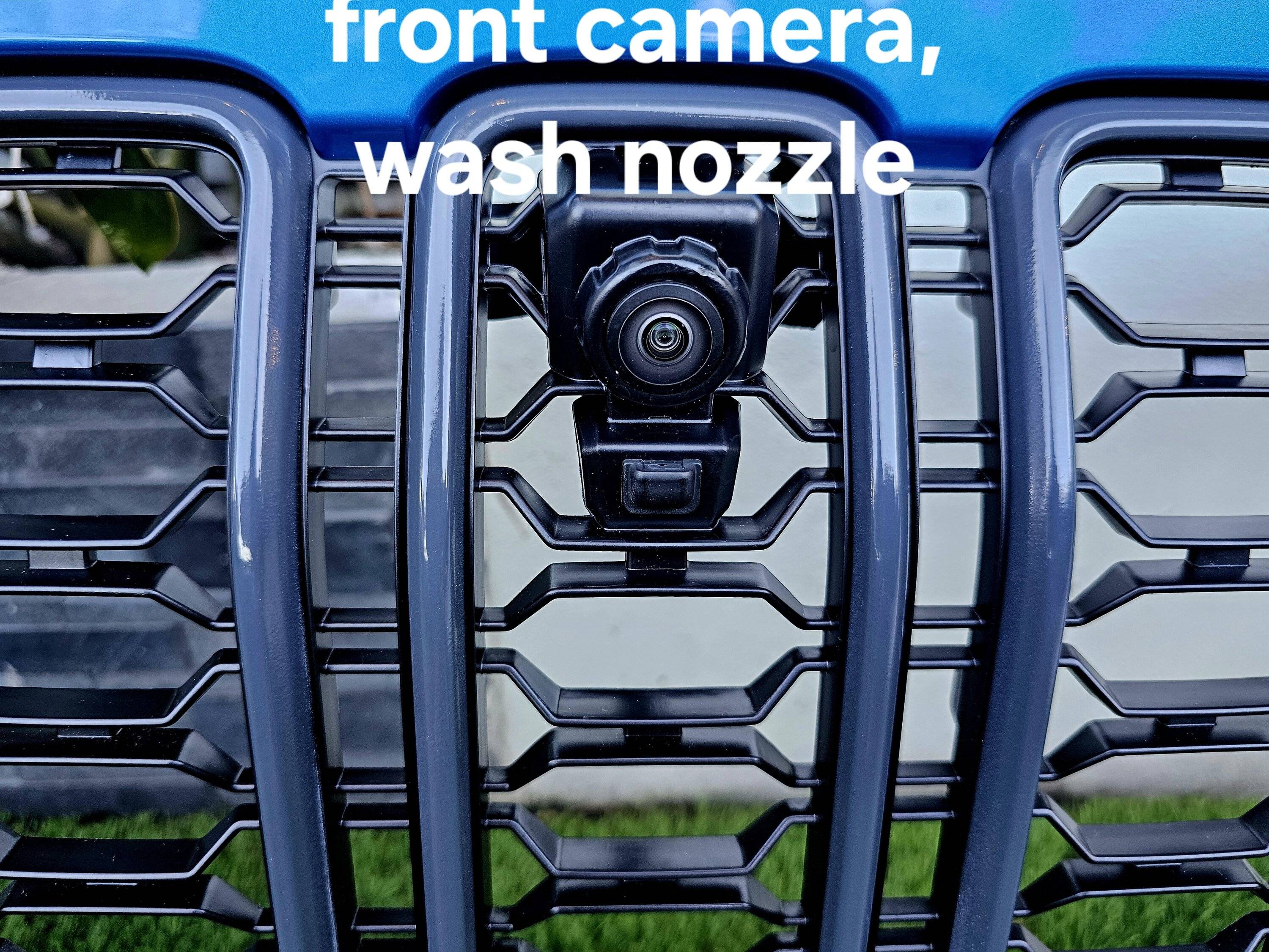

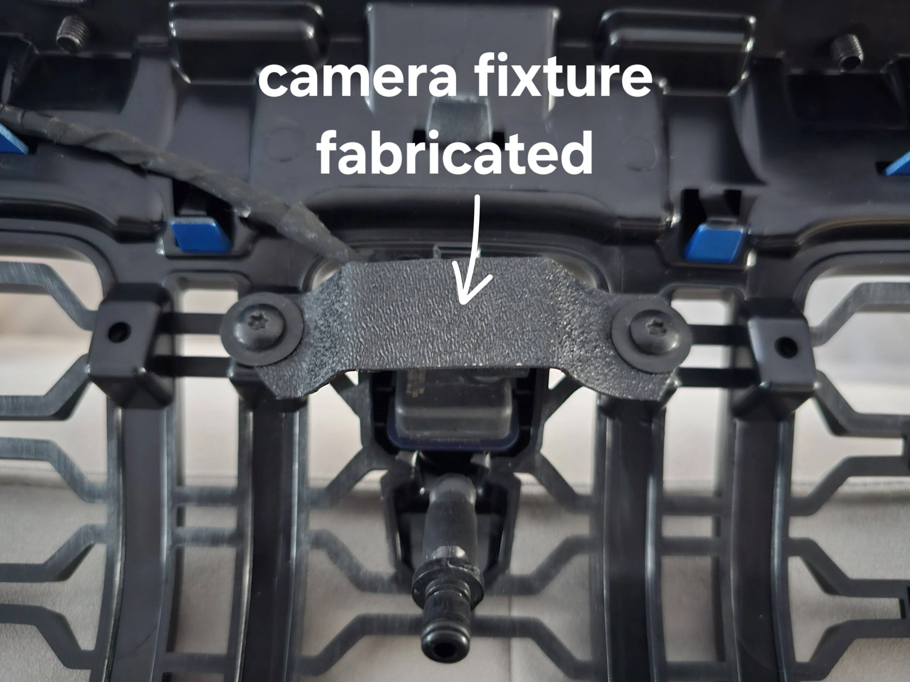

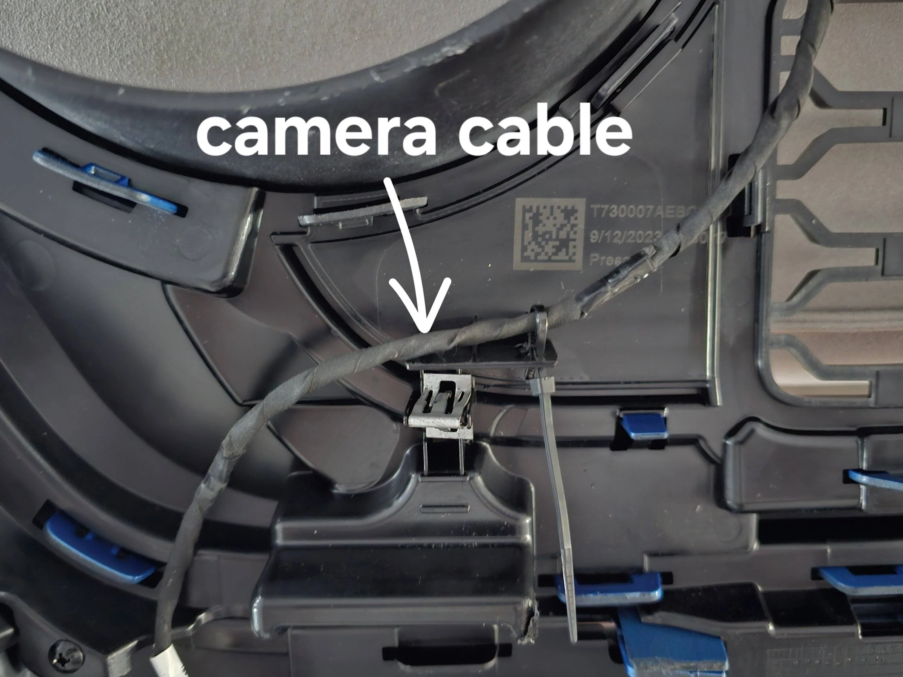

Although the camera and its washer nozzle fit precisely into their slots, the camera bracket does not fit the new grill and no replacement was sent. I fabricated a simple bracket out of 3mm thick ABS plastic sheet to resolve this issue. The camera cable clips cannot be swapped over so I re-routed said cable up below the top edge on the driver's side and down along the headlight bezel and fixed it in place with small zip ties.

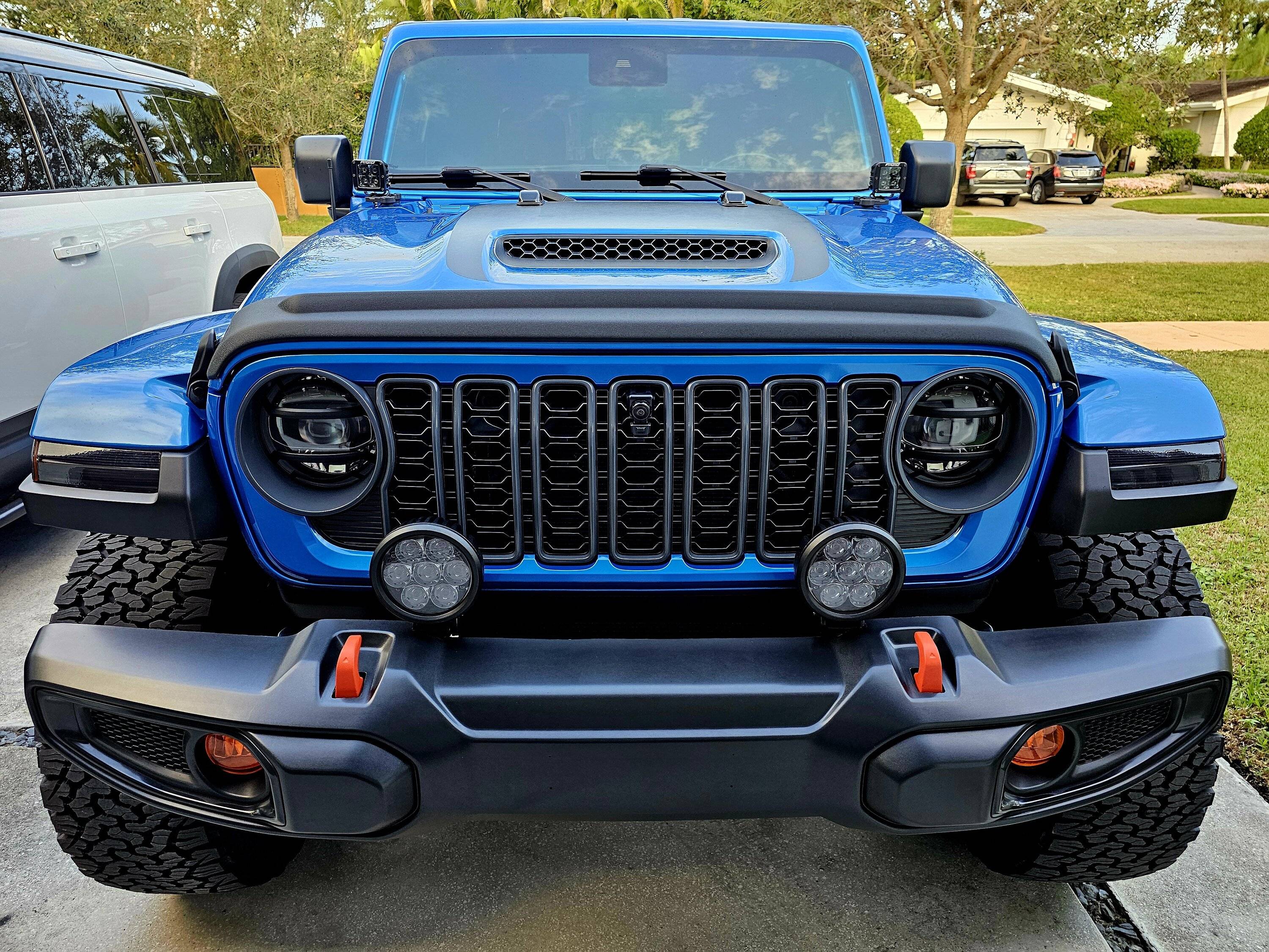

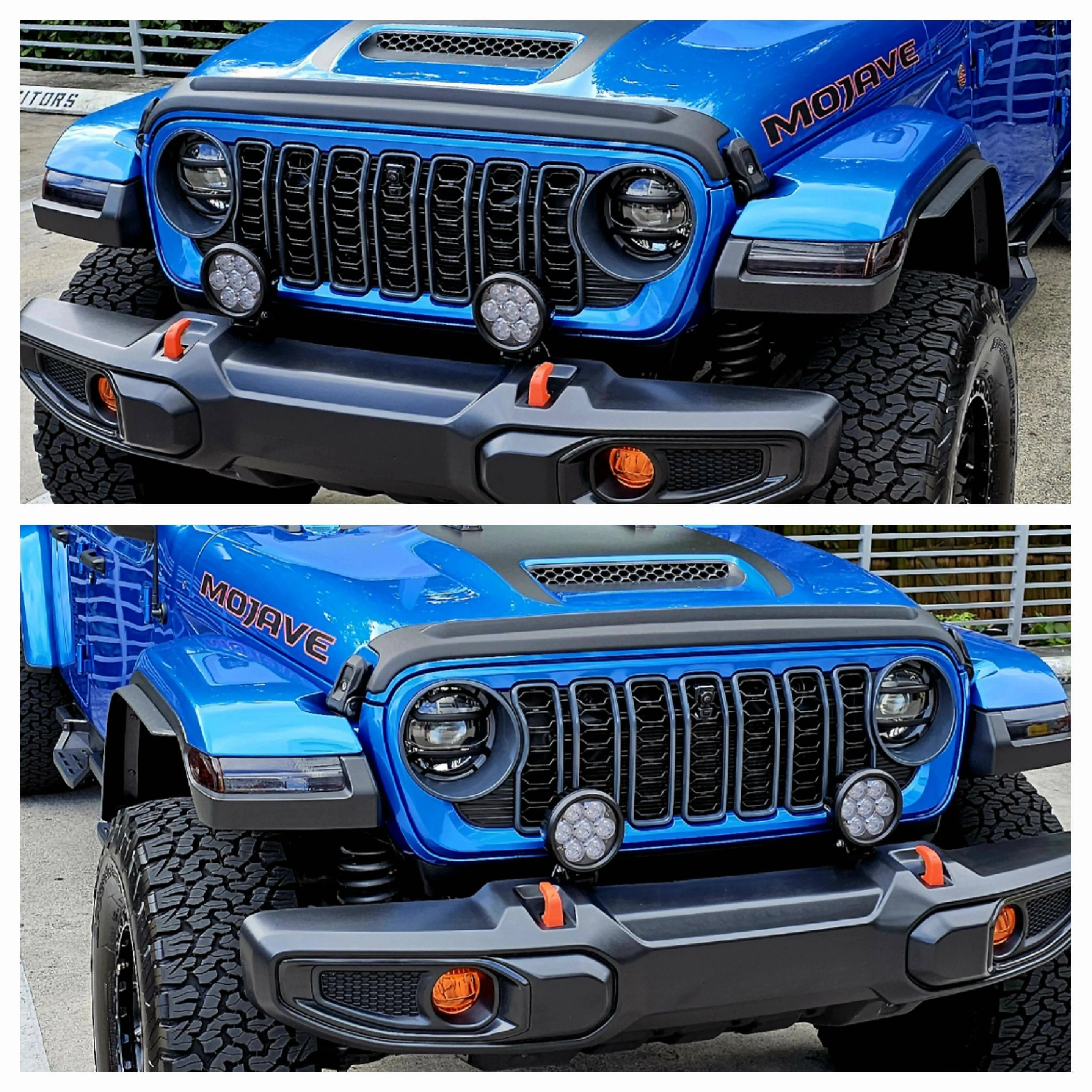

After all this was done, the whole thing just snapped back into place on the front of the Gladiator and looks fantastic!
It's certainly more involved that I thought it would be and I hope this helps anyone that will be performing the grill change in the future.
See pics below for clarification of certain details.
