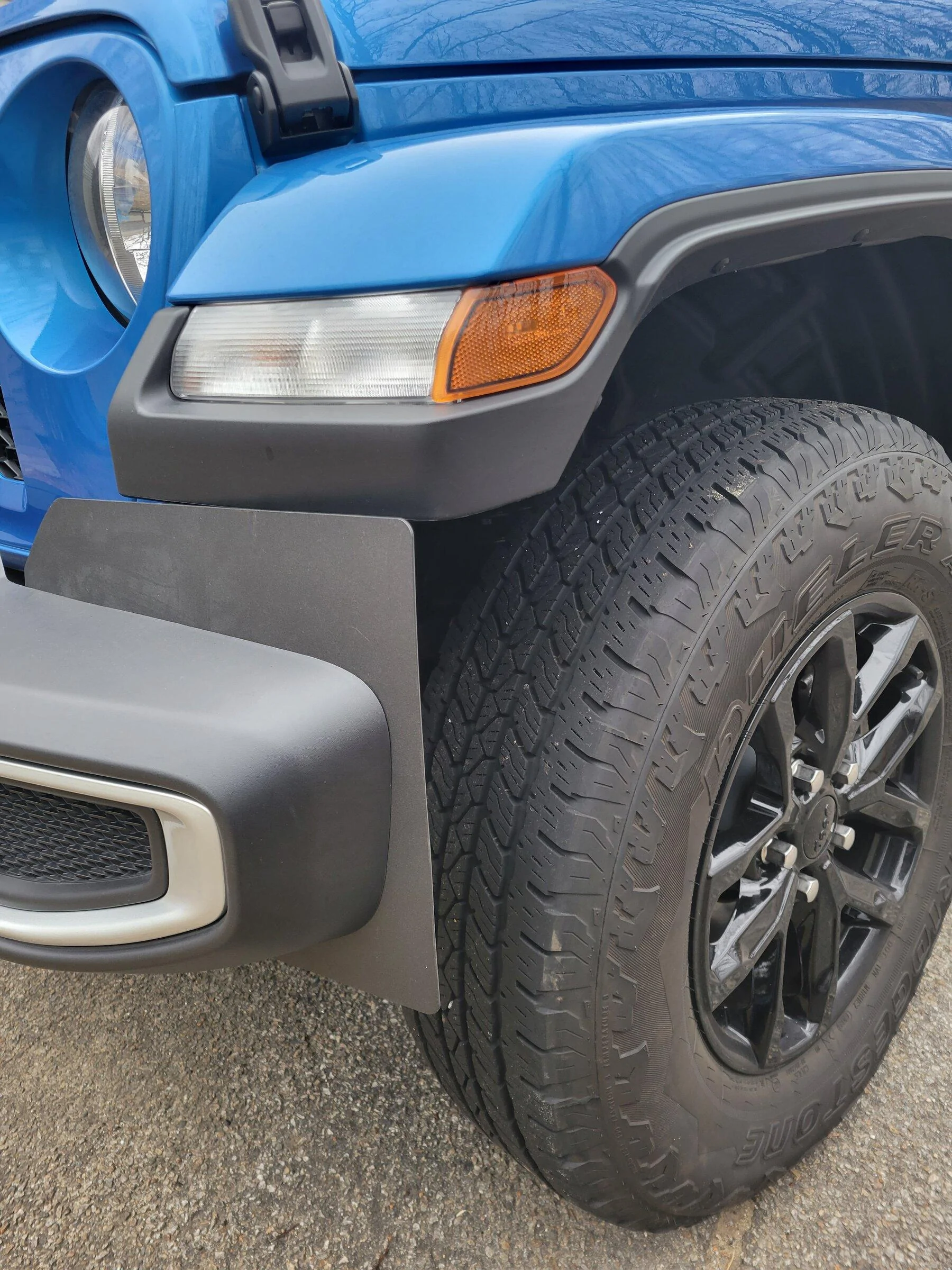

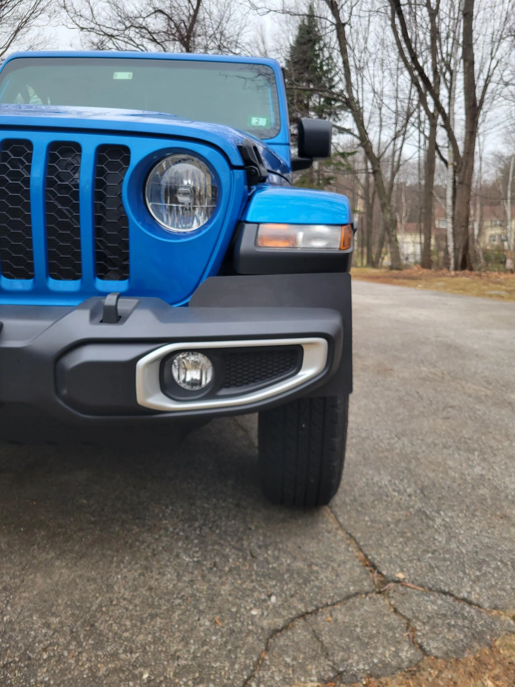

After talking with a couple other forum members, and reading a good bit, and seeing a TON of opinions...ive decided to do an experiment.
When I first got my JTmt I cut down the air dams on the bumper within the first week. Then did a mess of other things, much like many of you. After towing with the JT I decided to do a different experiment. I ultimately ended up back at a more OEM tire size to preserve my towing power / capability and my daily driver mpg. Here is a link to that little life lesson incase anyone want to thumb through it "Worth it to go back"
Now, in the same vein of MPG for daily driving, ive wondered if the air dams really did anything significant. And if they did, was it significant enough to keep the not so jeep look. Ive leaned more function over form with the JT..so it wouldn't be the end of the world if they had to stay on.
So the experiment.
Question:
+Do the plastic air dams on the OEM bumper increase MPG over the OEM bumper without them?
+ If there is any gain, at what point does it offset the cost to "go back" to the OEM bumper?
Research:
+A lot of opinion on the forum believe they help a little, in the area of 0.5-1mpg max
+jeep added them intentionally, which lends to them being useful since most all design features they did on the jt and jl are actually pretty impressive. (ex: the exhaust loop)
+after talking with an engineer, i was introduced to the drag formula. Now I dont know the coefficient of the JT, but what I glean from that formula is that it takes the entire frontal area of the JT into account for the drag of the vehicle. And the air dams make up a very small portion of that surface area. ( paraphrased from the engineer I spoke with). There is a school of though that the interior area of the wheel well creates a significant extra drag since it is open to the air movement now and sort of traps it. Certainly not something I can test, but interesting to think about. finding the drag coefficient of a vehicle

AF1- The Jt seems to need fewer steering inputs with normal driving. I use the right lane only for the entire trip, unless I need to pass a driver going slower than 65mph. In which case I merge and....slowly....pass them with out increasing my test speed.
AF2- The Jt seems to hold 8th longer on inclines during the trip.
AF3- The Jt shifts back into 8th sooner after automatically down shifting into 7th while in cruise at 65mph.

Day 1
Trip 1
24.5mpg average for the trip
-no notable increase in how fast the JT shifts into 8th
-interesting finding. While traveling up a bridge I remained in 8th longer than usual. Routinely the JT will shift into 7th before a specific sign. Today I stayed in 8th for an additional 3/10th of a mile. Seems small but points to a possible decrease in wind resistance. Interesting enough that Ill keep an eye on when the JT shifts on most inclines now and maybe add that as a data point.
-anecdotal observation...the jeep seems to track straighter with fewer steering inputs on straight line, right lane, driving.

Based on this thread I'm trying it with a diy version because they don't make the air dams for the "fancy bumper" I put a set of cross bars on the roof this week and my already piss poor Mpg dropped from 19 to 18 and I figured I should at least give it a try. I'll let you know if i see any improvement.
Jeep Gladiator MPG Experiment 20220331_141736
Jeep Gladiator MPG Experiment 20220331_141731
