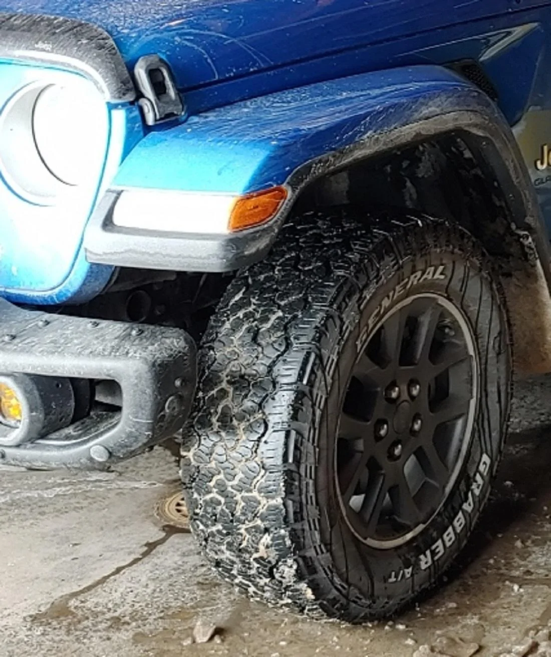

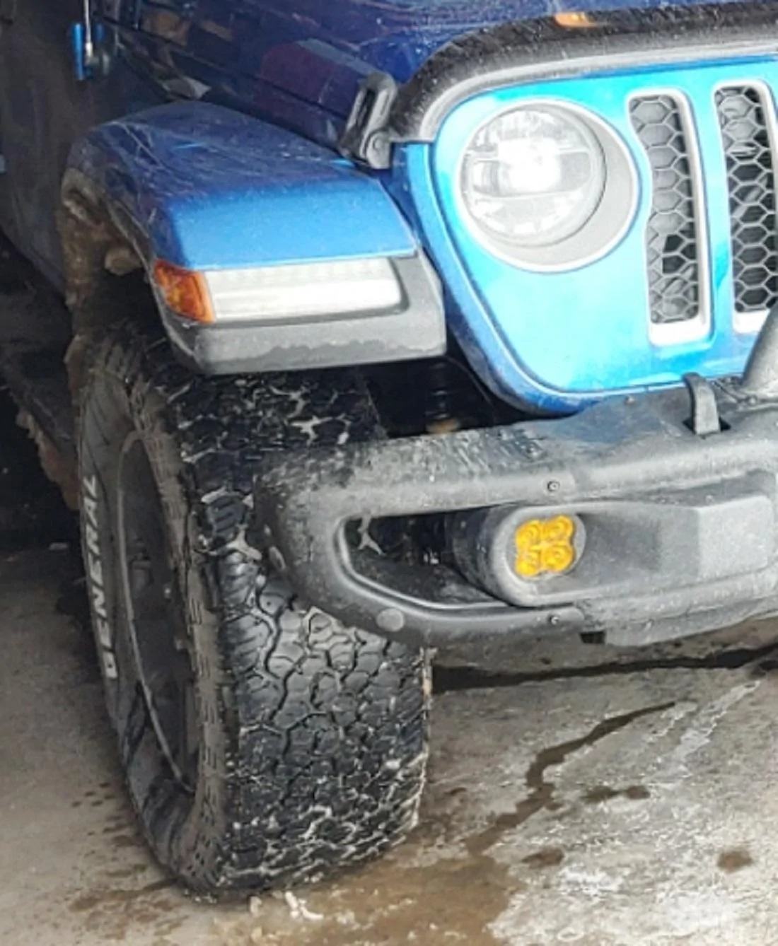

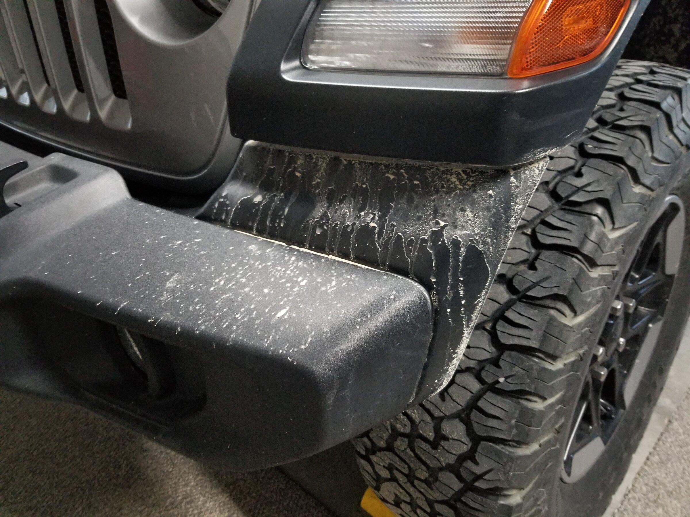

Here's another reason I'd like those gap-fillers (aside from MPG) -
A lot of the stuff that comes at my windshield is from my own front tires. I have watched as spray on a dirty road is thrown forward over the bumper by the tires and the air flow turns it and blows it right back at me! It's weird and cool to watch the spray being shot forward from the tires stop, and almost in slow motion, change direction and come up over the hood and fenders at me.
The top of the bumper ends is always loaded with sand and mud and slush.
I've got one of each.
While the one with the gap fillers does allow less crap through, its pretty amazing just how much makes it through that little gap between it and the fender.
The tops of each of the bumpers get covered with crap and both throw it up into the windshield.

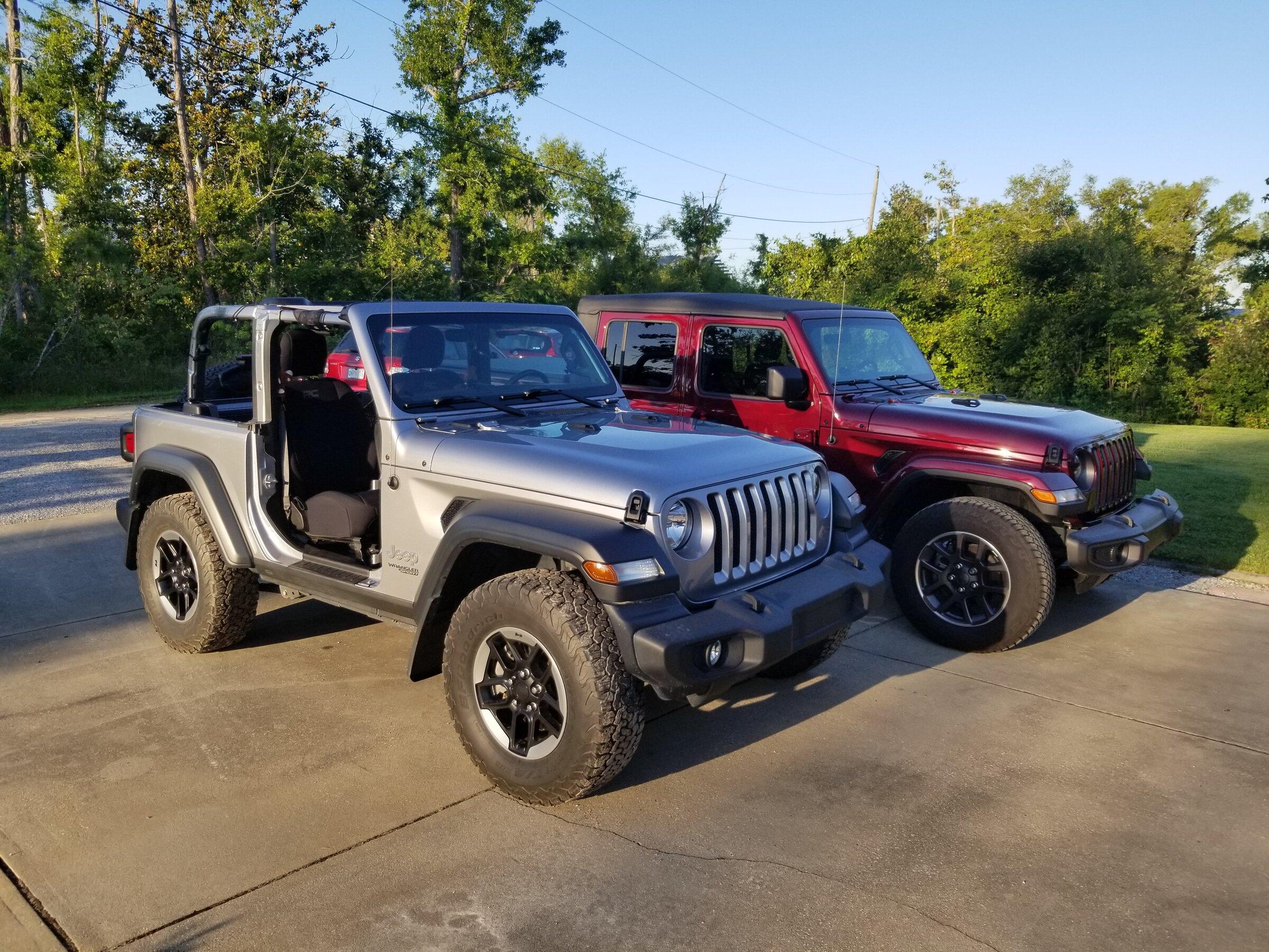

the rims on the wrangler are the ones im having installed! haha Theyre gonna look good on the JT. You dont see them around often, at least not around me.

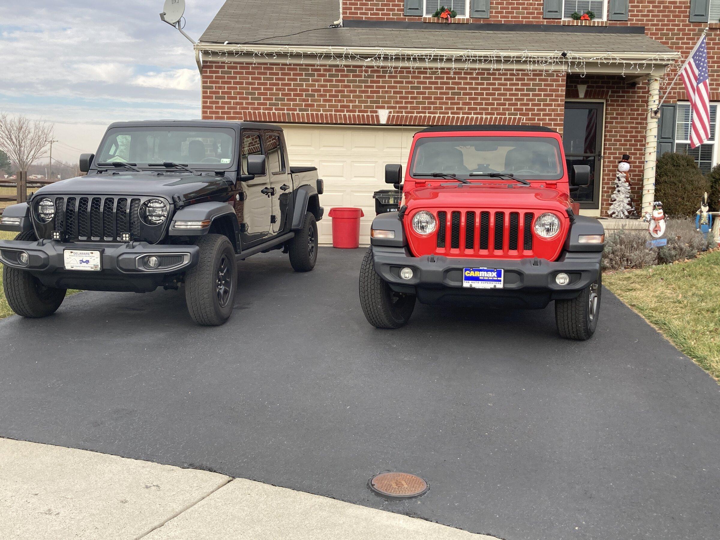

If the premium bumper is the same pumper in the pic below then they will not. They only fit the standard bumper in the picture in the first post.
Now another fella, I think in this thread, said he would make something that would work. May be worth a collaboration between the two of you that if he is able to make something worth it you share the cost of his R&D. Just food for thought.
The bumper on the right, which is the same as the one i have on the gladiator now, is the only one I’m aware of that can take the Euro air dams. If the bumper on the left is the “premium “bumper then it cannot take them.
Yeah, my bumper is like the one on the left in this picture.
I've read about a guy that fabbed up something using plywood, but he was only using it when towing his Wrangler, to keep stuff from spraying all over!

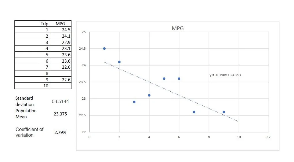

You shouldn't be throwing out data when it doesn't meet your perceived expectation, it should be used. When you graph your data, it becomes more apparent and then you can analysis all the data and massage it out with the math. Just from the graph alone you can see a downward trend in your MPG without the two data points of 20.5 that you didn't want to use. Also, according to the data, you do have deviations that are within the .5-1 mpg accuracy you are looking at so far. I would set up excel and use a similar graph to track the data. If it was me I would also document weather as well as the amount of fuel in the tank and use it in the graph etc. Where are you getting the MPG from, the computer uses a formula to give you MPG and it isn't "real time”. A cell phone app with GPS would be the best option IMO.

Fair
The reason that I excluded those two data points is that the weather posed a significant change to the conditions. And my experiment is focused on trying to keep the weather as similar as possible so it is not a variable that needs to be accounted for. A head, or tail, wind of 10mph + certainly would make enough of a change that it would show in the date. Which you can see when you include those two data points.
Same with fuel tank level since then we get into the overall weight of the truck and such..i dont really want to have to weigh my self before I drive every day haha. and though the fuel weight could make a difference, im more interested in the aerodynamics side. I can certainly add that as a data point and make sure the tank is at least half full before data is collected.
This is definitely a broad stroke look at things. But im trying to both keep it simple, and keep the data collected limited to specific criteria.

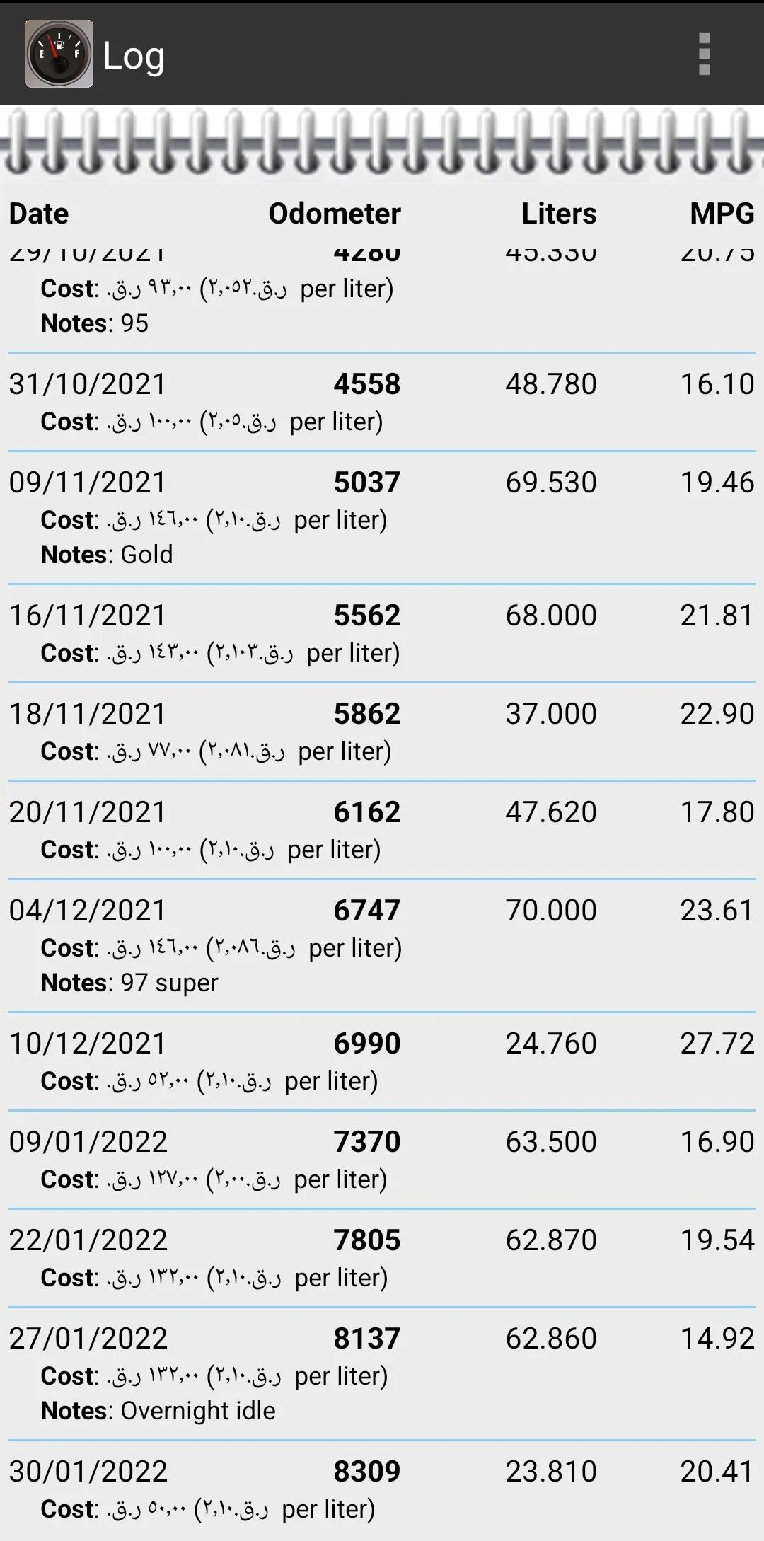

Thought I'd throw in my findings so far. The lower readings are linked to being used off road and the 14.9mpg includes the 10hrs of idle when I left it running overnight!! The high of 27 is linked to the tank not being filled and the following one is then lower to compensate.
My average since I've had it is 19mpg.
Petrol JTR on 35" with 1.5 leveling and AT.

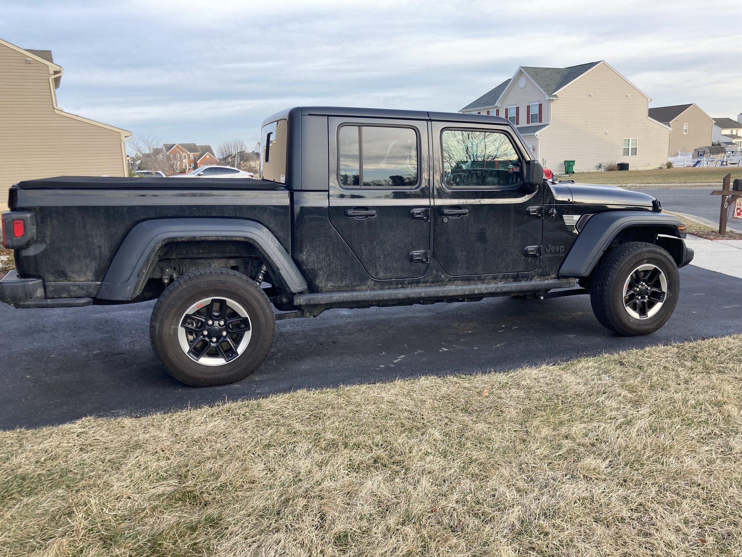

Got it back!!
Pleased with the new (to me) wheels
im giving the rear dif a bit to wear in before I start the experiment back up. Right out the gate though it feels just like it dis before it went down for service, which is nice.
