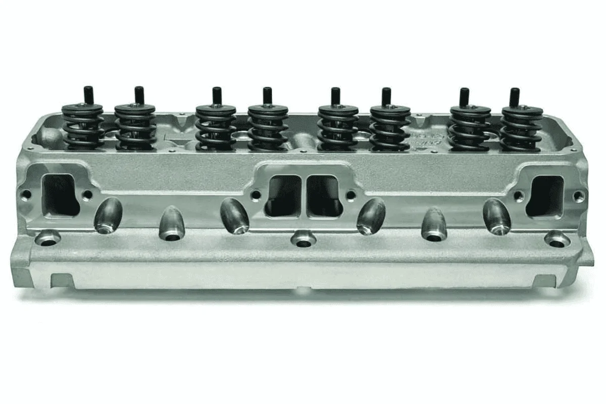

And talking about how shapes, not just sizes, impact air flow - back in 1969 a small auto maker came up with high performance high flowing heads by making a simple change to the exhaust ports - the dogleg head.
These flow 20% better than a rectangular port exhaust. Proven on a flow bench. The placement of the dogleg was critical. The heads are otherwise the same.
Shape matters, not just size. 20%, amazing.
