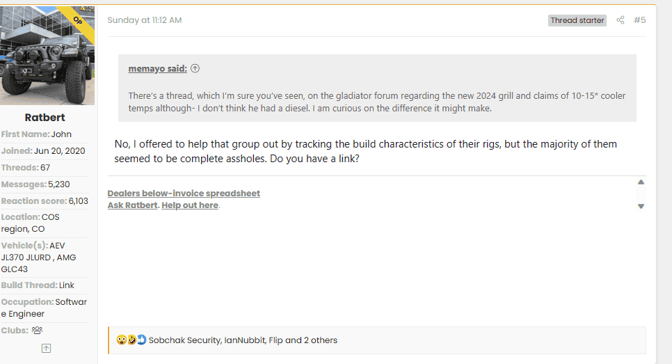

The Wrangler forum is debating the new grill also - APPARENTLY we are ALL assholes.....according to some douchebag named Ratbert on the Wrangler forums. I see everyone HERE 95% of the time getting along and having adult conversations, agreements and disagreements, but cordial.
Fuck those a holes who think we are like foreigners for having the BEST JEEP!!!!!
Ratbert still has a active account here with like 9 posts. I think in the link below is his first post talking about tracking build changes and characteristics but referencing Wrangler stuff that did not really have direct parallels to the Gladiator.
https://www.jeepgladiatorforum.com/...s-available-for-2022.58779/page-5#post-969751
https://www.jeepgladiatorforum.com/forum/members/ratbert.50342/
Looking at all 9 of his posts, I really cannot see where the panty twisting came from unless he was expecting to be a big thing over here and nobody lined up to sniff his farts.
Wrangler side has always had some cliques that trash talked the Gladiator from the day it was announced.
