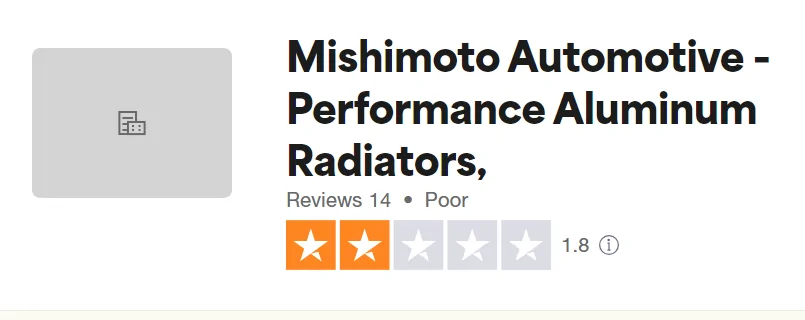

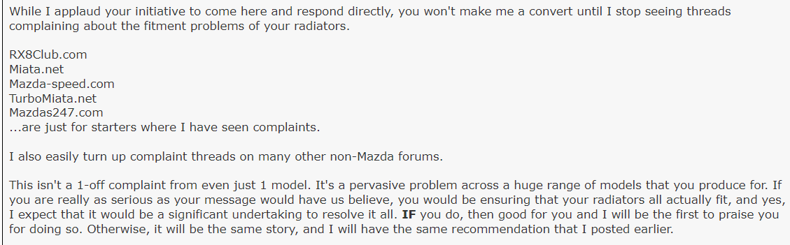

Mishimoto has a aluminum radiator and a upgraded trans cooler. Pricy, yeah, but their quality is second to none and these are bolt in applications
https://www.mishimoto.com/performance-aluminum-radiator-jeep-gladiator-2020.html
https://www.mishimoto.com/jeep-gladiator-performance-transmission-cooler-2020.html
Jeep people seem to be the only ones liking them......
Jeep Gladiator New 2024 grill insert experiment 1690999814550
When looking at products, this would send me away -
Jeep Gladiator New 2024 grill insert experiment 1690999858582
From BBB
Jeep Gladiator New 2024 grill insert experiment 1690999897918
And another review site -
Jeep Gladiator New 2024 grill insert experiment 1690999940670
With all of the forum complaints and reviews like above - they are a non-player for me.
