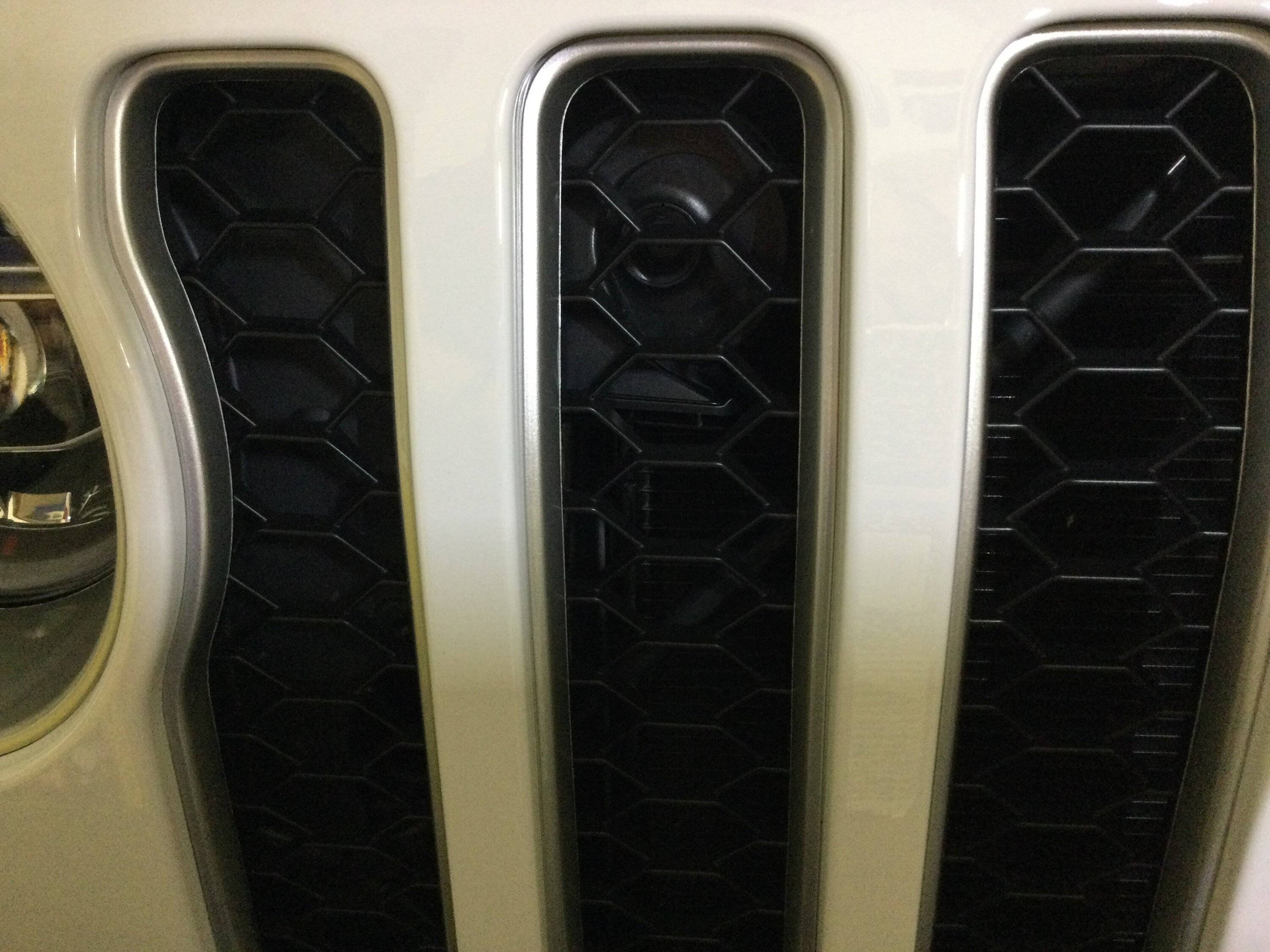

I don’t think you will see much difference at all. Waste of money but we all do that on our jeeps ?. Look at my grille in the pic. You must already have these wide insert openings already ? Furthermore the radiator and condenser can only flow so much air through the fins. Look how much bigger the grille grates are then the radiator. Maybe a little on towing but that’s it ?
I do remember people in the dead of winter back east putting a little card board in front of radiators for extra heat many years ago. Good luck and thank you for this test. can’t wait for your results ?

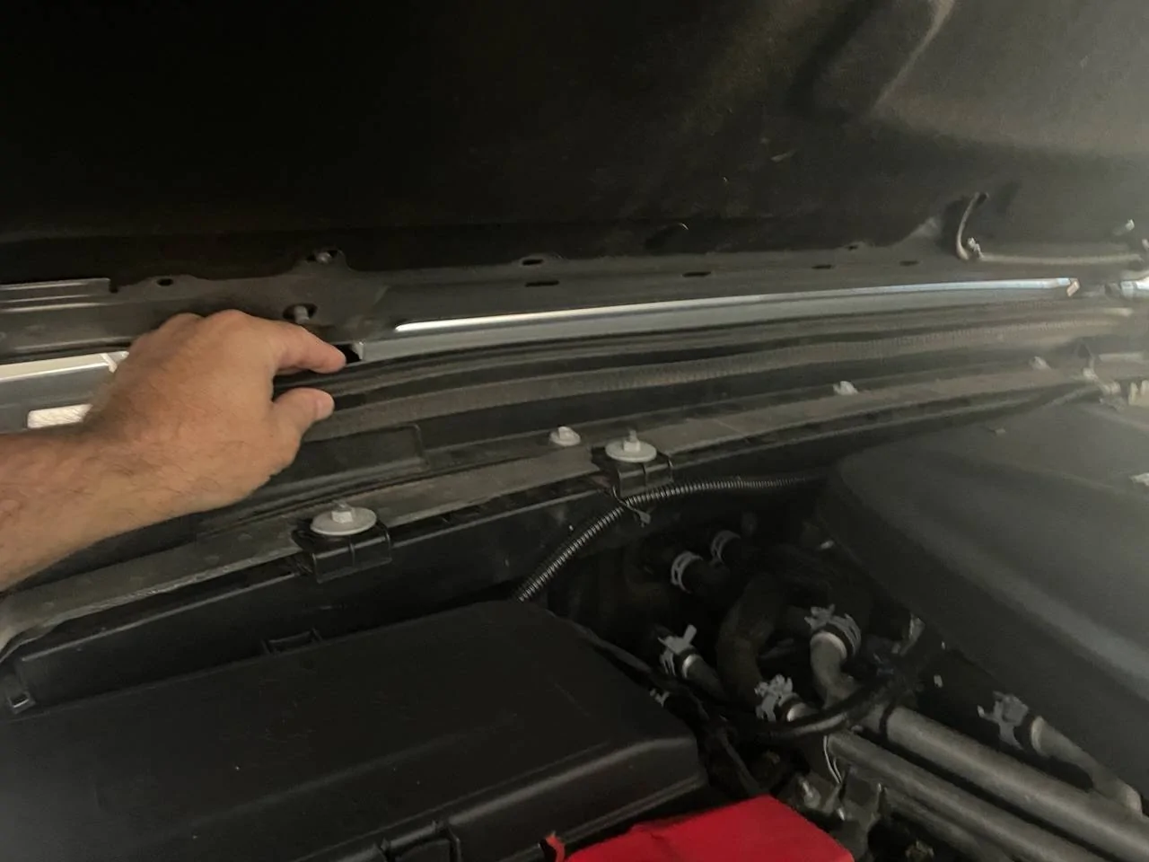

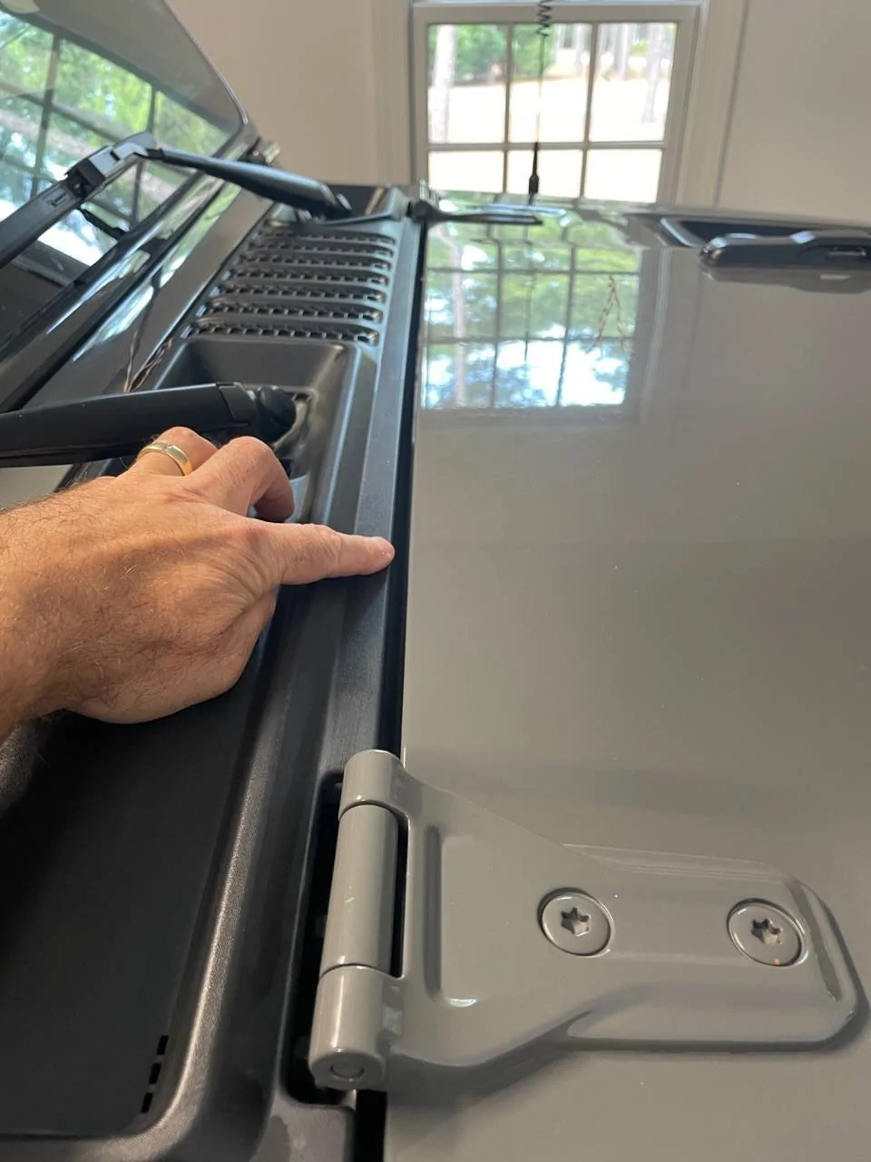

Another option would be to remove the rubber gasket at the firewall that seals the hood when closed. This could allow air to pass over the entire engine bay and exit just in front of the lower part of the windshield where there is already a negative pressure that will help pull the air through the engine bay.
When the hood on my JL was replaced, they left a wider gap between the hood and the cowl. That caused me to ponder if with the wider gap, would removing the rubber firewall to hood seal promote additional venting of heat from under the hood.
You really don't care about heat under the hood. You need all the air you can muster going through the radiator.
If such a gap helped air flow through the radiator.......... ok. Otherwise, naw.
In the end, unless your JT suffers when towing, it's not going to matter to a daily driver - they run good temperatures already.
