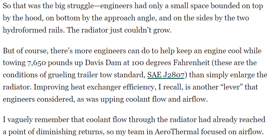

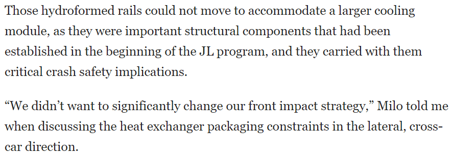

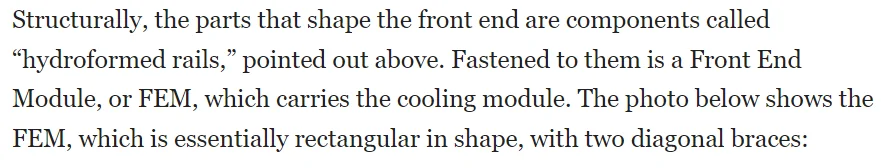

The structure of the JT had already been certified. Any changes at all to the width of the radiator meant changes to the structure, and re-testing, re-certification. Not that it can't be done - but not without some other sacrifices in money, time, and space for other things (look to the sides of the radiator and see how far anything could be moved and not interfere, and how much steel would be removed, resulting in different frontal and corner impact results)
If such a change is made, I'd expect it with the 24 or 25 model year - if then, since their focus is shifting (we won't go there, eh? Or as my 9 year old grandson would say "we don't talk about that")

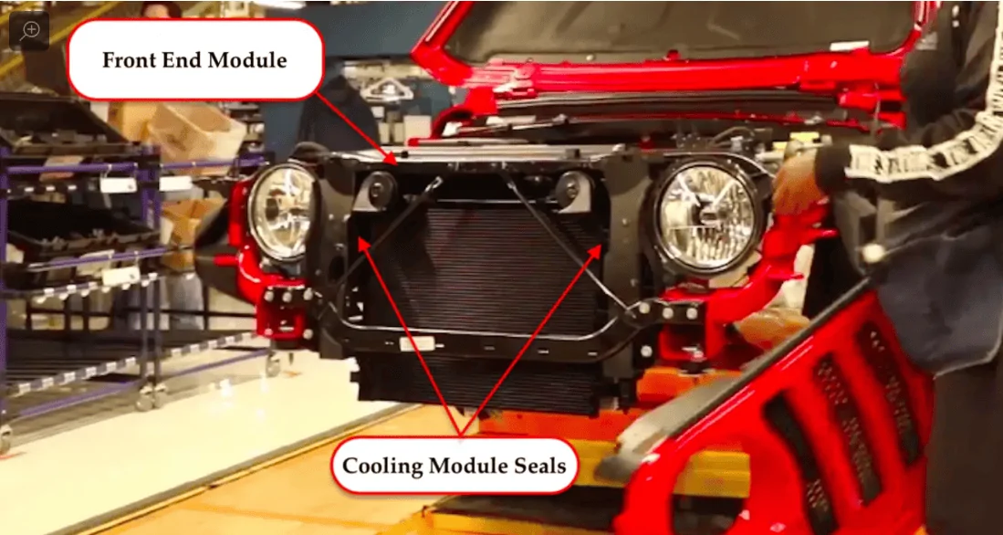

The pieces on either side of the radiator are plastic so they are of no structural importance… they are just plastic blocks that disrupt the flow of air when it hits that area. If they were made more at a 45 degree angle (or with a slight concave curve) this would promote a more laminar flow of the air toward the radiator…

They experimented with fan blade profiles and changes, spacing between fan and heat exchanger (we call radiator) and other aspects of cooling. But the radiator itself had reached the point of diminishing returns in the water flow aspect. In other words, simply making it thicker or flow more water wouldn't improve things.
They talked to the design engineers about changing the grill - maybe this new grill is a late response to that request??
All of the work done wasn't to improve anything at all below the maximum towing ability. So there's really no need nothing to be done for anything except improve cooling for the maximum payload and towing cooling needs.

^^^ those aren’t the blocks I was referring too…

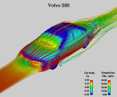

It's the other way around. The base of the windshield is a high pressure area, not a negative one. Air stacks up in that area. That's why cowl induction intakes work well.
40,497
54,011
Jeep Gladiator New 2024 grill insert experiment clip_image004
Jeep Gladiator New 2024 grill insert experiment 1691173759219
Ahead of the bottom edge of the glass a bit is higher pressure, but as seen by years of using things like RainX and fancy wiper blades, the bottom of the glass is neutral pressure, the high pressure is a bit higher (green) and farther forward of the windshield base.
I've watched water droplets on my cars for years - and the water at the bottom just sits and hangs there, not being compressed or pushed at all. Water up a couple of inches will slowly start to move up.
The cowl proper is dead space, at the front of the cowl, where cowl induction hoods work, there's higher pressure (the green in the clip above. Cowl induction works because it's not right at the base of the glass but forward. Now the question - where's the highest pressure - at the grill area or the cowl? Will air still flow through if that's opened up? All it takes is a little pressure differential to move air.
