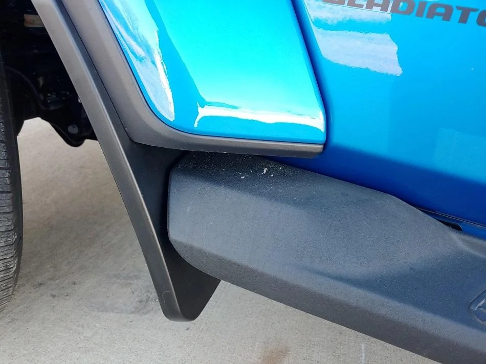

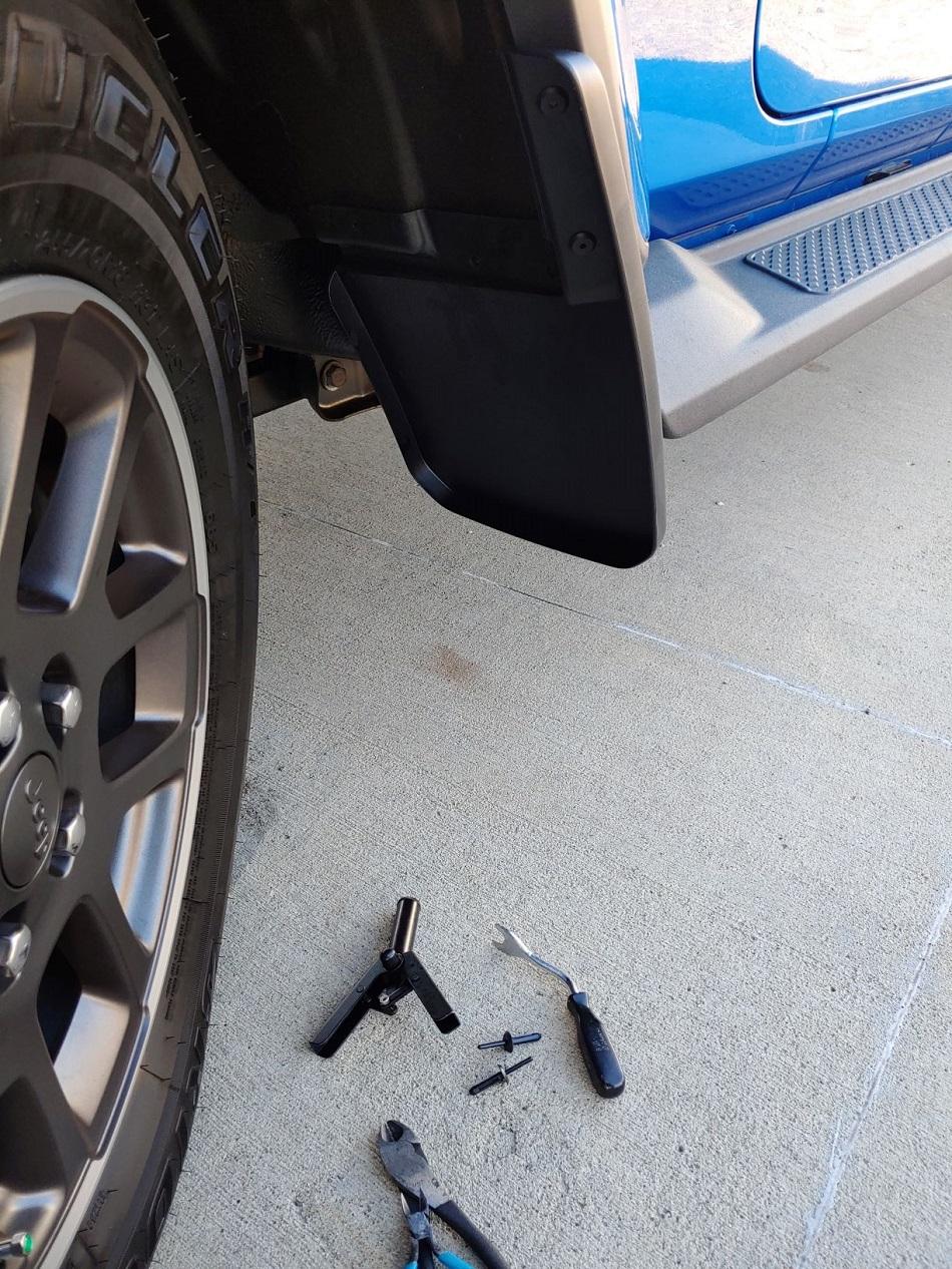

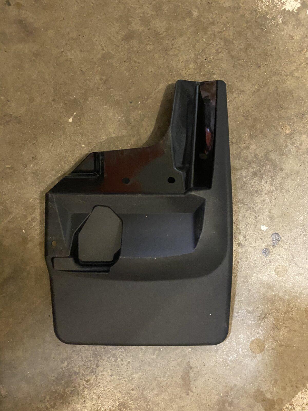

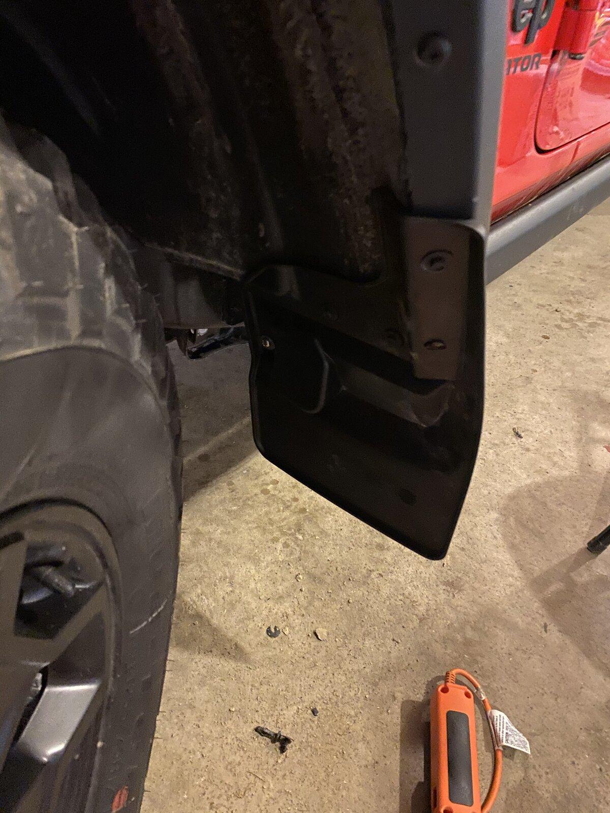

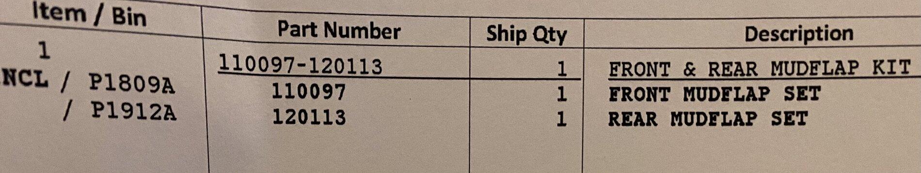

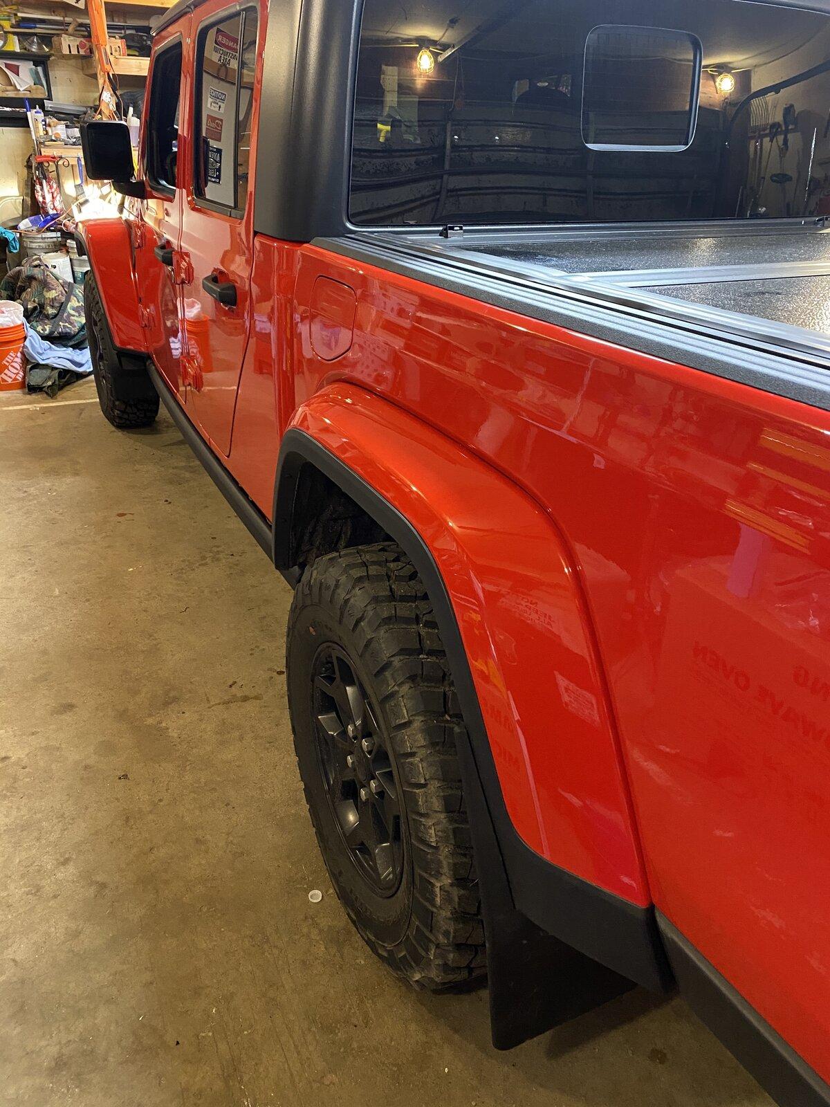

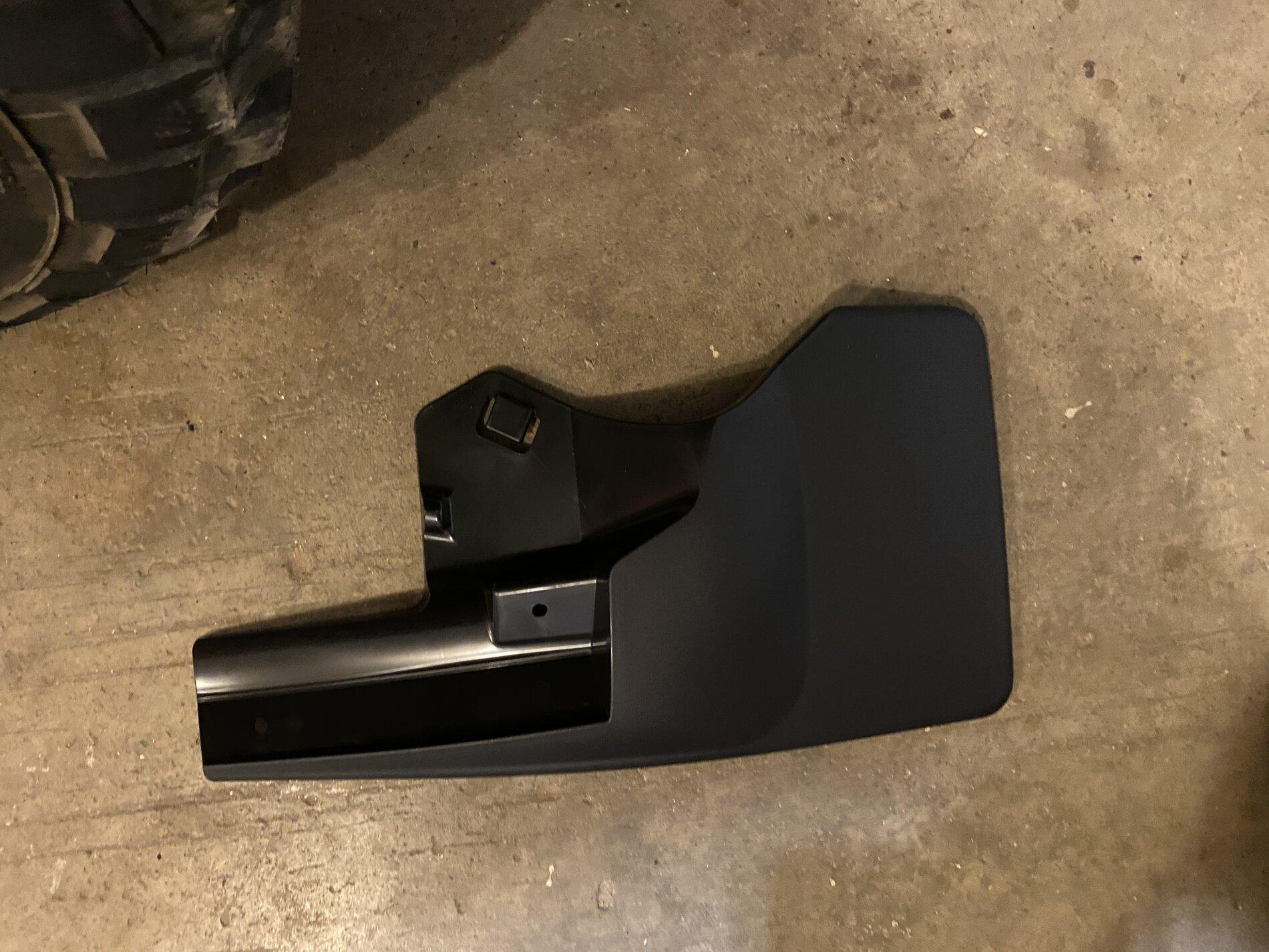

Issue resolved:
weathertech fit willys, with the factory rock rails: received and successfully installed as of 1/6/21:
“front And rear kit: 110097-120113”
these are the hard plastic, look and feel like the same black plastic as the fender....
Ive not had them long enough to review them other than to say they fit, install was easy, I did substitute 2 of the push fasteners with ones I had the I think work better, but all hardware needed was included.

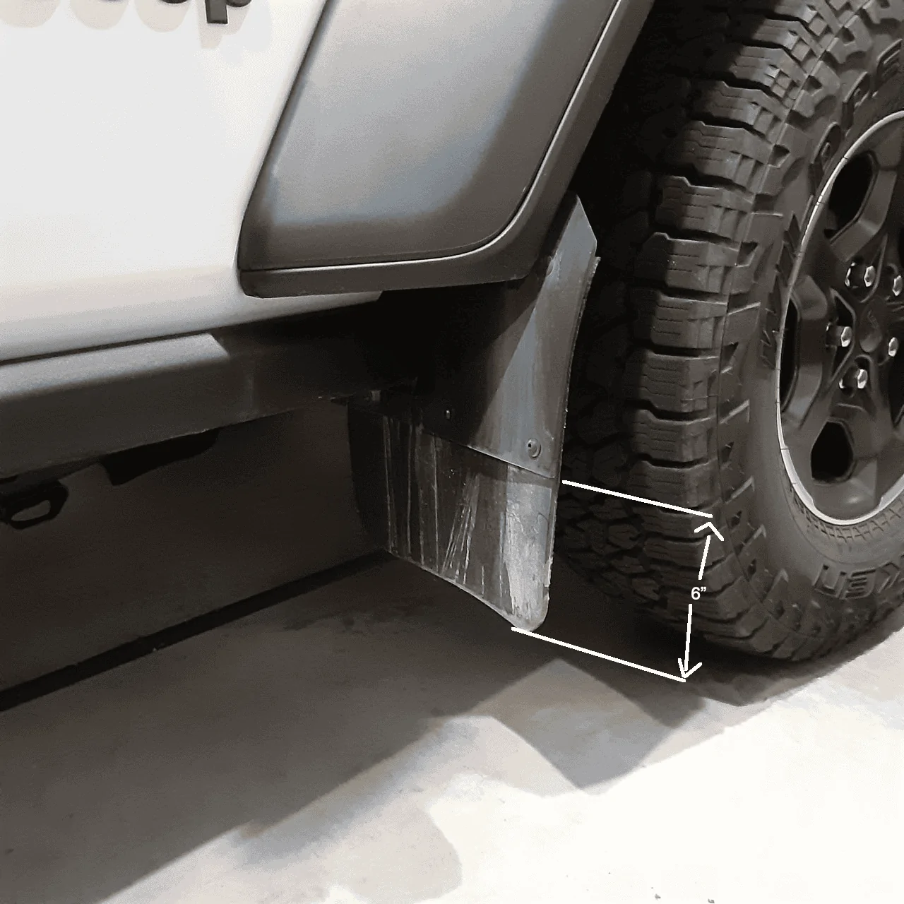

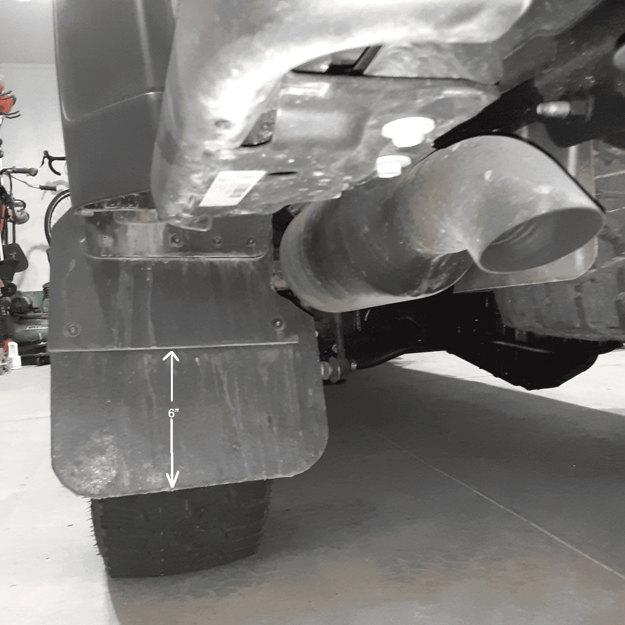

I have modified Rokblokz that I added 1/4" thick rubber mud flaps bottoms to so they would have some flex when striking obstacles and less chance for breakage, but still stiff enough to function. OEM Rubicon suspension and have them set at 9" front and 11" back from the ground to the bottom of the mud flaps, replace the stainless steel hardware with black oxide stainless steel hardware.
