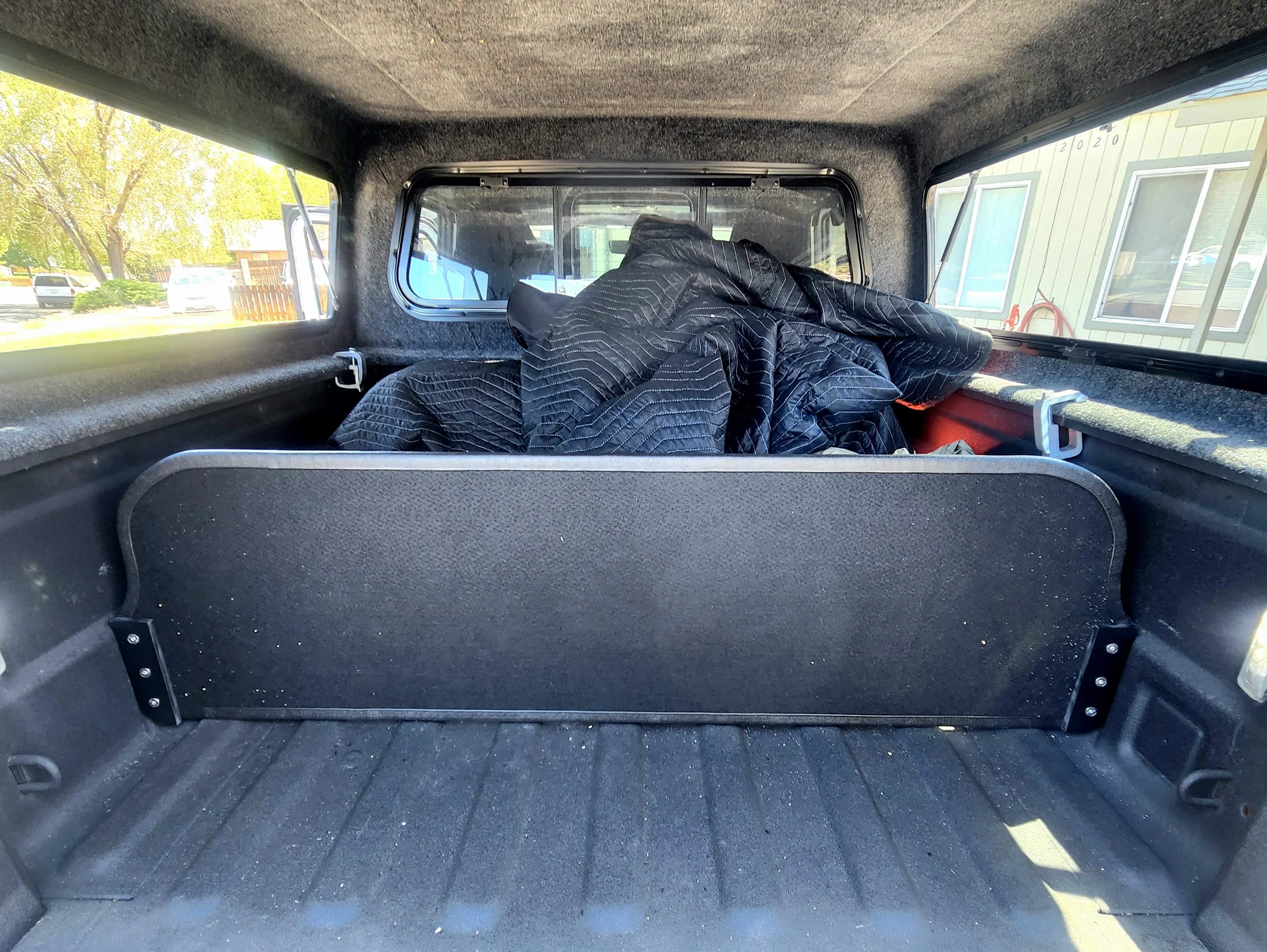

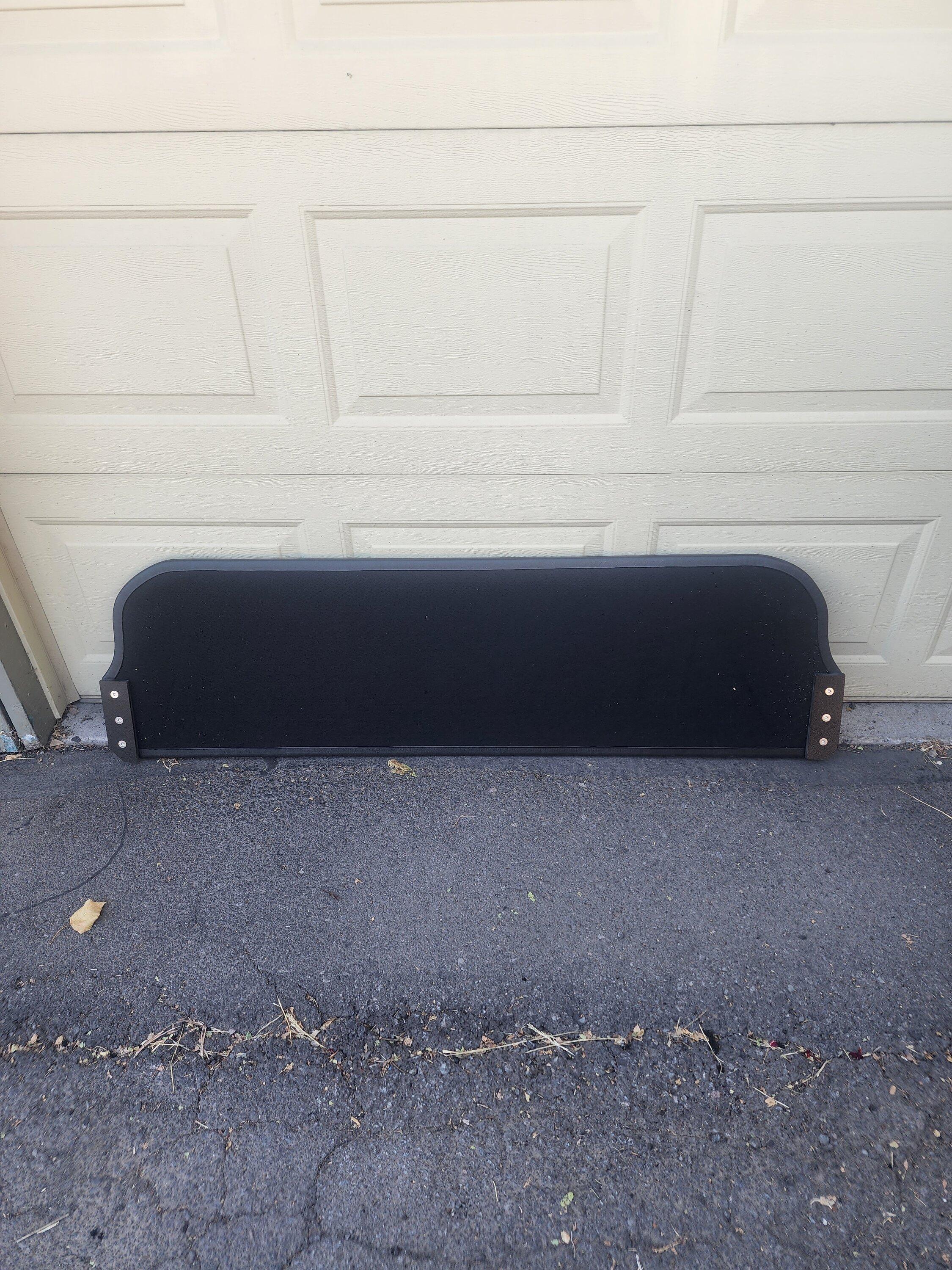

I used to have a shop. But it burned up in a wildfire. So now I live in an apartment and only have a few power tools available. But I wanted a partition for my bed from which I could hang an axe, a shovel, a fire extinguisher. And a few wrenches that I commonly use on the truck. All towards the back so I can reach them quickly in an emergency. I also wanted it high enough that I could use the partition and the front to the bed (where you can lay a 2x4 across) to carry long objects flat. So I built this. 3/4" plywood, covered in headliner (carpet) with the sides having 1/2 plastic mounted to give a tight fit at the area it slots into the sides of the bed. I finished the edges with channel moulding. I haven't finished yet but I thought I'd post a few pictures so anyone who liked the idea could make their own. Over the next few weeks I will be buying a shovel, an axe, a fire extinguisher, and a pry bat to mount. I haven't decided on mounts but I think I'm going to look for something different than the Quick Fists.
Sorry for the poor contrast on the bed mounted picture.

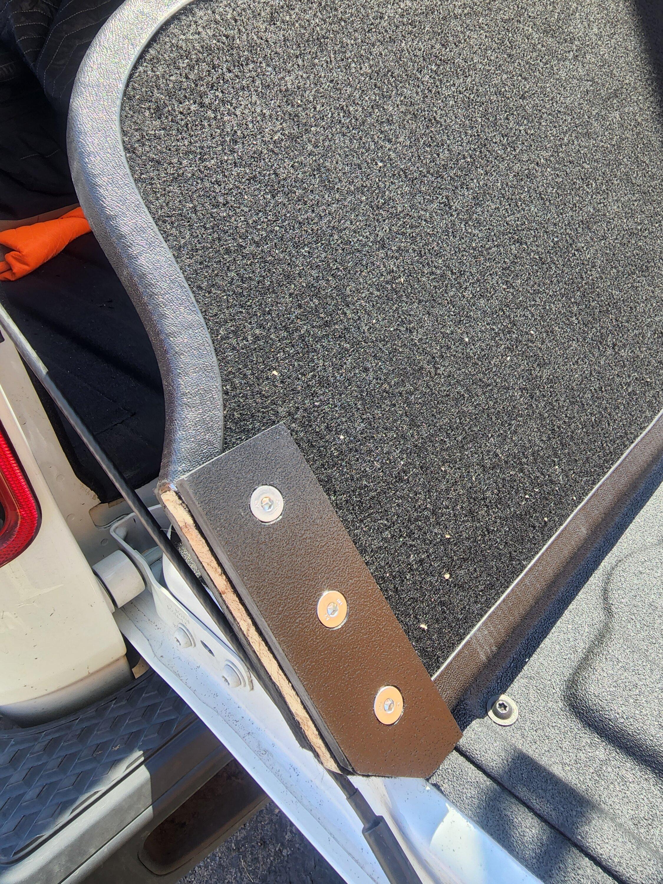

Well if you have any questions just ask. There are reasons I made the choices I did building this from the 3/4 plywood (lighter than 2x12's stacked and the gutter moulding was available to trim the edges in 3/4 inch size) to choosing the HDPE plastic as bumpers (soft enough and slick enough not to mar the bed but resistant to wearing). It would have been easier if I had a shop especially working with the HDPE which I could have cut more precisely with a miter saw or a table saw thereby spending a lot less time sanding it to shape. Cutting things precisely with a handheld jigsaw isn't easy. Especially when the tailgate of the Gladiator is my workbench
The negative is that that long a 3/4 sheet of plywood is a little flexible. Especially just secured at the bottom corners. That could be improved by running a 1/4" by 2" stringer on the backside but I think once I mount the shovel across it the hard mounted shovel will add sufficient rigidity for my liking. But I certainly did not want to lift something too heavy in and out of that slot. Which making it from 2x12's would have been too much for me to remove it without cussing.

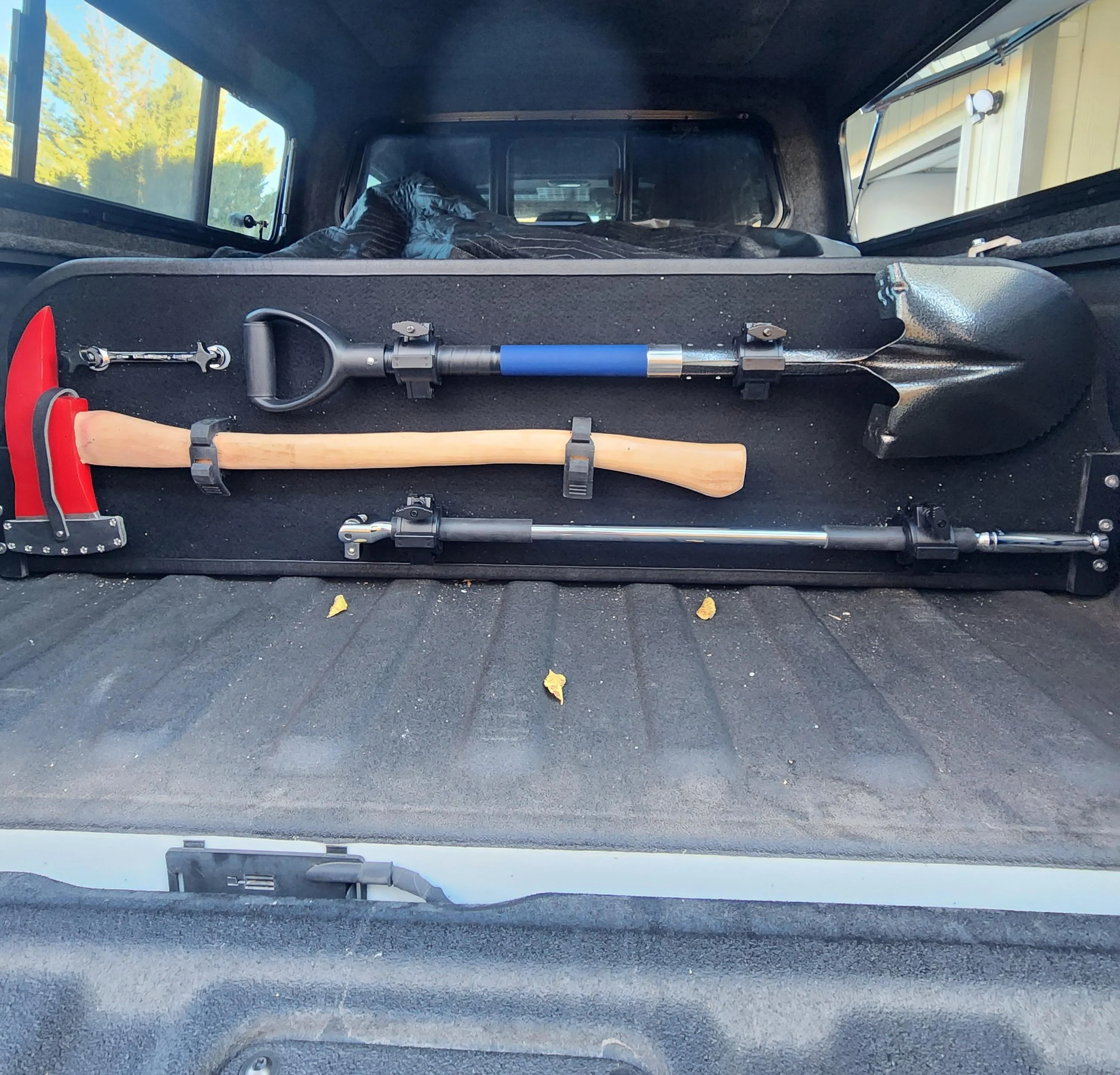

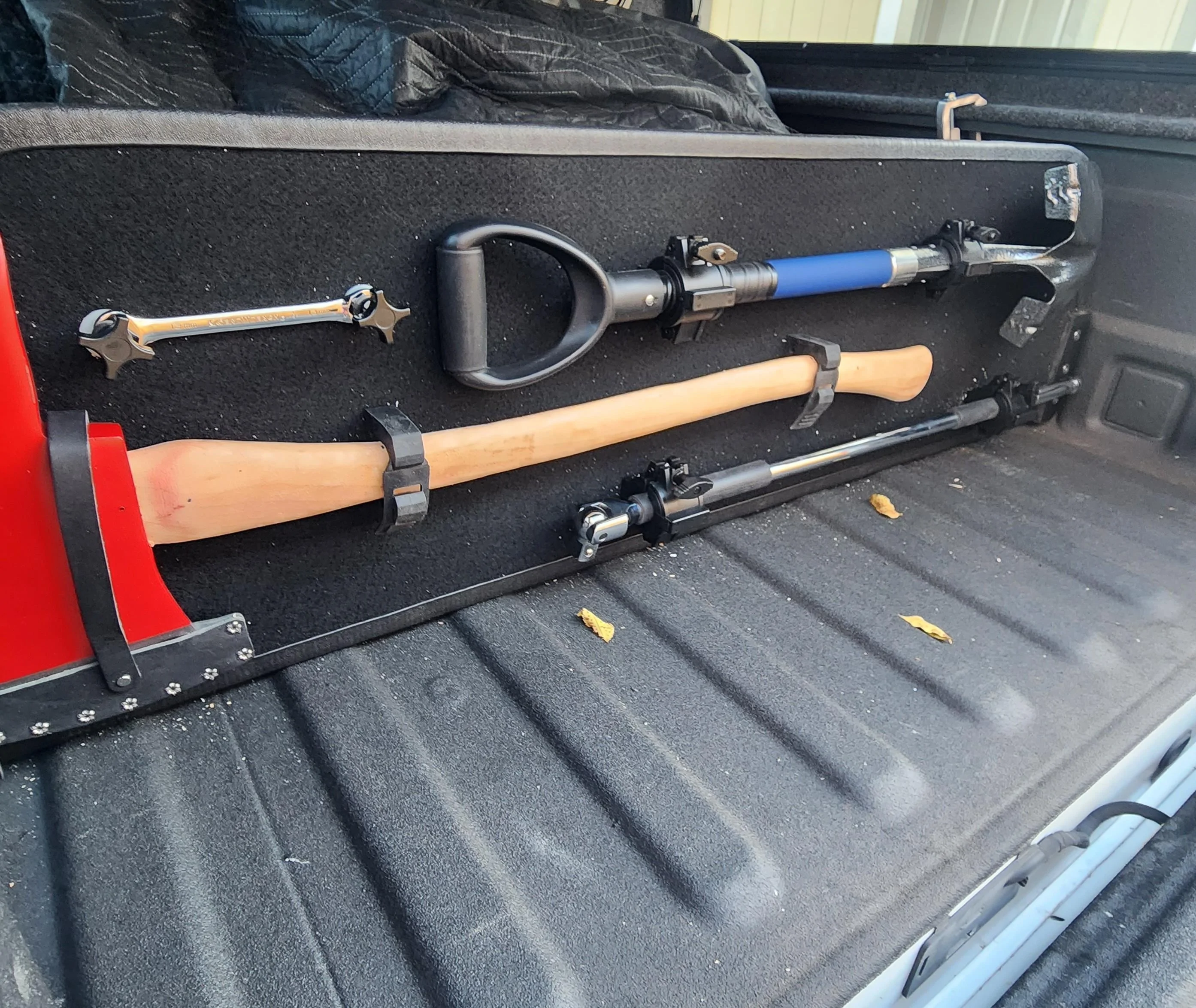

Well, I said I'd be back with up dates. There is still some room for some small items but the big items are about all I can fit.
Shovel
Fire Axe
3/4 inch drive breaker bar
13 mm ratcheting wrench
The 13 mm wrench is important because it is what I would use to connect the positive lead from my winch to my battery when I use the winch. So I like to have it easy to find.
The 3/4 inch breaker bar for when your lug nuts just won't budge. I have a socket for the lug nuts in the tool box
