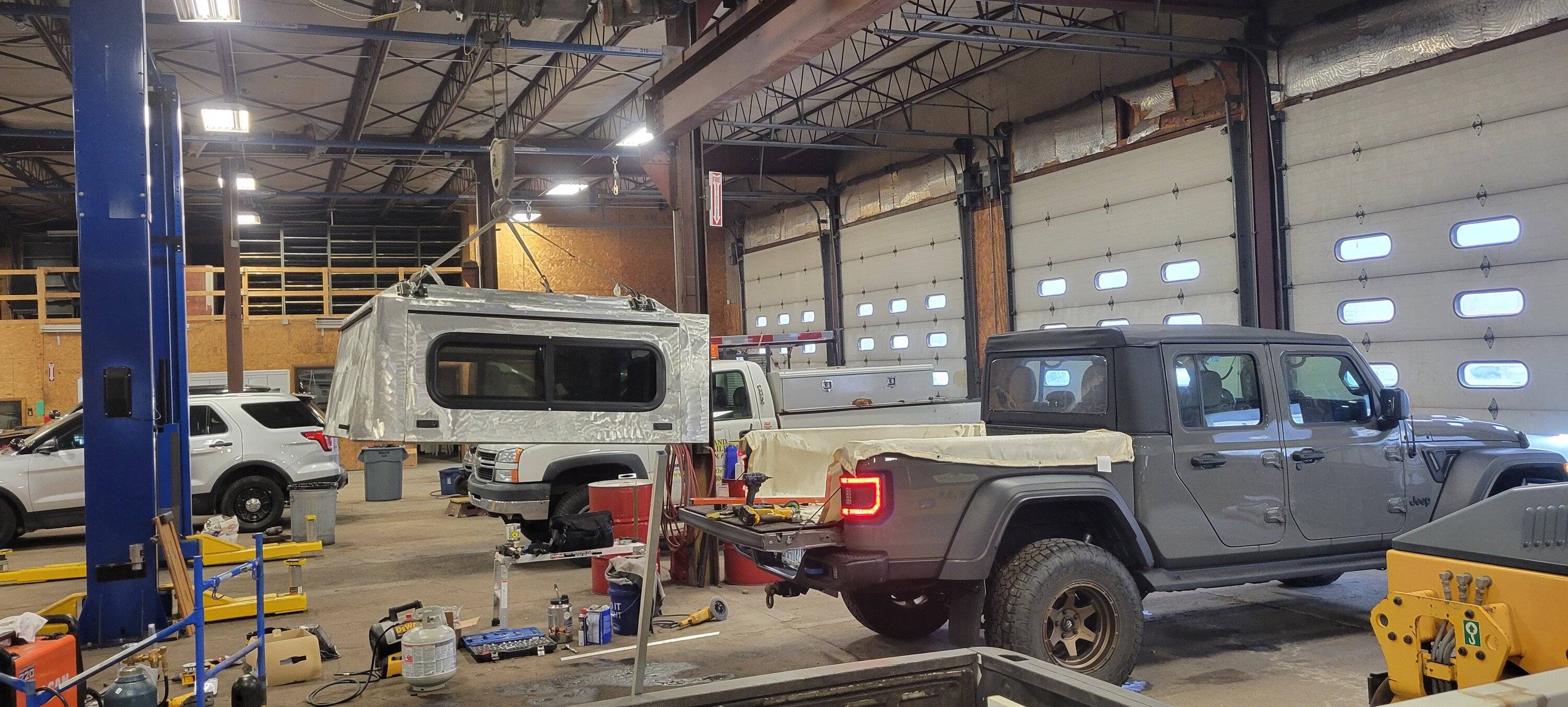

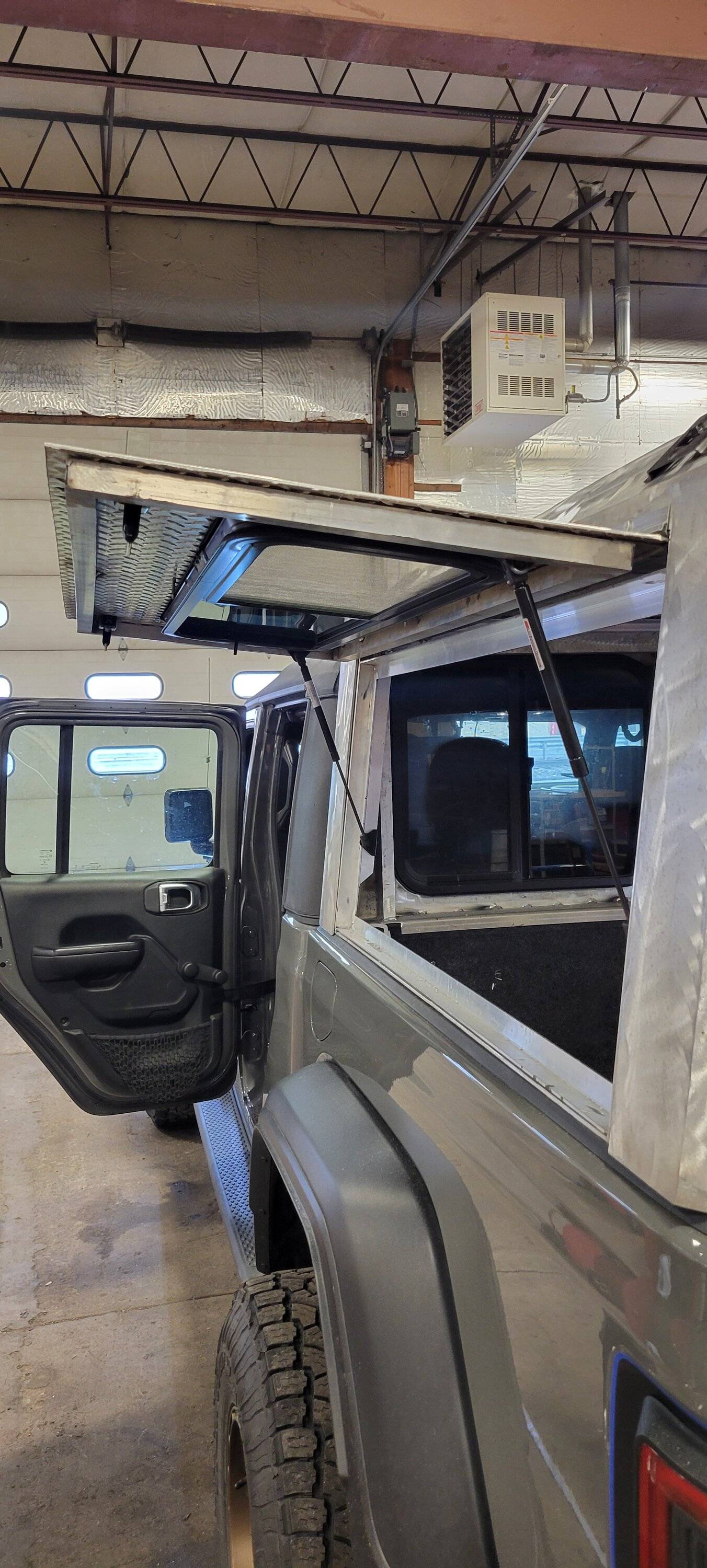

Took it to work and used the overhead crane to lift the top off. Wow... So easy. Got the driver's side struts mounted. They work perfect. Did some other little odds and ends in preparation to bedline it.
Jeep Gladiator My DIY bed cap 20240302_140306
Jeep Gladiator My DIY bed cap 20240302_143509

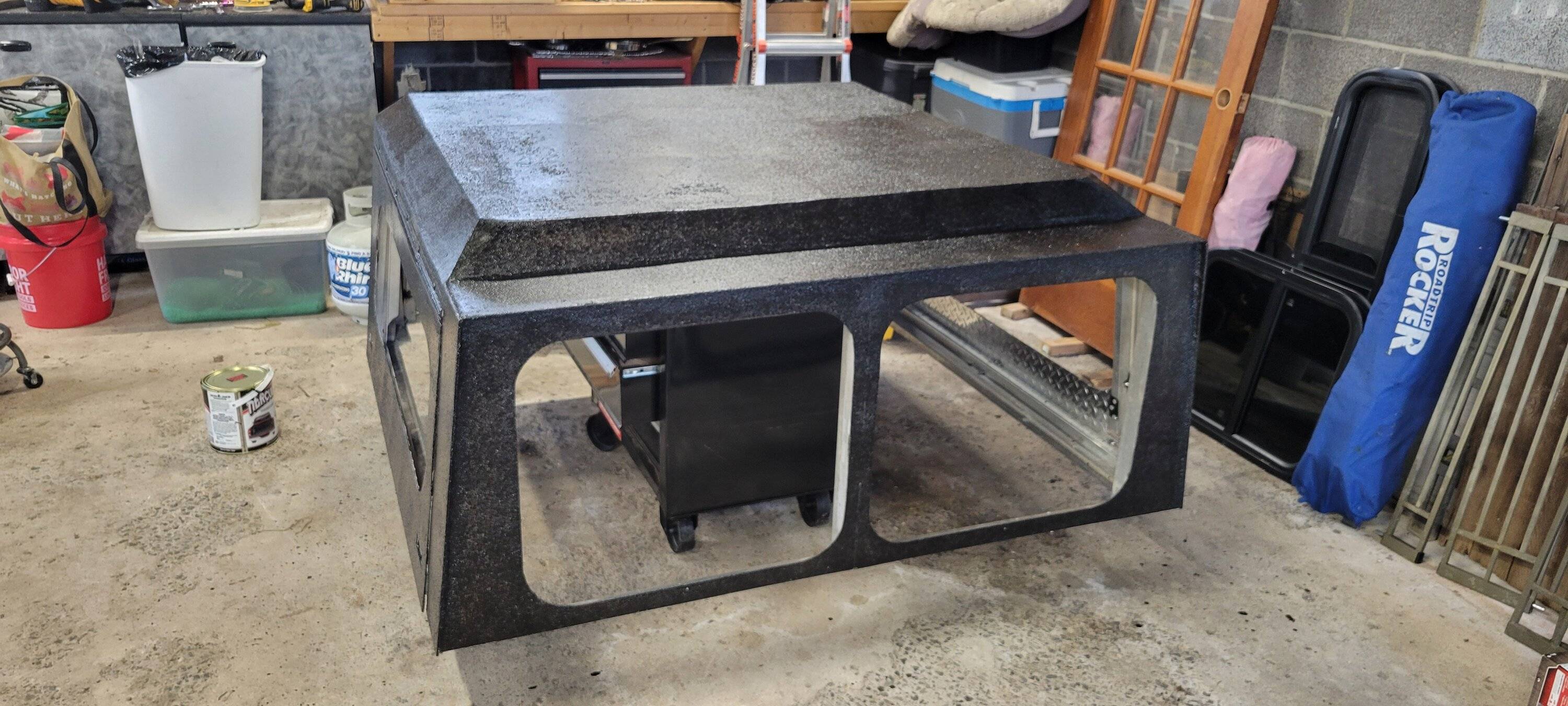

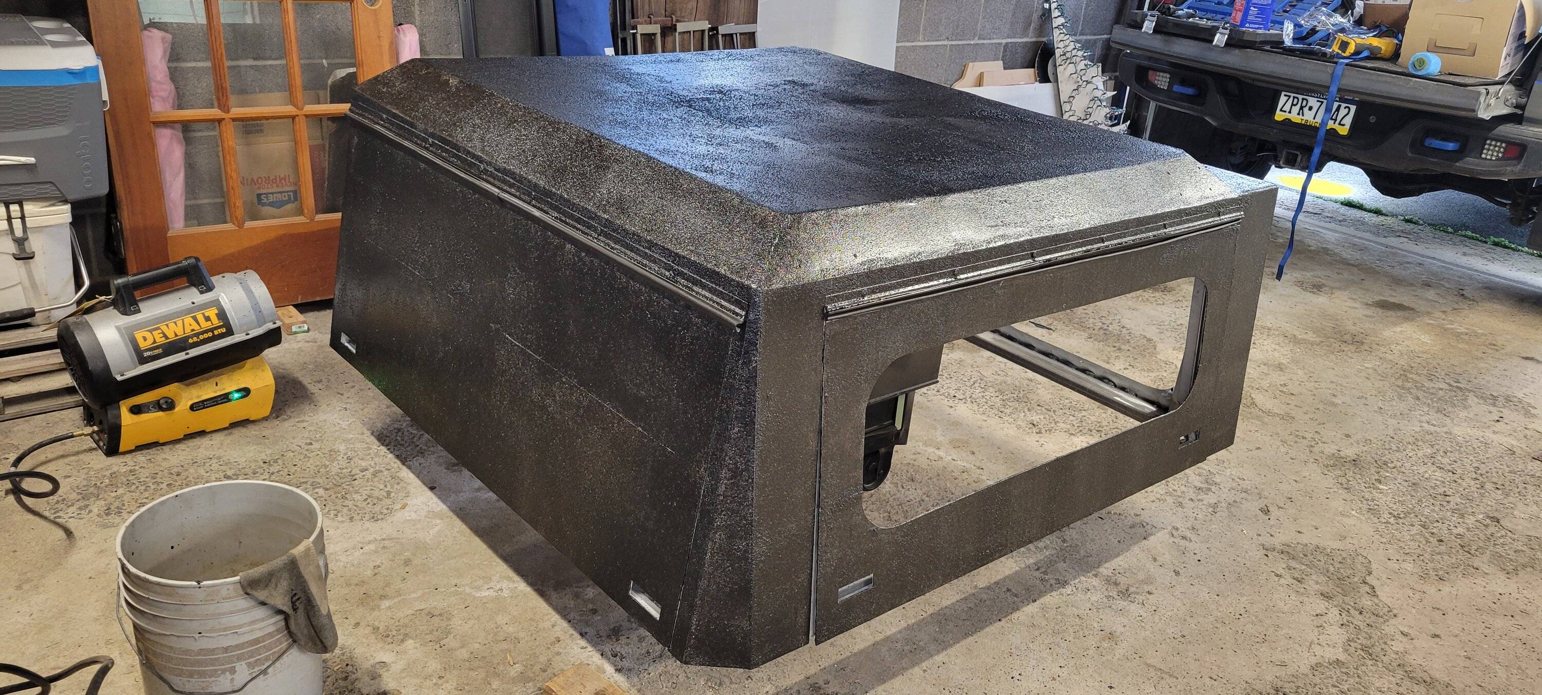

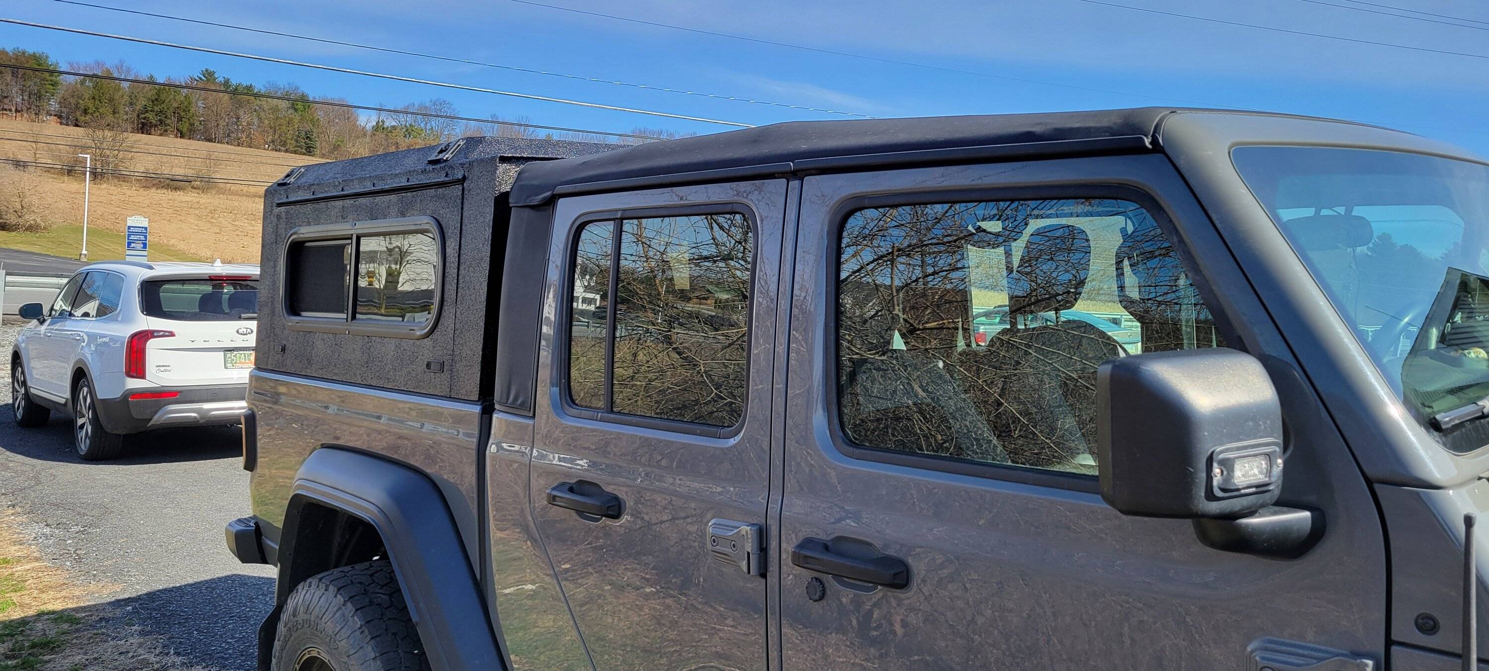

First coat of bedliner went on this morning. I'm waiting for it to set-up before applying a second coat. I am loving it so far. It should match the color and texture of the soft top pretty well, I think.
Jeep Gladiator My DIY bed cap 20240306_111106
Jeep Gladiator My DIY bed cap 20240306_111059

Thank you! And you are seeing the exact reason I decided to build my own. Granted, some of the options are impressive, but I have yet to see one that makes me say "damn, that looks good" in terms of fitting the body lines of the Jeep, especially with the soft top models. Mine is far from perfect, but I think it will work for my needs. I'm anxious to get working on the interior next.

Amazing work! Careful with the bedliner sticking to the aluminum...what did you do for prep?
Thank you! I used a heavy twisted wire wheel to scuff the entire surface, then wiped the entire thing with Acetone. I have a small torpedo heater underneath keeping the metal warm throughout the process to hopefully aid with adhesion.

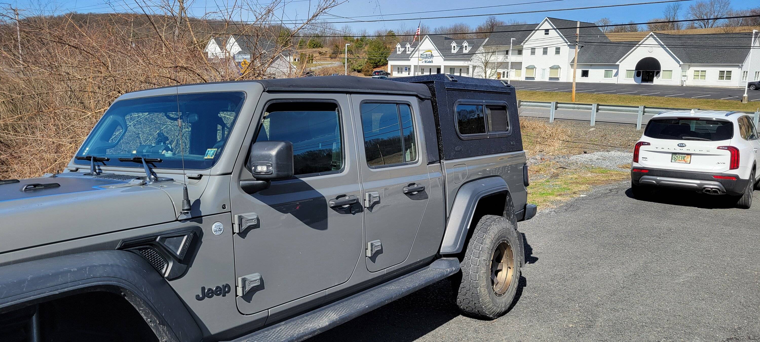

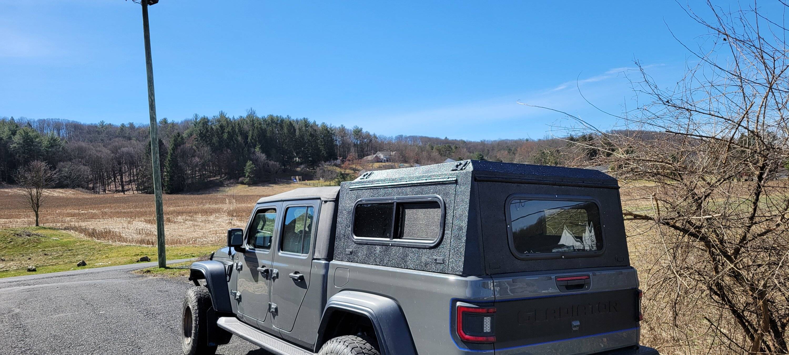

It's on!
Jeep Gladiator My DIY bed cap 20240308_111152
Jeep Gladiator My DIY bed cap 20240308_111140
Jeep Gladiator My DIY bed cap 20240308_111128

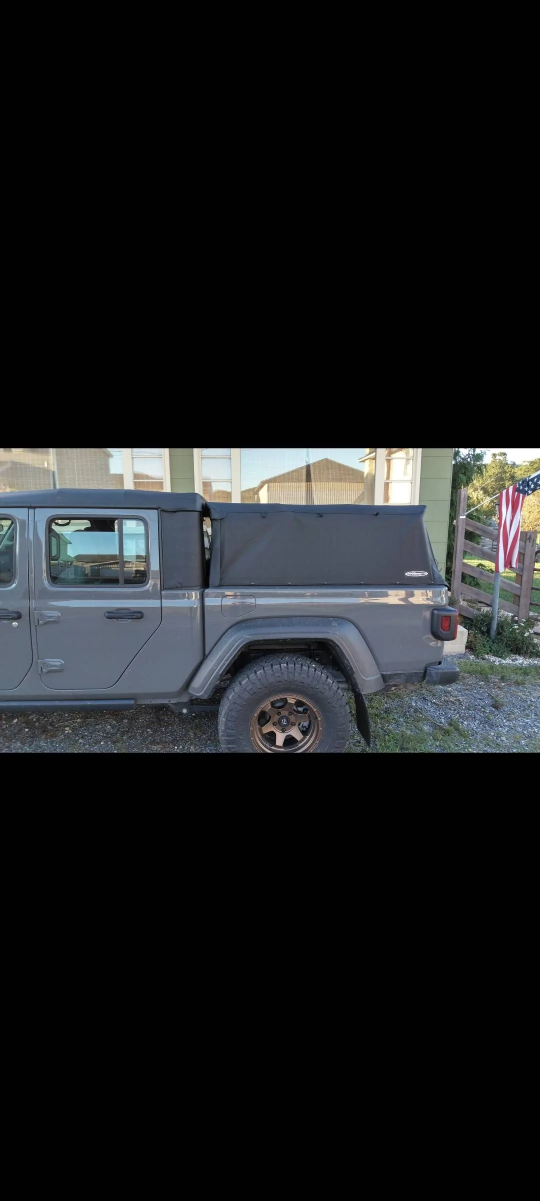

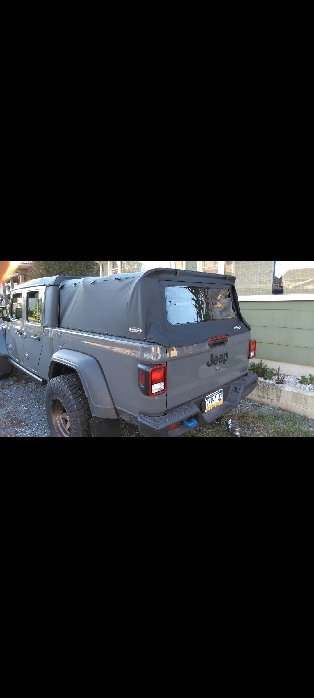

I guess I can put my tonneau cover and Softopper up for sale now, lol!

It's the Softopper branded model. I have the screened back window for it as well.
Someone will love that. I have the fas-top. Also have the screen option.

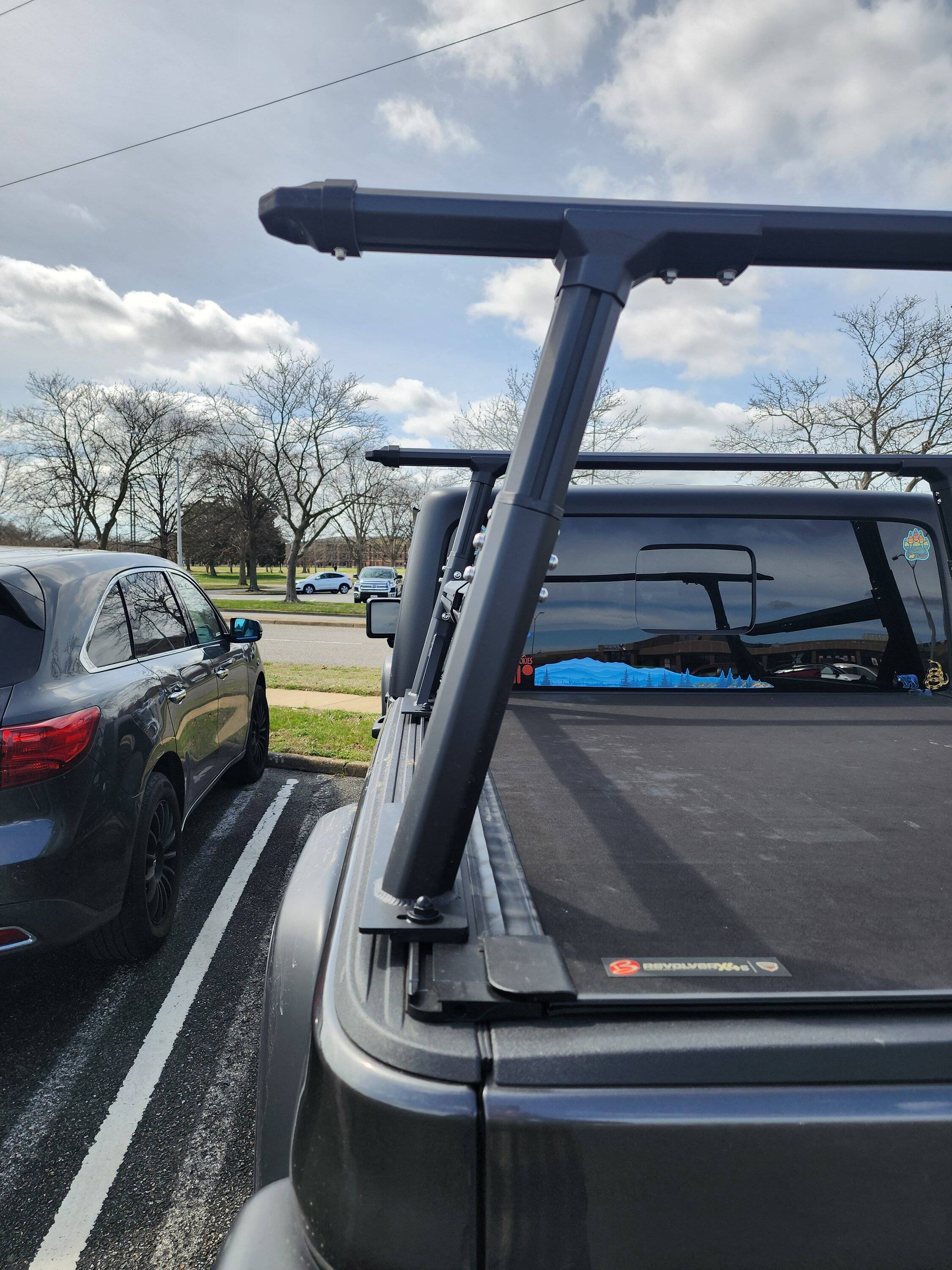

I do like that topper, wondering if I could make it work with my Rack, if I were to push it outboard, and increase the height ?.
What are you thinking about asking for it?
Jeep Gladiator My DIY bed cap 17099182948117648543201081896195
I was actually going to go that route before I decided to build an entire cap, except in reverse because I had the top and not the roof rack. I have it on the Marketplace for $600 but I would do $500 for a forum member.
