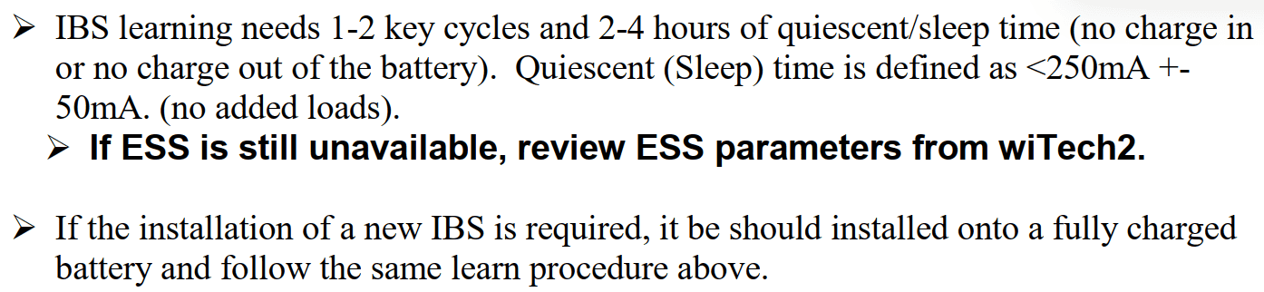

To reset it, you remove the IBS from the battery and and remove the ground clamp from the IBS and set the IBS aside.
Not sure where you got the touching the clamps together part.
But it likely reset by virtue of the fact you had it out of the truck and away from all power. That's how they get reset, lay it aside while charging the main/new battery, disconnected from the system. The small connector is the LIN network connection, how the IBS communicates to the BCM.
Jeep Gladiator My thoughts on the auxiliary battery 1703033983191
Lots of bad info out there.
proper procedure is to:
*Remove IBS from both the ground cables and the main battery negative terminal (touching clamps together isn't needed and doesn't do anything for the IBS)
*charge the main battery,
*Reinstall main battery if necessary,
*Reinstall IBS.
See above for how it relearns.............. 1 to 2 key cycles, 2 to 4 hours of quiet sleep time with no charge in or out of battery and minimal draw from battery (no added accessories running)
The bit about installation of a new IBS applies to reinstalling a reset IBS - on a fully charged battery.
*Reinstall IBS.
Touching the terminals together simply grounds out any possible sources of voltage that may be back feeding from the cabin, such as a USB charger in the cigarette lighter port or an aftermarket car stereo amplifier. IBS sensors only have surface mount capacitors that will drain out after a second or two of being shorted to ground.
The correct way is to follow the procedure that you listed, but it can be done my way as well.

I actually cringed reading the part where you touched the two cables together. Then I saw that you had both batteries disconnected. I thought for sure that your next sentence was going to be about the shower of sparks and now nothing works.
I'm glad it worked out for you. Good dral!
Yeah, I even read it twice to see that both batteries were out.
Just so much easier and safer to take it off the cables and battery - then it's reset.
Once you take it off the battery and the ground cable, it's dead.
Someone is going to forget or misunderstand and blow things up some day.

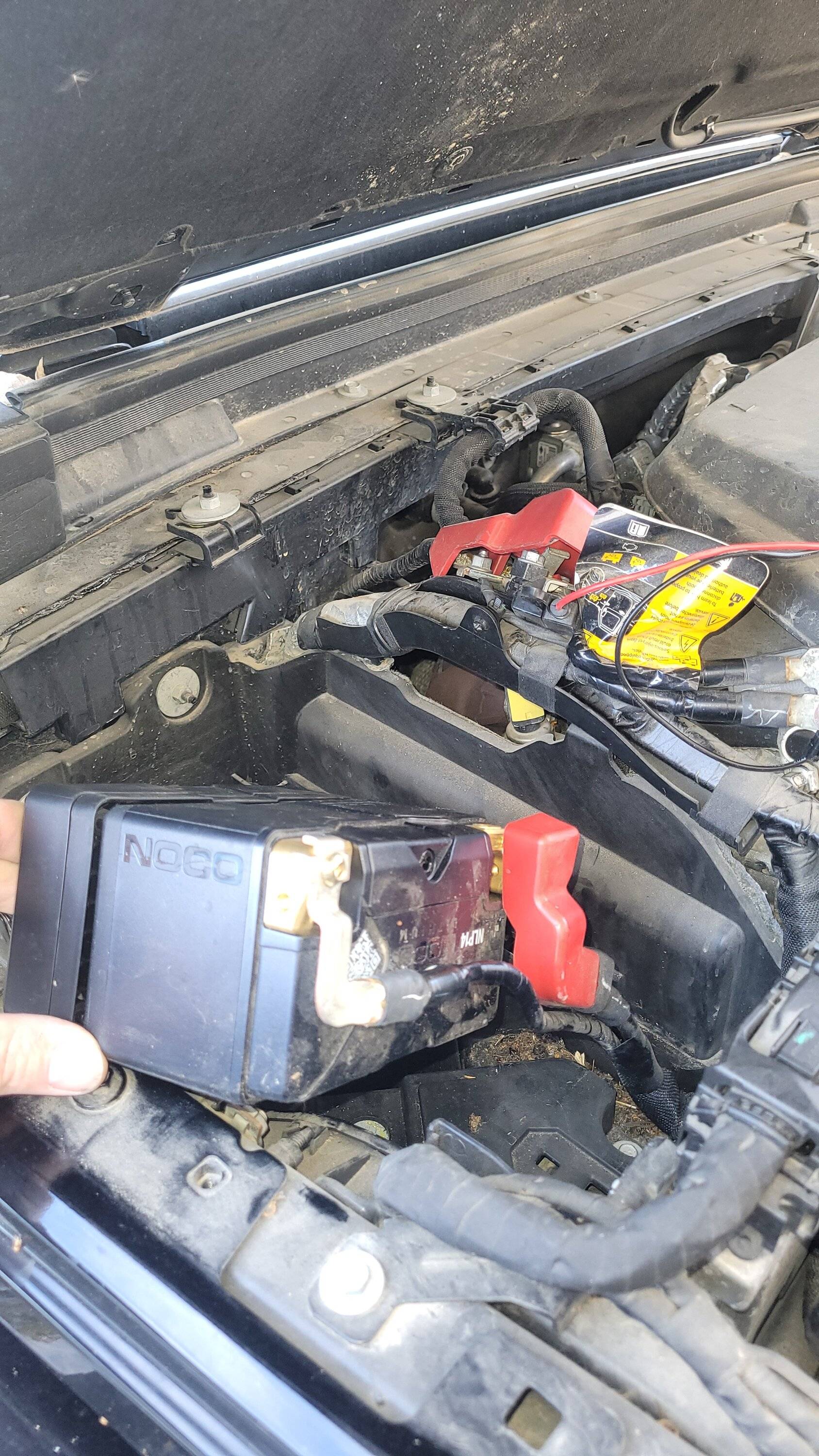

In my case, the AUX battery has failed on me both times coming into cold weather. I replaced both batteries as a precaution the first time but that main battery lives on 'til this day in my Grand Cherokee with no issues. I replaced the AUX battery with an ES-TX14-BS motorcycle battery the first time due to availability issues with the AUX14 battery (Same guts, nut and bolt posts instead of stud posts). No more issues and ESS readily available through fall of this year. Original AUX battery tested bad.
This week I started getting getting Aux switches unavailable errors again any time I hadn't ran it or had it on the trickle charger for more than 24 hours. Main battery tested good, AUX battery needed charging but tested good afterwards. I threw it in my motorcycle and haven't had any issues cold starting it with that battery so it seems to have nearly all its rated CCA still available.
This time around, I decided to try out a theory that I had and installed a NOCO NLP14 LiFePO4 battery in the AUX battery position. My theory is that when cold weather hits and possibly even in warmer weather, the charge profile for low temperatures is correct for the main battery but is too conservative for the AUX battery and the computer ends up holding it at a lower than ideal voltage. This fatigues the battery over time and shortens the life a battery that is probably designed for a 3-5 year service life in the best case.
What should make the NLP14 special is the fact that it is a retrofit Lithium battery that has a charge controller that is programmed to simulate an AGM lead acid battery. This should mean it can be connected in the same way with no modifications to the truck and the charge voltages will be compatible.
The internal charge controller should regulate the battery separate from what the PCM is doing with the main battery, allowing it to basically protect itself.
I installed the NLP14 a week ago and reset the IBS, and after it relearned my ESS has been showing ready as soon as it was up to full temperature. I have had it stop the motor for 2 minutes at a light, then stop again a few blocks down the road so capacity doesn't seem to be an issue. After sitting for 48 hours, there was no abnormal issues with voltages at startup and no extended wait times for the ESS to become ready.
Unless there is a very slow draw between the batteries that shows itself after weeks of sitting, I don't see any reason why this setup wouldn't have superior reliability to the AGM battery for the same price (-ish) as an AUX14.

It looks like you’ve a diesel as do I. I just swapped this out after both my main and aux batteries were bad. I’m. Or getting an ESS unavailable and to service after it charges enough. I think I need to reset the IBS to read it again because it was working. I’m curious if you’ve had good luck or any issues and did you charg the batteries separately or other when you topped them off? Let me know how it’s going.
When I replaced my batteries, I charged each new one individually on my trickle charger until it registered a full charge/float charge, then installed them. You should unplug the IBS for a few minutes to reset it as well.
As far as my current situation, the NOCO battery has been doing well. Once I put a few miles on it, ESS becomes ready and seems to work even after repeated uses.
Thanks for the info. I had topped off my old primary and the aux battery separate till full outside of the truck, but was told the primary was good when tested originally. When I took it in to the dealer they tested both originals were bad and the truck sat while I ordered a better primary battery and I’m sure that drained off the noco. It’s showing a service light for the ESS if it tries to charge and I’m sure that and an IBS reset will do it. I appreciate it!
