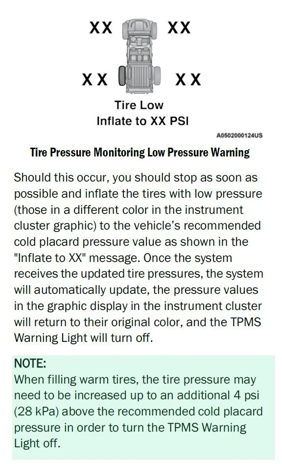

Well in my situation it was triggered when I went to the beach 2 weeks ago at 15 PSI (no issue before that)...Generally, I like to run them 33-35 cold so I should be able to stay above the 29 psi trigger (now that I know what it is)...Of course as seasons change I either add or subtract as needed to keep it there...Simple fix now that Nacho and JT1 clarified how the algorithm works.
29? On my truck the factory setting is 37 PSI.

To be clear, I said according to a poster above, the Low pressure alarm kicks off at 29#, I didn't say I run my Mo at that. Yes 37 is the factory spec. Two different items.

As mentioned previously, you may have to inflate the tires ABOVE the recommended pressures to get the light and warning to clear.
We found this out the very first time we aired back up on the end of a trail.
37 and the light stayed on.
Had to go to something like 42 to clear and then I could air back down to my usual 34 with no issues.

42!, wow, wha'samadder with these Nanny's these days? ? How long did you have to stay at 42 for it to clear (in time/or miles)?
