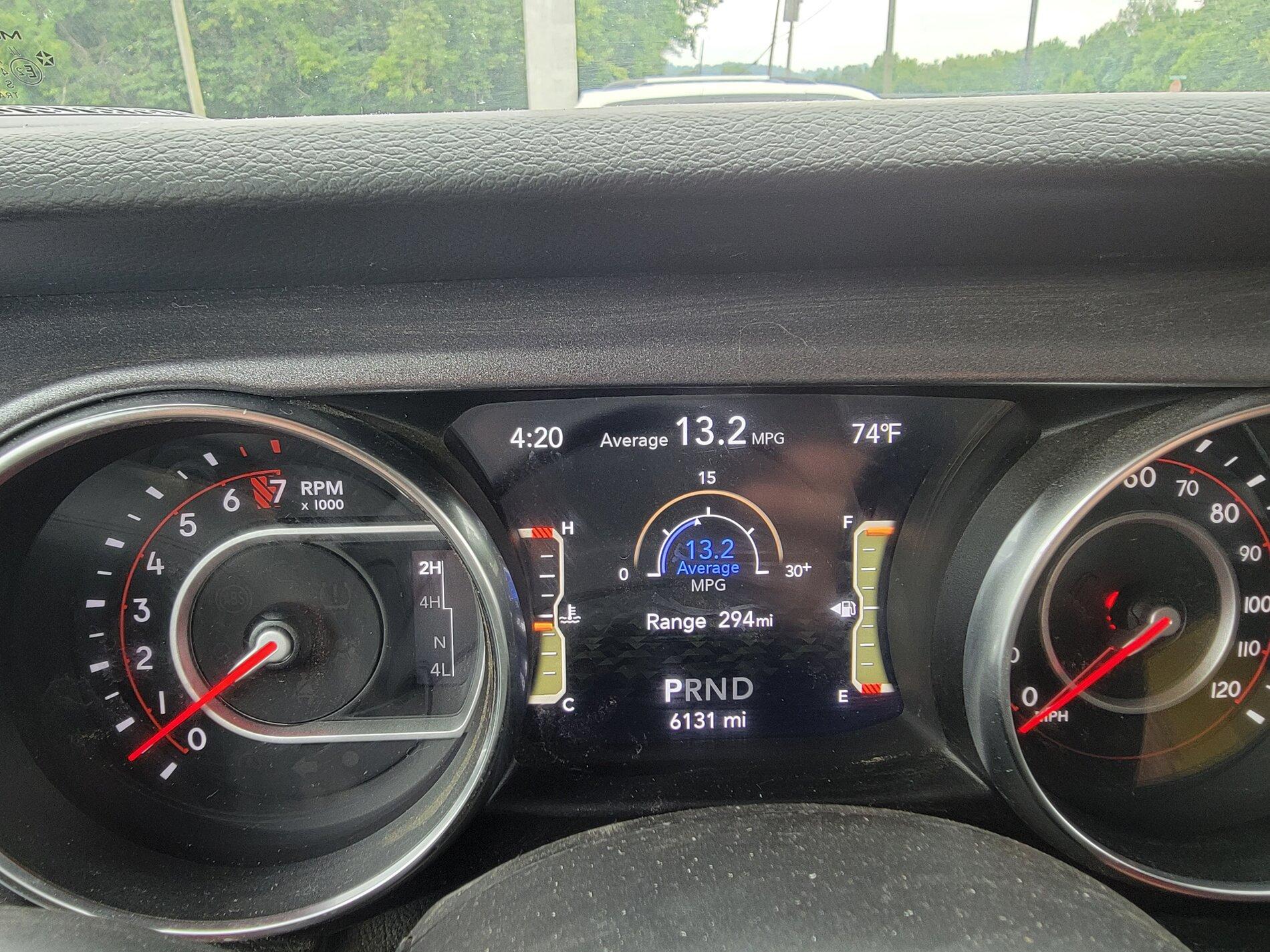

I think my short trips are whats getting me. That was one reason I didnt get diesel I knew those were bad for them. Its crazy the mpg difference between the models. People towing are getting better than what I am getting taking it easy. I just dunno.

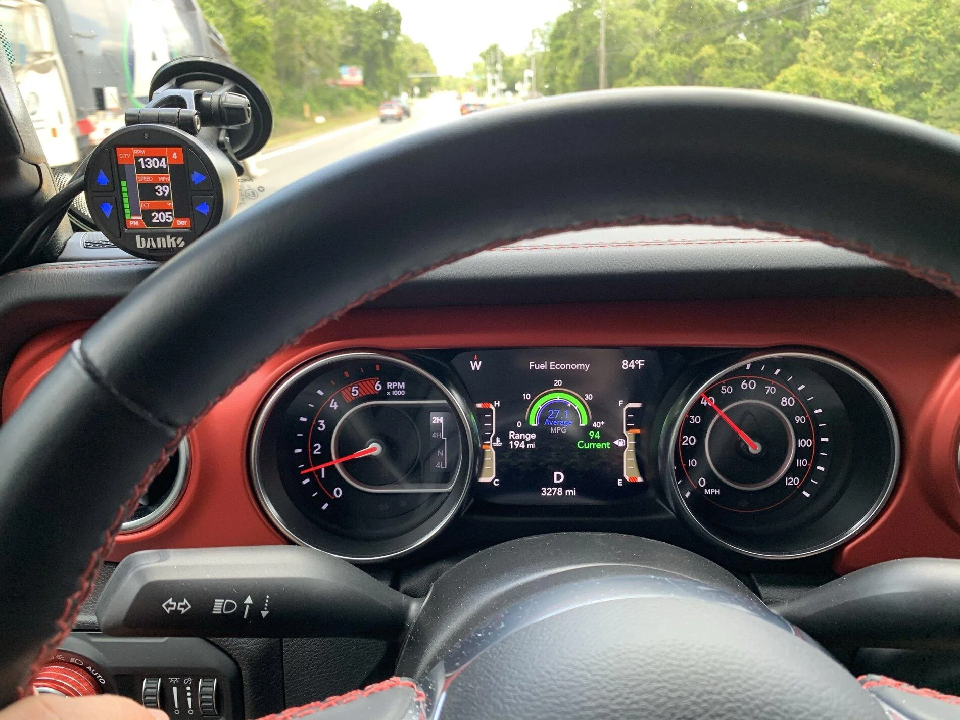

on 37s with Banks system. It is real
Hey, Thank you for sharing what you are getting mpg with the Banks!!!! I was wanting to get it but didn't want to take a huge hut in milage. Now I know I won't... Thanks man!!

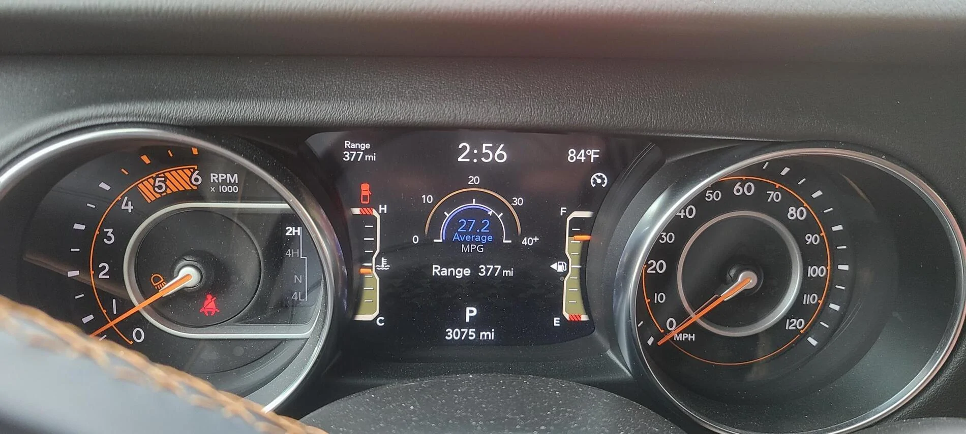

My first 4581 miles I averaged 27.5 miles per gallon. Highest one trip average 31.2 had a decent up hill starting at 4100ft up to 8k Downhill to almost seal level. The rest of that trip was mostly flat driving. On the way back. Flat land mostly ran around 28 hit the up hill to 8k dropped to 25 and back down to 4100 and home. Average went back up to 28.7 this was all via the dash board. I did hand calculate some of it during drip and my calculations were about 1.5 mpg lower than dash.
