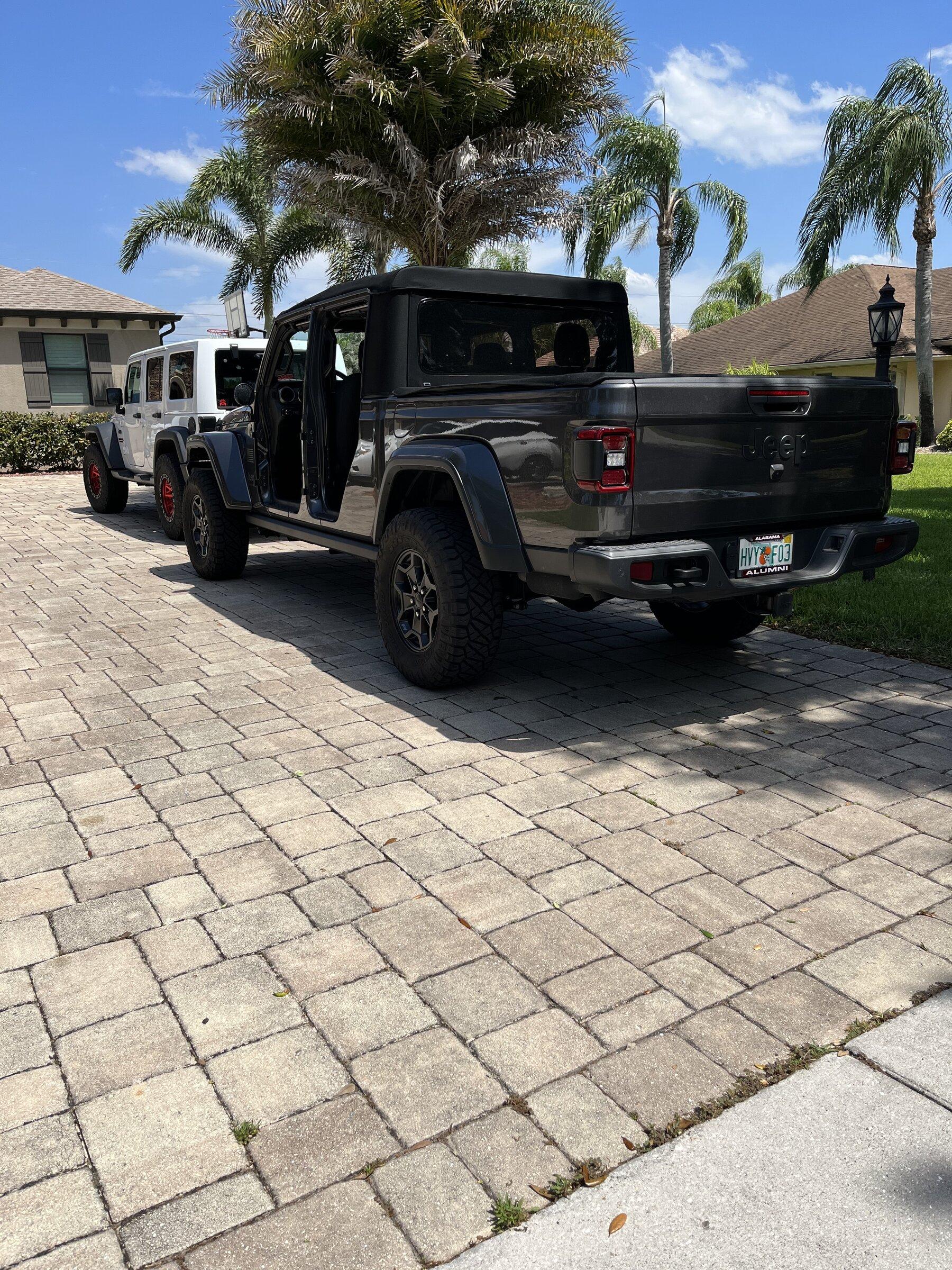

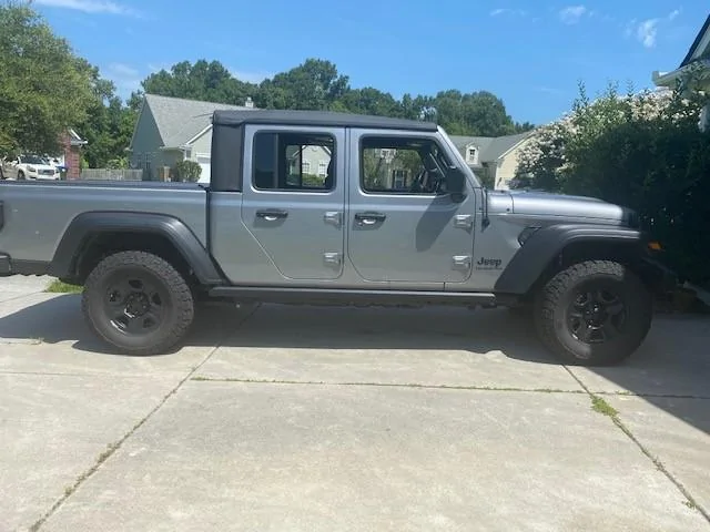

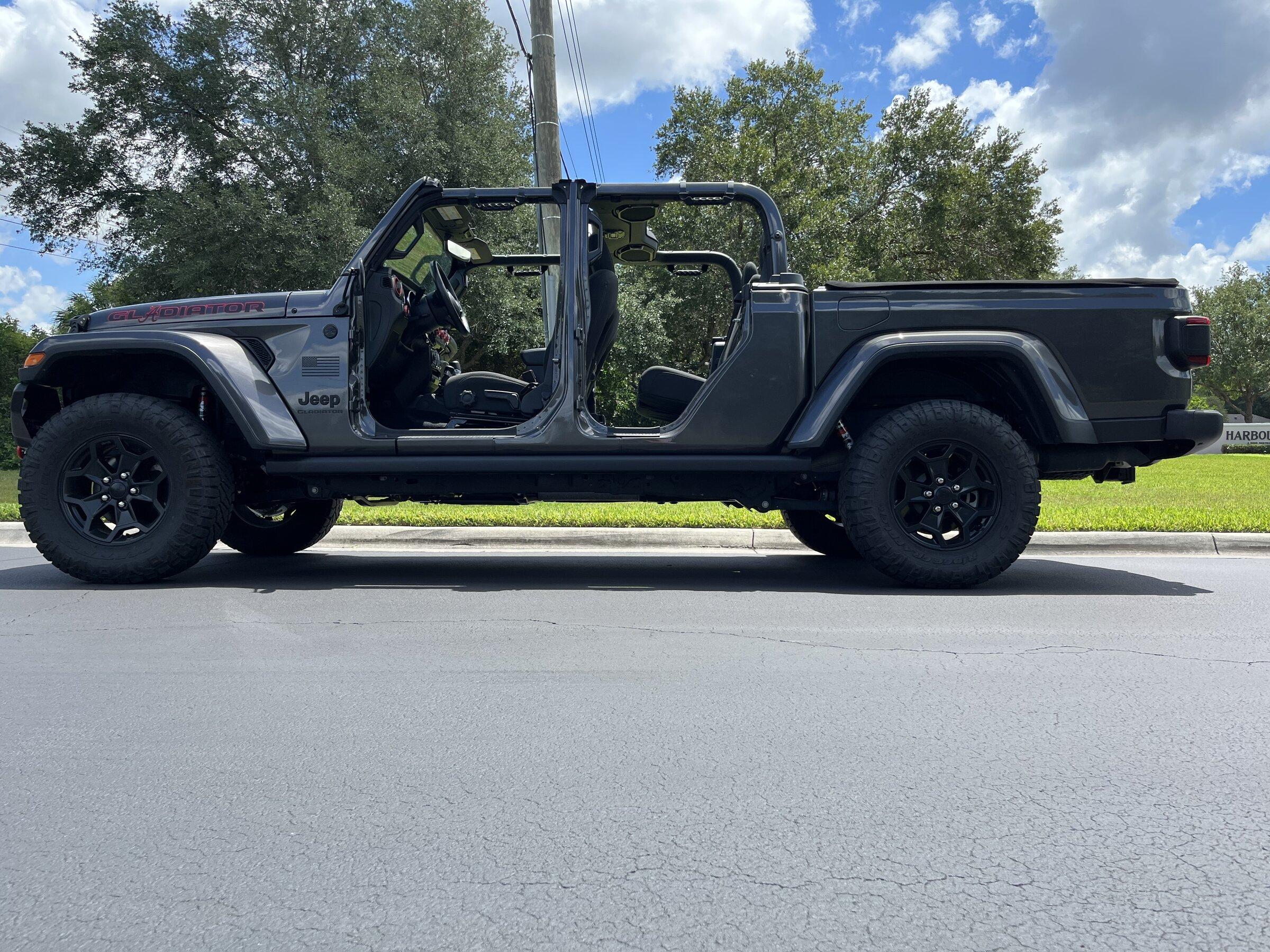

I did the Rough Country 2.5” spacer lift with shock extensions and the Daystar 3/4” rear spacer. I kept my stock Willys springs but swapped out the Willys red shocks for Rubicon shocks. Less than $400 into this set up and I am quite pleased. Rides better than stock IMO. The Rubicon shocks made a big difference. Pics attached for reference.
