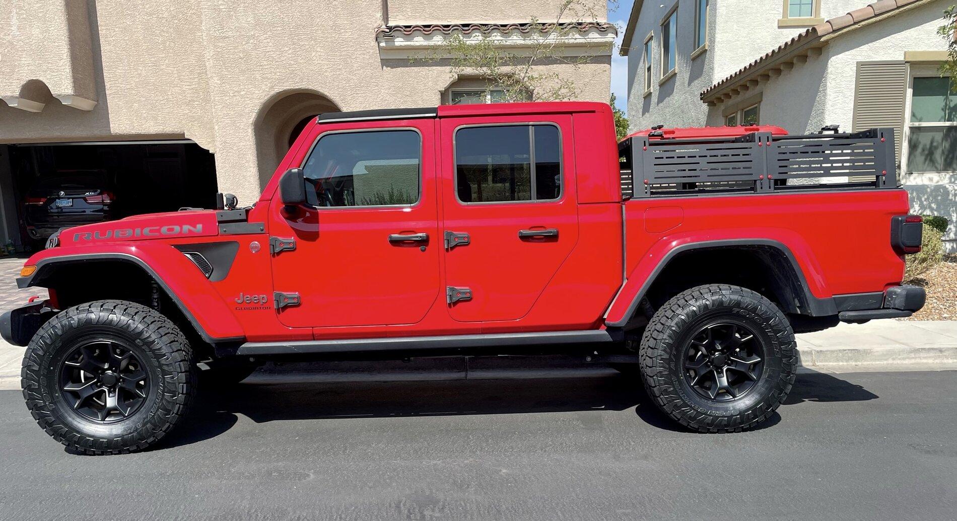

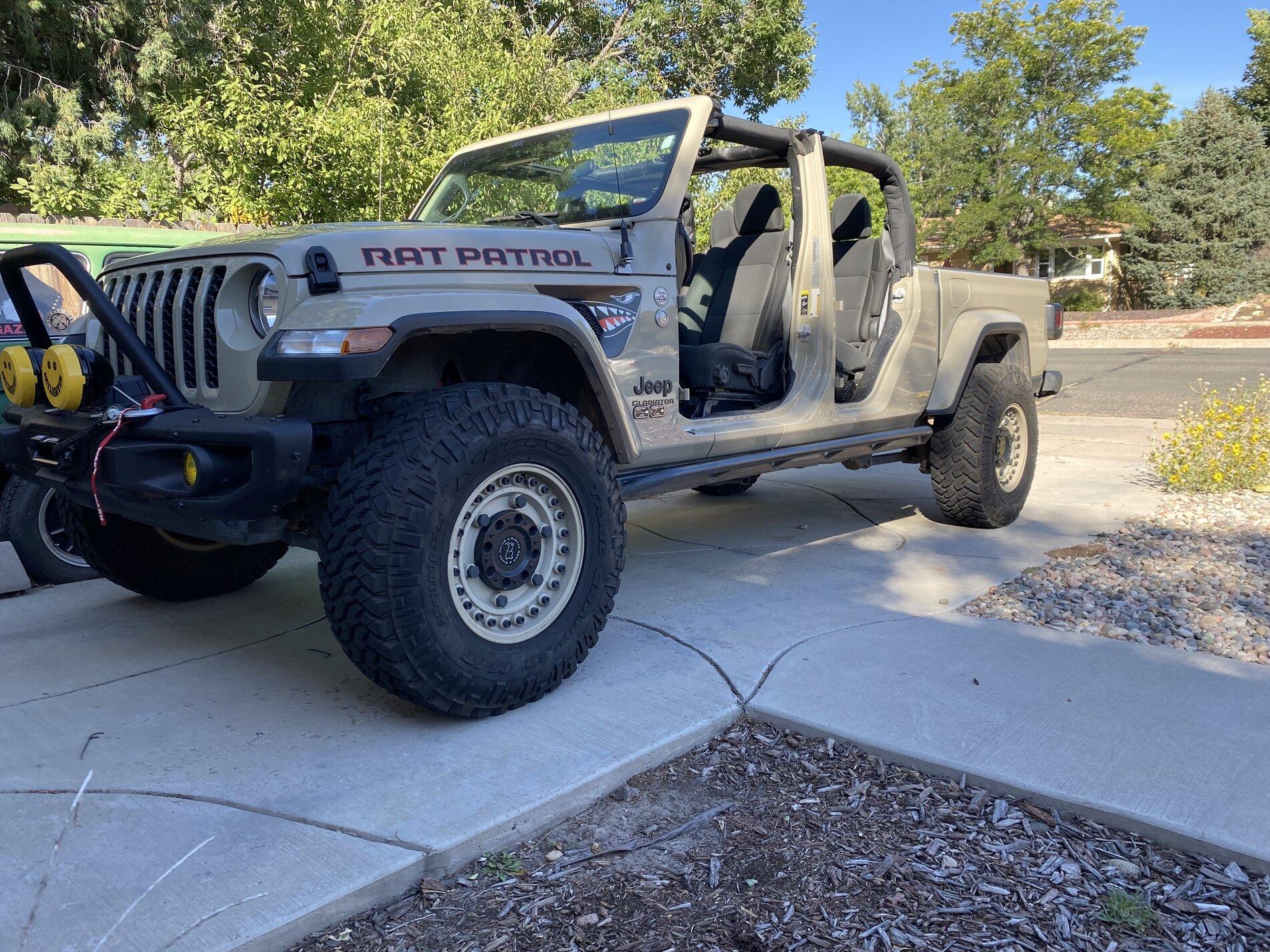

Although not the beadlock look…..I went with these from Quadratec:
Jeep Gladiator Need rim advice. 31E8D404-E1A4-4ACC-9A38-769202DC9B32
I have 35x12.5r17 Toyo AT3’s.
For the price, any Trail damage won’t hurt (as much) and I dig the look.
Good luck on your search!

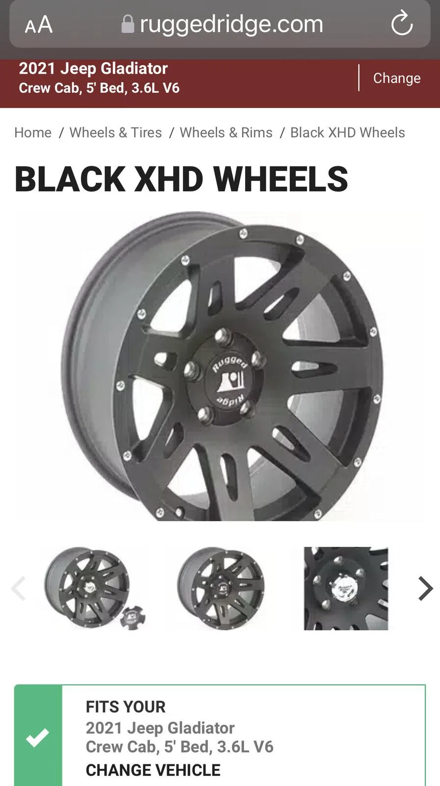

Id recommend these:
Jeep Gladiator Need rim advice. FA0F448E-72B2-47D9-9816-EBE84102D1D5
17x9
I ran them on my JK. Liked them a lot.

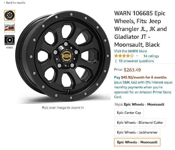

The Warn Moonsault might get you the look you want, with a 0 offset will get you a wider stance, but not look too extreme in my opinion. It's somewhat close to the Recon package you refer too although obviously not a 100% match.

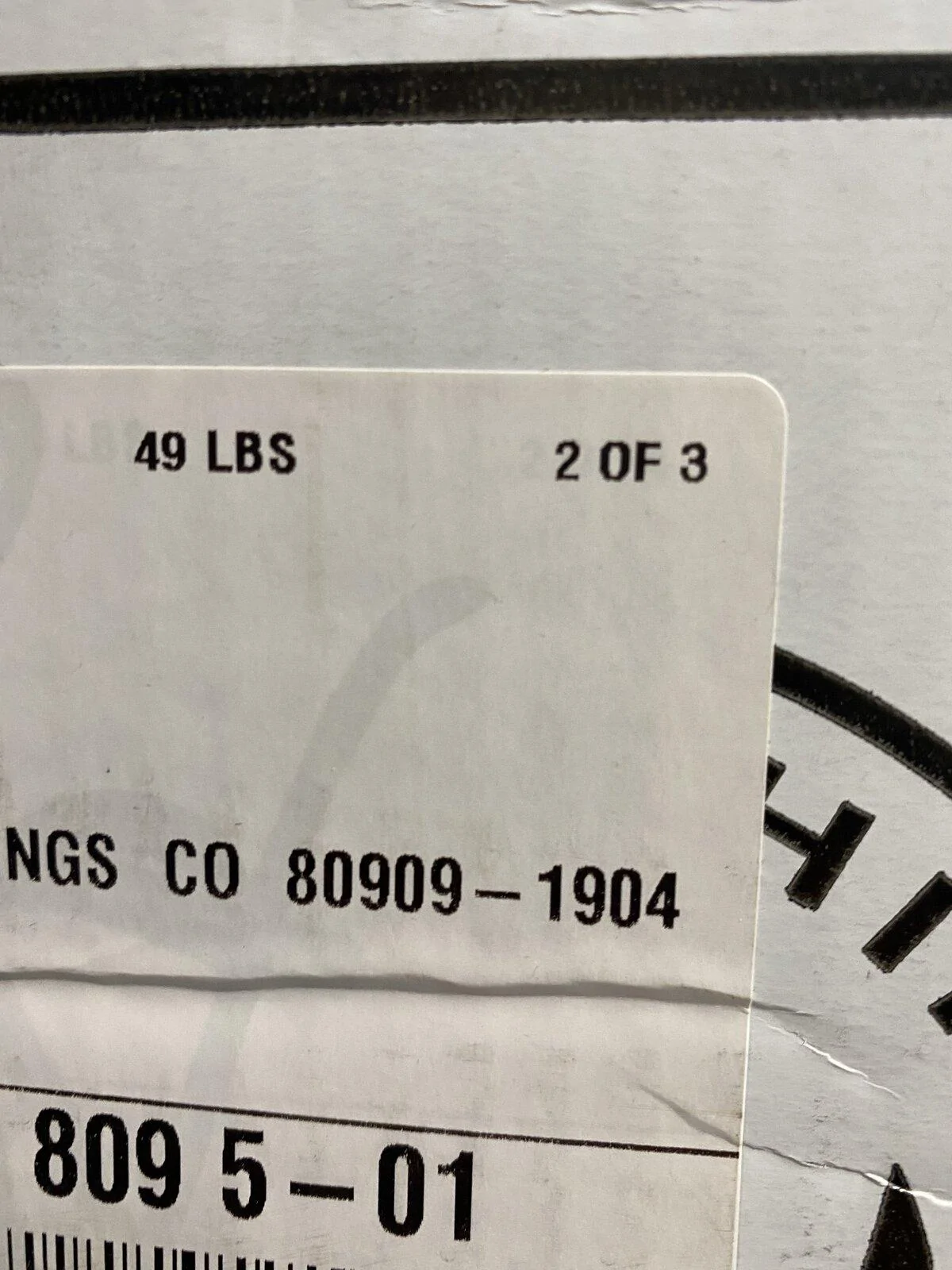

I have the Black Rhino Armory. They look cool. However.....
1. Heavy. 40 pounds each. Website says 35 pounds...in box weight is 49 pounds.
2. Fading of the paint less than one year in. To me they skimped on the paint.
3. Chewed up after a season of wheeling.
4. Center cap is plastic. Will end up cracked or broken.....
Probably would not buy them again.

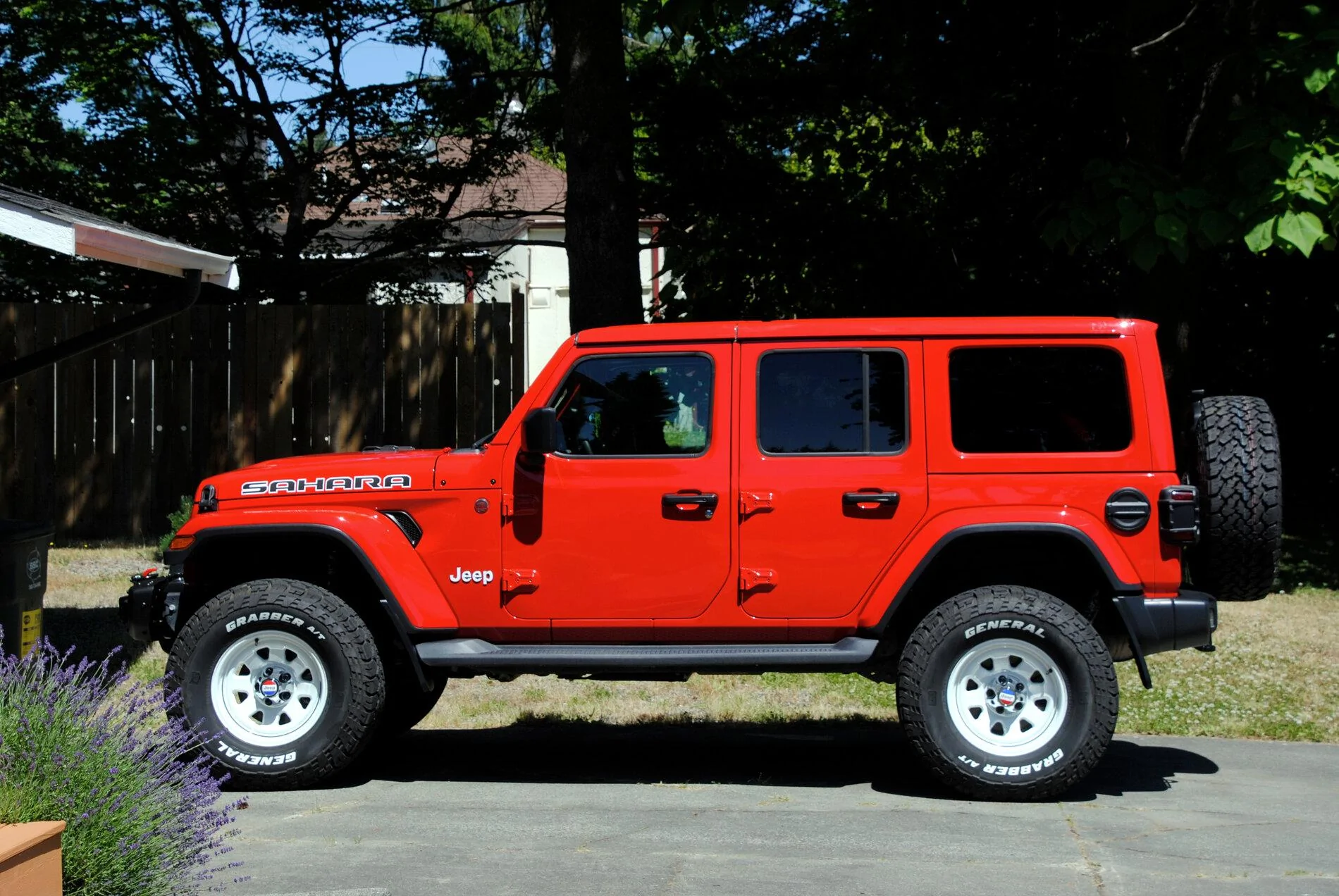

I too am a big fan of Quadratec’s line of wheels, designed to retain the factory look, with Jeep bolt pattern and offset to clear 12.5-wide tires. They are very well made, lightweight (25-27 lbs each), and offer excellent bang for your buck.
https://www.quadratec.com/brand/qua...bahoGRMTliF8FQLxNT-sAtFxUS4ALiasaAoNDEALw_wcB

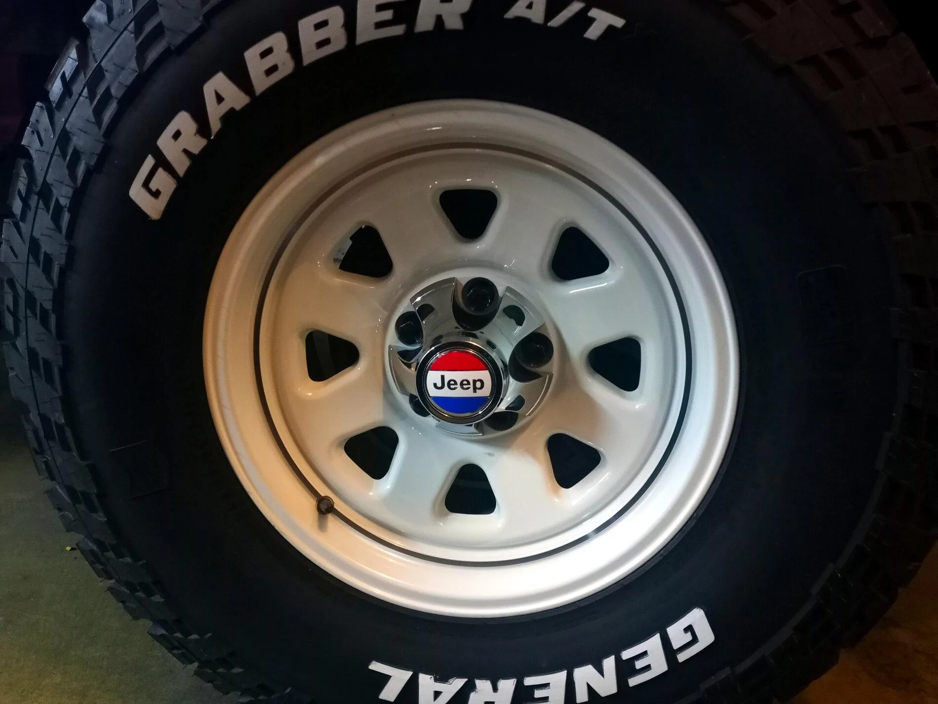

Currently I have their 17x8.5” CJ Retro Alloys in white, with custom made hub decals. They resemble Jeep wheels of the 1970s and get compliments from total strangers.
