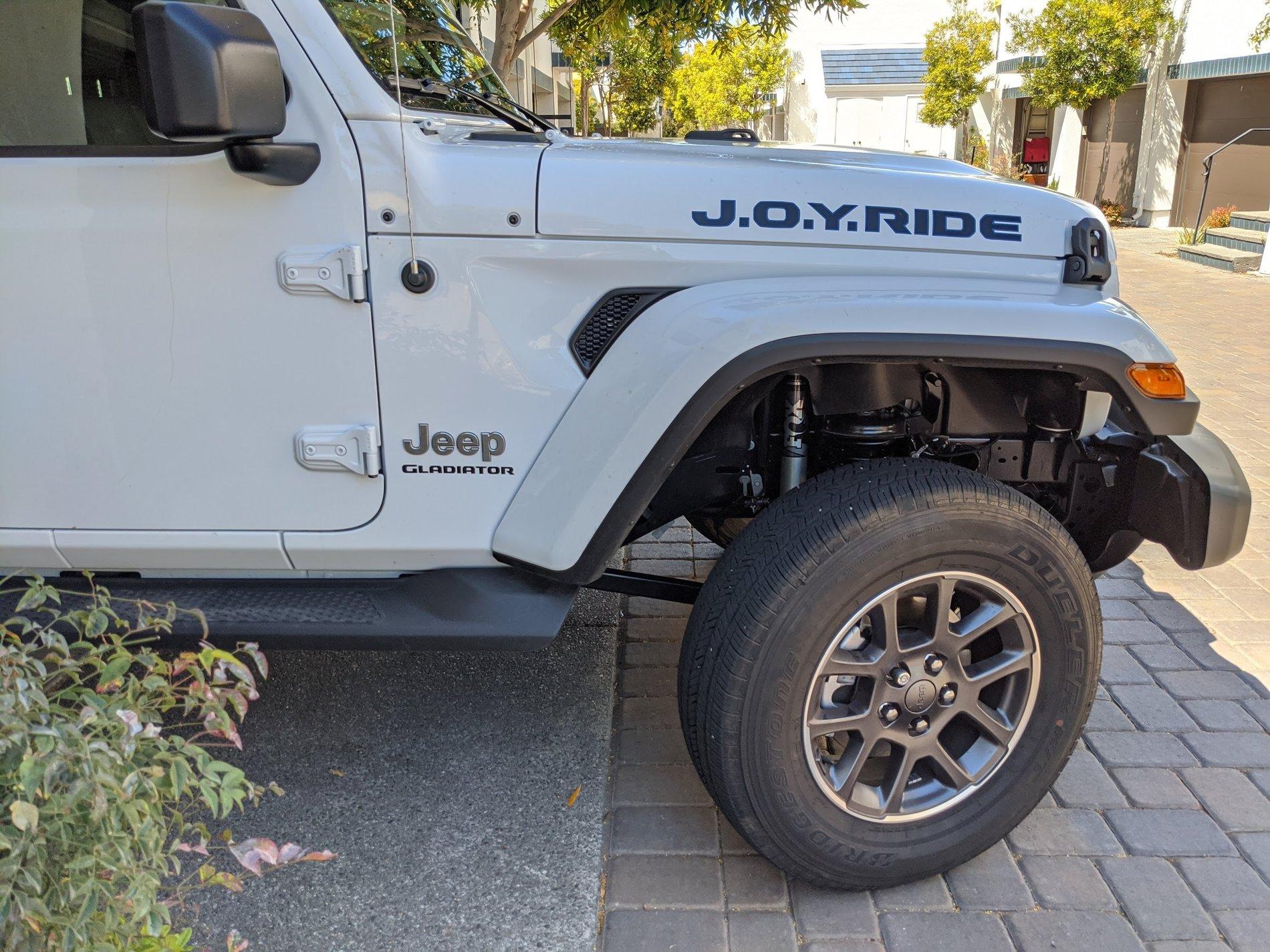

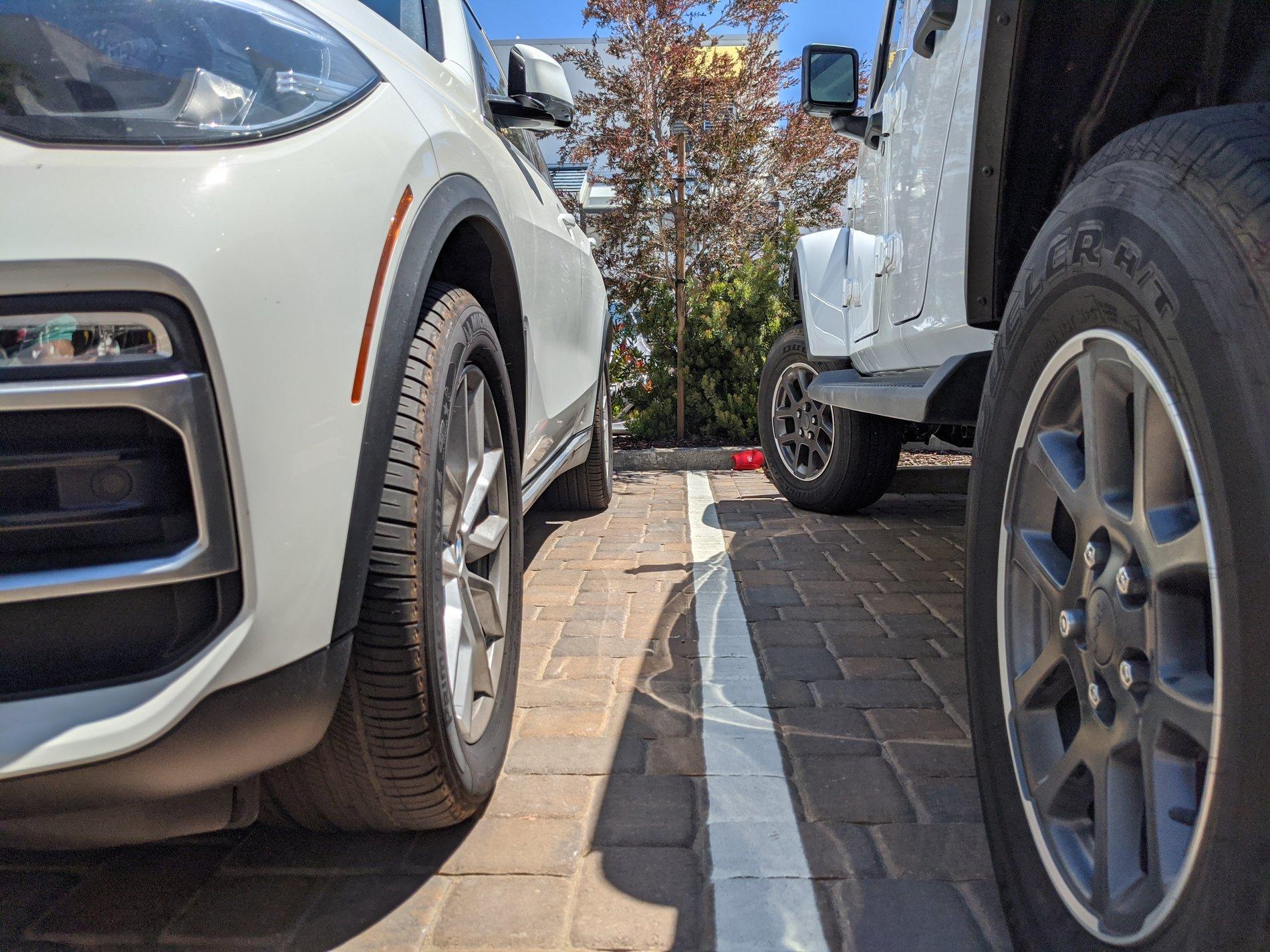

So some kits I have seen people complain that their 2" lift is more like 1.5". Or a 2.5" is more like 2".
This 2.5" gave me 3.5-4". With settling in, with adding in a bed rack and rock rails and bumper I have no doubt it will end as a true 2.5" or even more. I am 6'2" and the bed is at my sternum. The running boards are in the middle of the door of an X5 I parked next to.
My mechanic did ask 'wow what size lift is that anyways' when he saw the springs, 'those are huge!'
I went through both sections that always gave me trouble before, the Caldecot Tunnel west bound and 92W in San Mateo. The tunnel was great, never got into a bouncing rhythm where it felt like I had to break to control the truck. Soaked it up and rebounded quick enough to never have any issues.
On 92W which is a longer stretch of basically small woops it did rhythm with it but it was in far more control than stock.
WAY firmer ride and not at all soft. Very happy.
35" Ridge Grapplers going on next week will complete the ride and look. For now, skipping leg day.
I will show side by side measurements I took at the bumpers and wheel wells. Gimme a min to compile it.

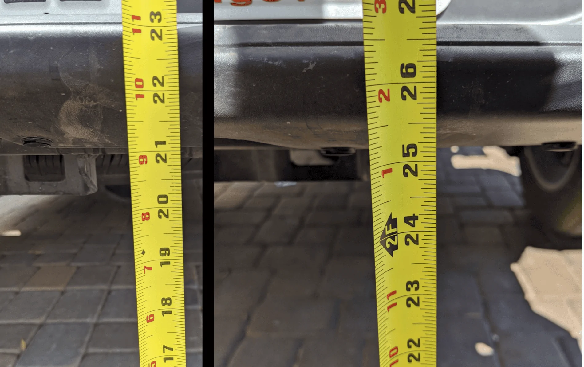

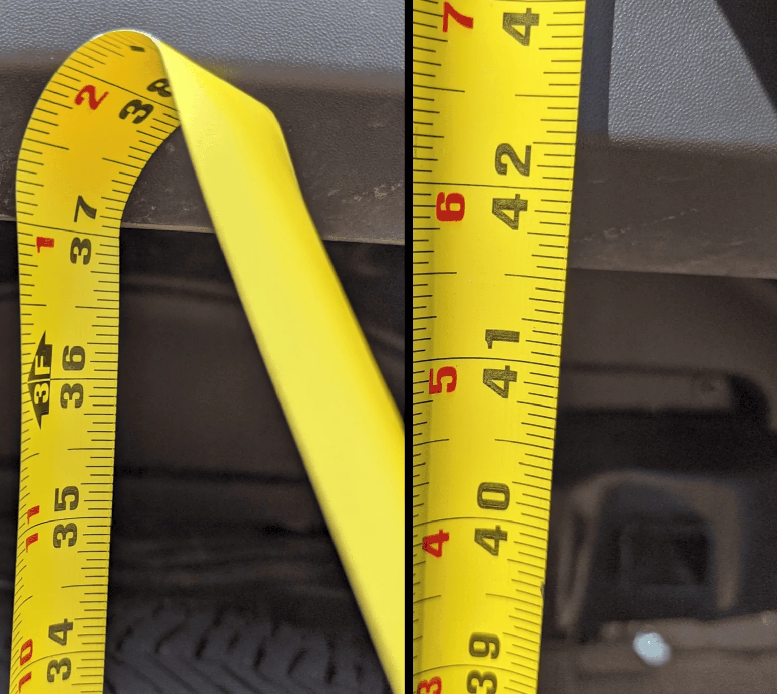

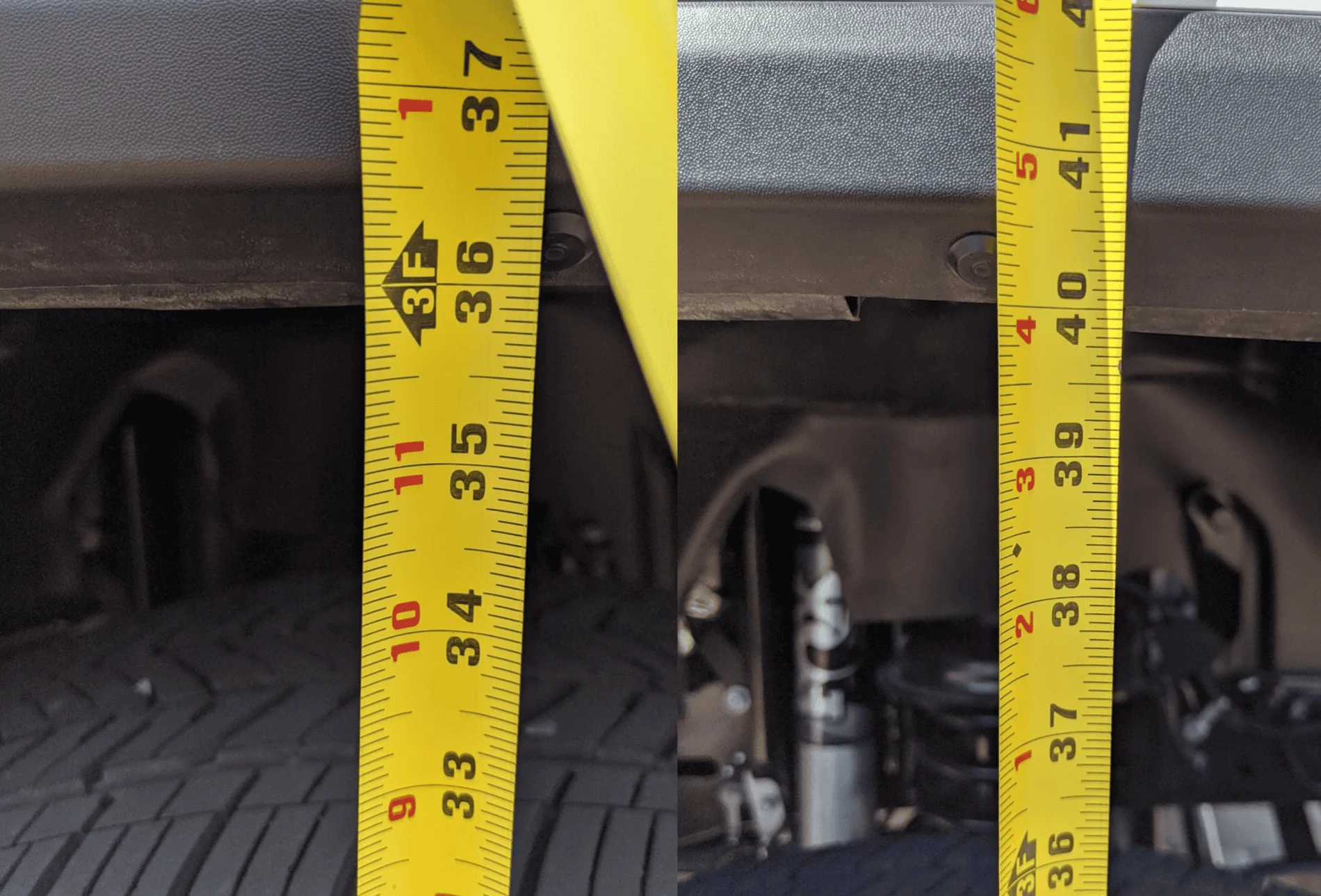

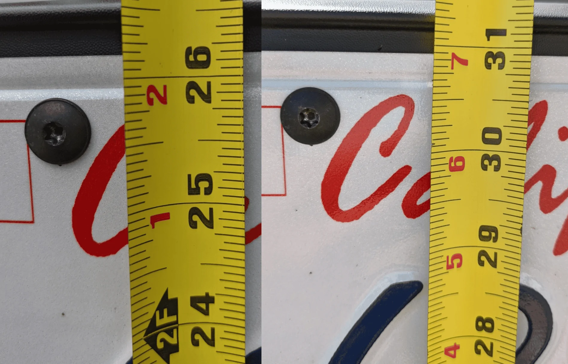

I know the photo angles are off a little bit between some of the shots esp the rear bumper. But this thing is a big lift.
Rear bumper. From ~ 23 to ~ 26.75. +3.75"

Rear fender. From, 37 to 41.5" + 4.5"

Front fender. A hair under 36 to hair over 40. +4.x"

Front plate from ~26.375" to 30.875" + 4.5"
