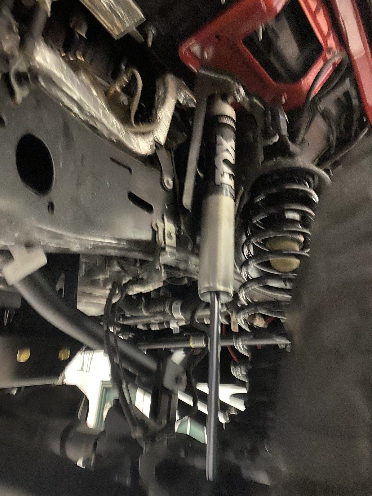

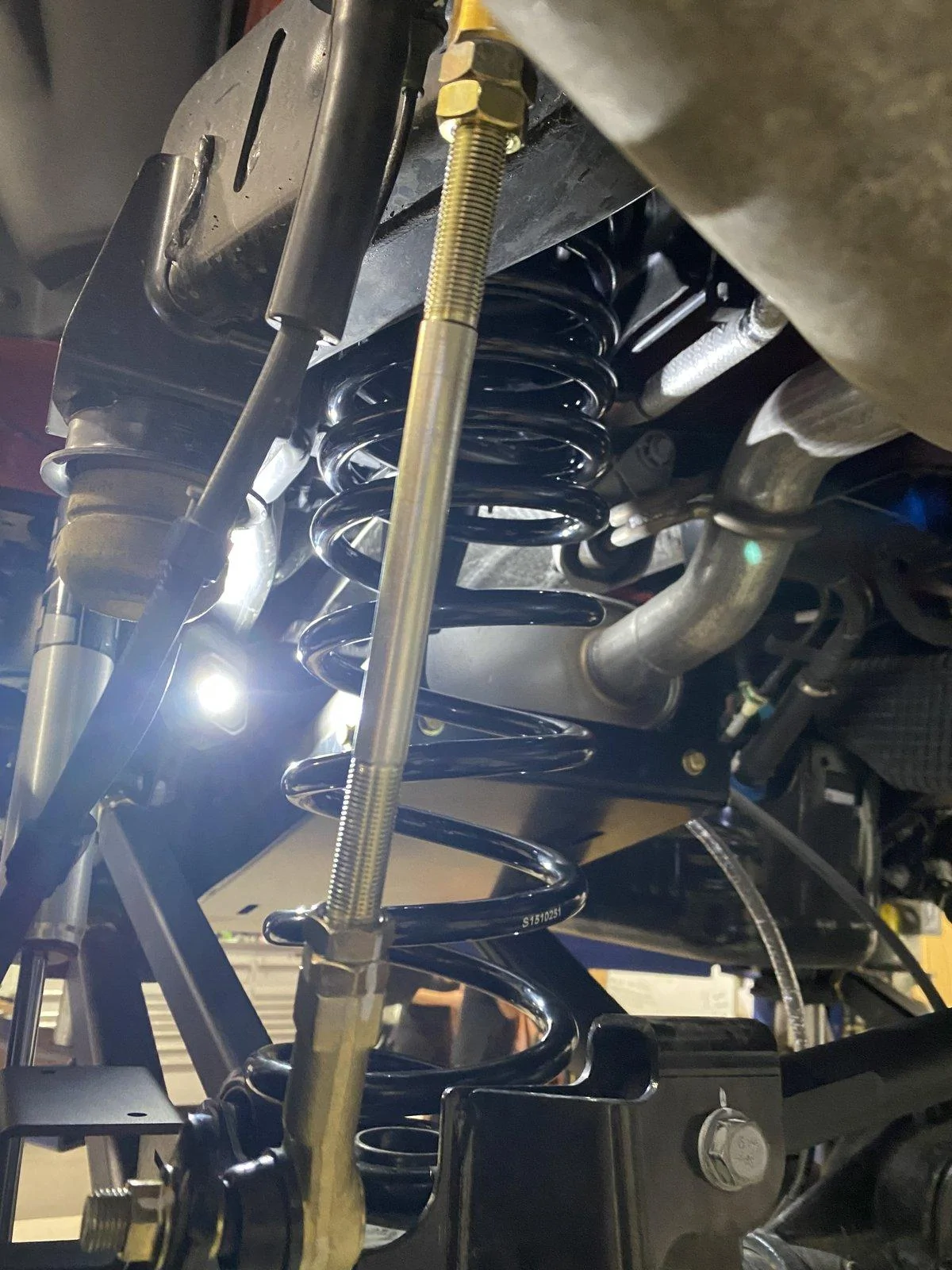

re: did it stay centered... It's certainly possible to setup an adjustable system poorly and have it not be on center. By my eye I am like 1/8" off up front but it's hard to know if the wheels are perfectly straight without an alignment machine, it could be off due to the slight turn of a tire and not measure from dead center. The rear is easier to tell, it could be a hair more aligned, but after about 500 miles I am going to take some more measurements of stuff like that and if it's settling and shifting he will adjust it for me. Benefit of the rear is without having to mess with the steering it can be done easily at home.
You can get it setup spot on day 1 and have it drift over the first few months due to settling anyhow.
Best answer is YMMV with any kit. Just watch it the first few months is what I'd say.
