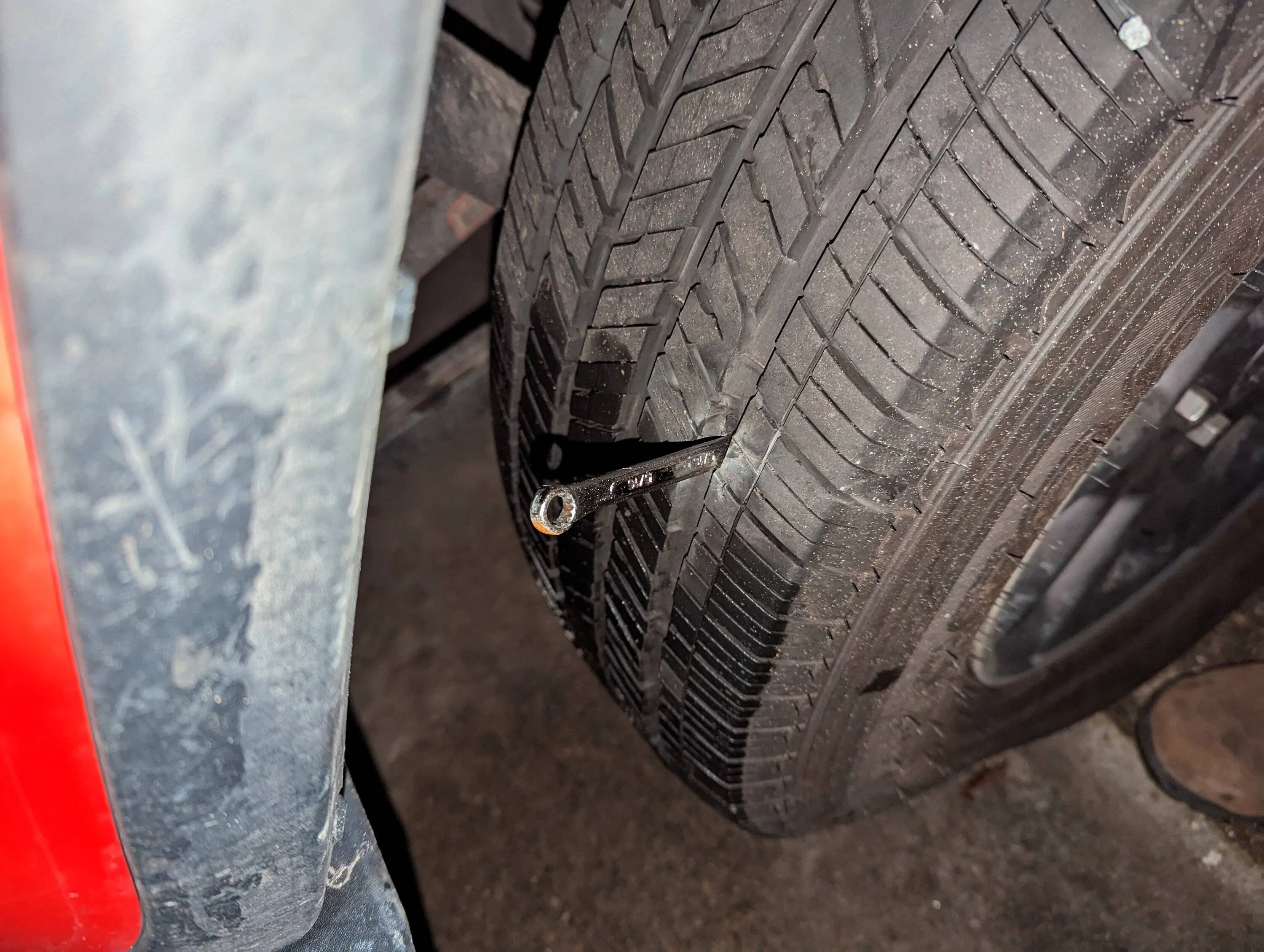

Sssoooo... My wife did a thing.
I bet her side of the story went something like…that’s what you get for leaving tools out…now fix it!!!
Curtjeep
Curtis
Mar 9, 2019
36
47
Jacksonville
2022 JTD Overland
Actually... That wasn't my wrench... She picked it up driving somewhere. She was lucky in that the closed end somehow sealed the tire enough to get home. It was pushed all the way in and was holding 22 psi...
