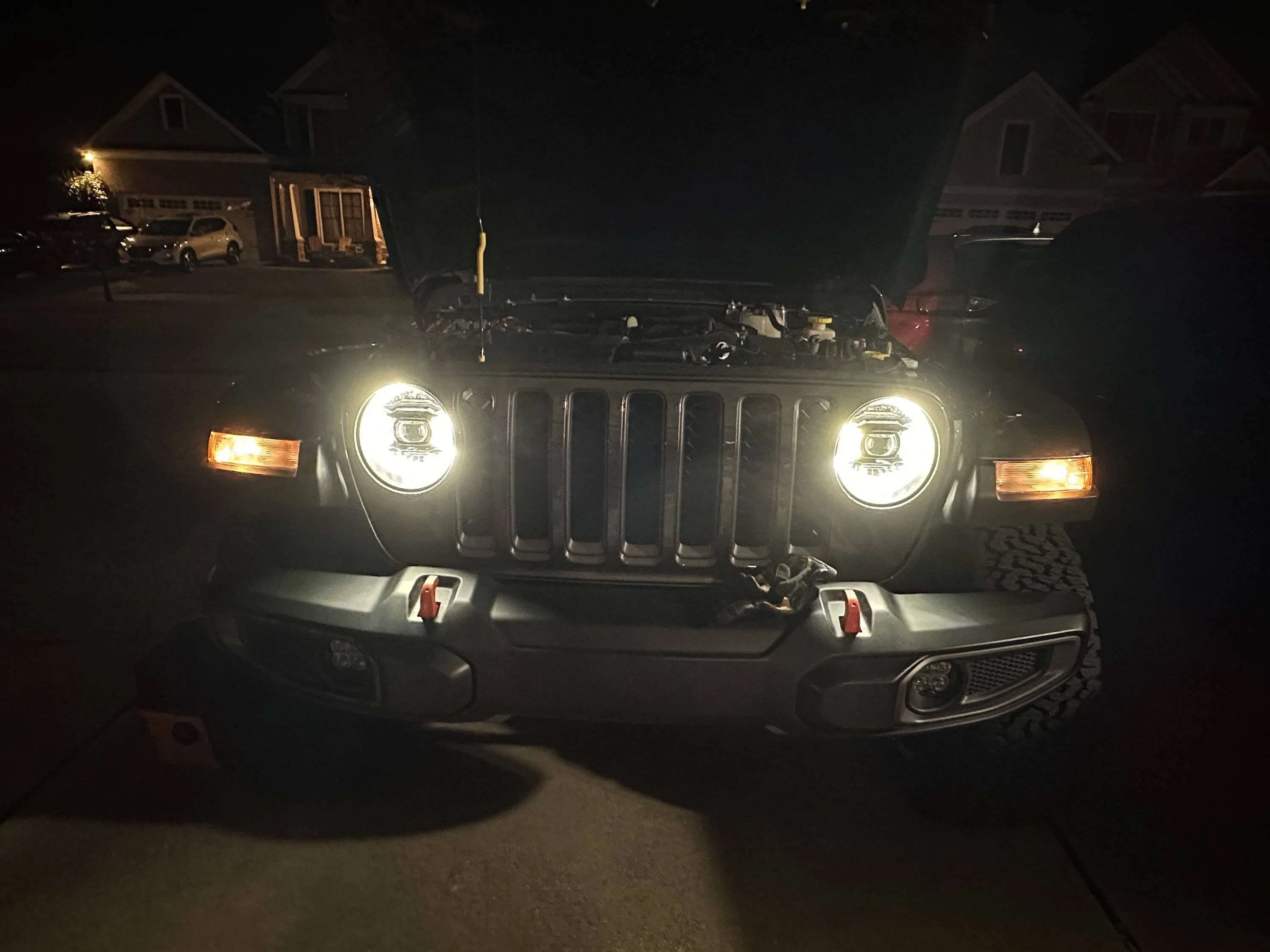

Yes problems started after I drove up and down the street. Now they seem to be trying to come on when I start it but not staying on. They then go back to only being lit up like the parking light config.
This is all I get now. Know it’s hard to see but the center projector isn’t lighting.
My issues were similar until I made changes in Jscan. I had halogens originally and had put led bulbs in. There wasn't a problem that way. When I installed the DD lights, it didn't like it. I had to change the front turn signlals using Jscan to led to get it to work right. Did you have led or halogen to begin with? Do you have jscan or Tazer? Sorry I went to bed and missed out on your last post last night.

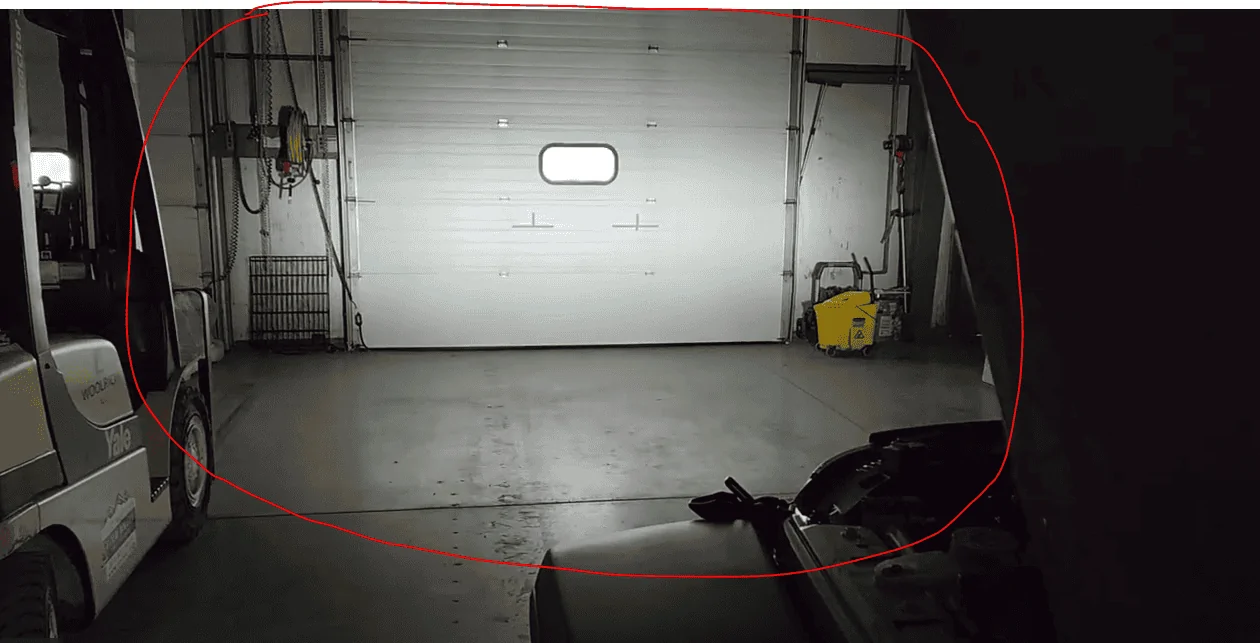

How bright are your offroad lights? I guess I expected it to be a lot brighter.
I haven't had a chance to test them in a really dark environment yet, but I feel like they are on par with my expectations. I think the goal of these is to just scatter light like a fog lens. They compliment the low beams nicely but don't shine as bright as dedicated pods. I wonder if @Diode Dynamics could give us a LUX reading on them just out of curiosity? I'm impressed that they thought of using that unused space for extra lighting. I'm sure they maximized brightness within the working parameters of space and extra heat.
Here's an image from my youtube clip of just the Off-Road lights... big scatter of light. I'm imagining in the woods this will be a nice alternative to dealing with a crisp low beam cutoff line halfway up a tree trunk. This wouldn't be great for high speed driving though as the wall here is only 25ft away.
If you have a Tazer or Jscan I think you need to set the front to LED like @rconkin said and you'll be set :)
