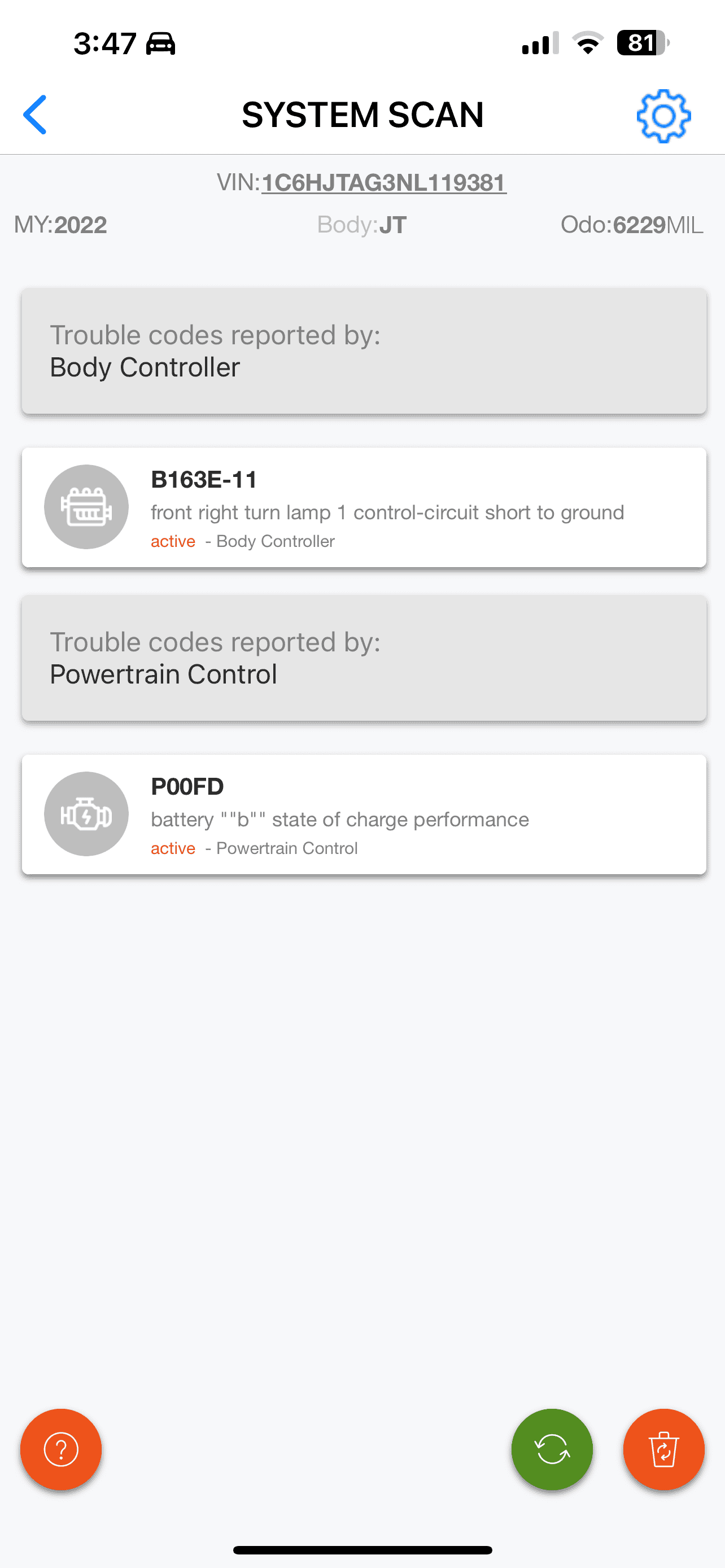

Got mine installed today and everything worked great until I started it. Lights go haywire and don’t work. I have 2 codes per jscan. Any ideas?

Did you have halogens before? Did you use jscan/tazer to change them to LED? Then instructions say you don't have to, but that's the only way I got mine to stop blinking...

What is happening when you start it ?
And also as I was typing someone mentioned making sure your halogen equipped JT is set to LED.

Apparently it didn’t like that I have led bulbs in front turn signals. Changed that setting and got turn signals and still no headlights. Changed headlights back to non led and everything started working. ? I do have auto start stop not ready and warning light on. I’ll worry about that tomorrow.

I didn’t unplug ASS. I had turned it off until I found out that it only disabled remote start. Turn it back on today.
