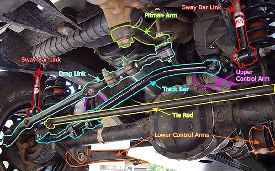

2 week old jeep and i'm on my way to work this morning and all of sudden the jeep starts acting like a front tire blew out. steering wheel shaking back and forth.
I pull over and nothing is wrong with the tires. Trying to get it looked at somewhere, but anything come to mind ?
After turning the jeep off i was able to get to work and return home without any further issues.

Just one last update after getting back from my Jeep dealer. They found a dead spot in the steering stabilizer and replaced it. Did an alignment and wheel balance and i am good to go.
They mentioned an upgraded stabilizer from a company called Fox if it happens again.
Anyone use these?

Masks the issue.
