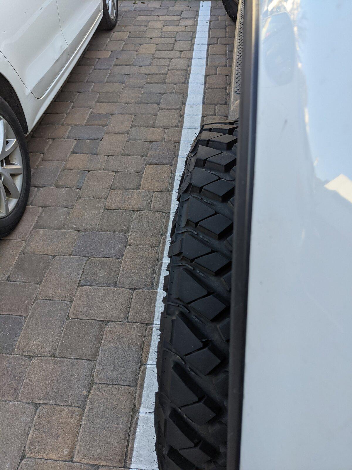

This is a 17x9 wheel with -12 offset with 35x12.5 tires.

All makes sense,appreciate it. The photo you sent was not sticking too far out for me. Thanks again
