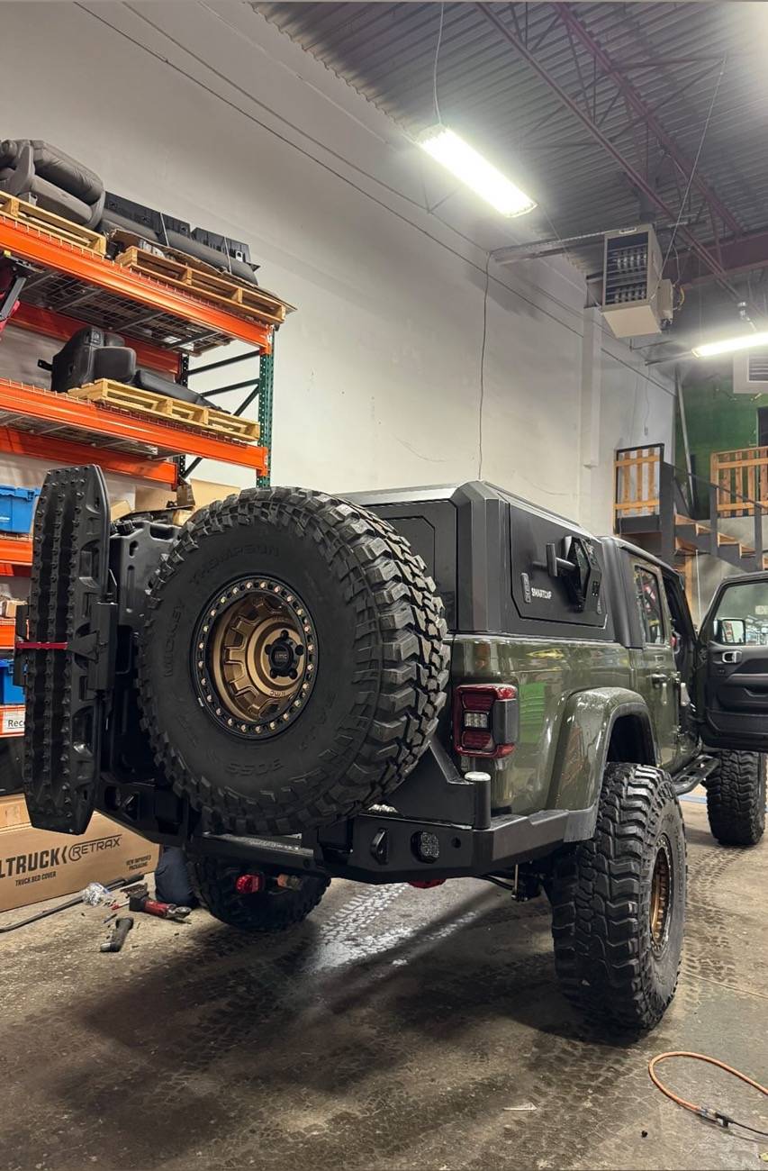

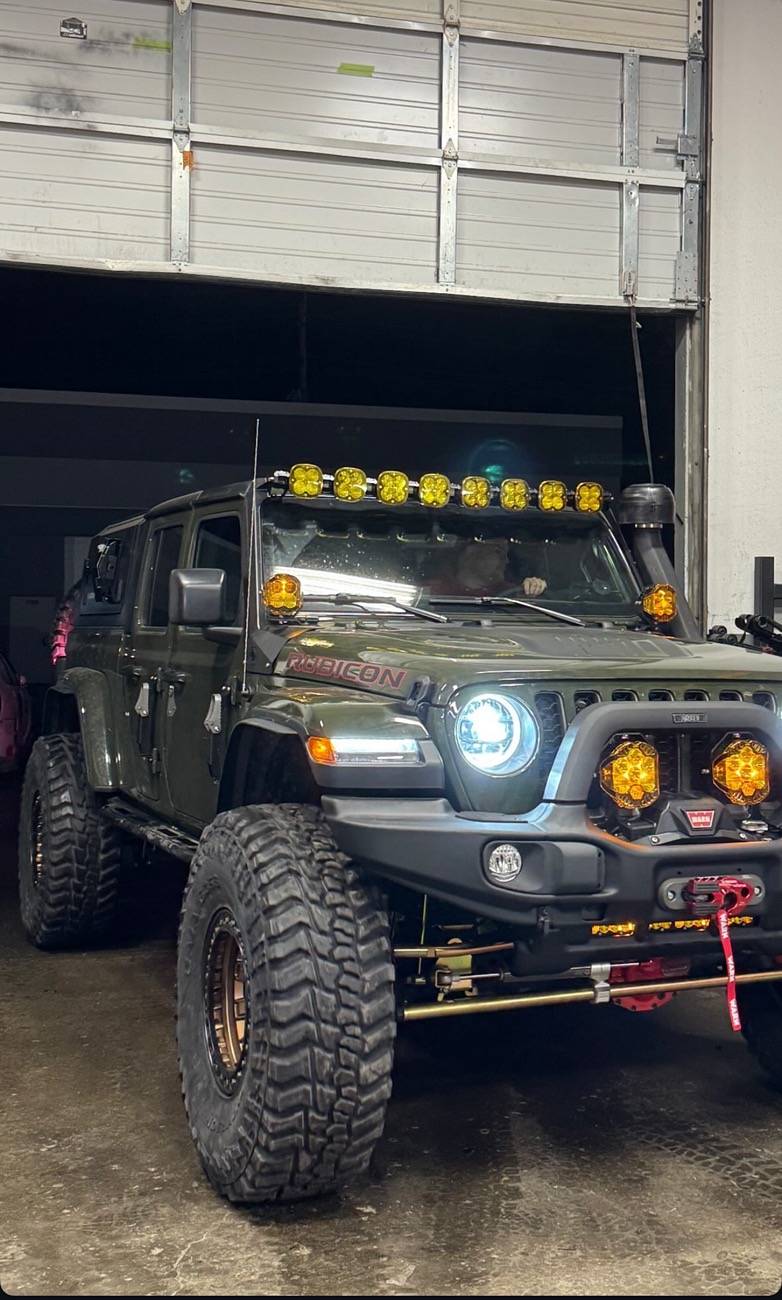

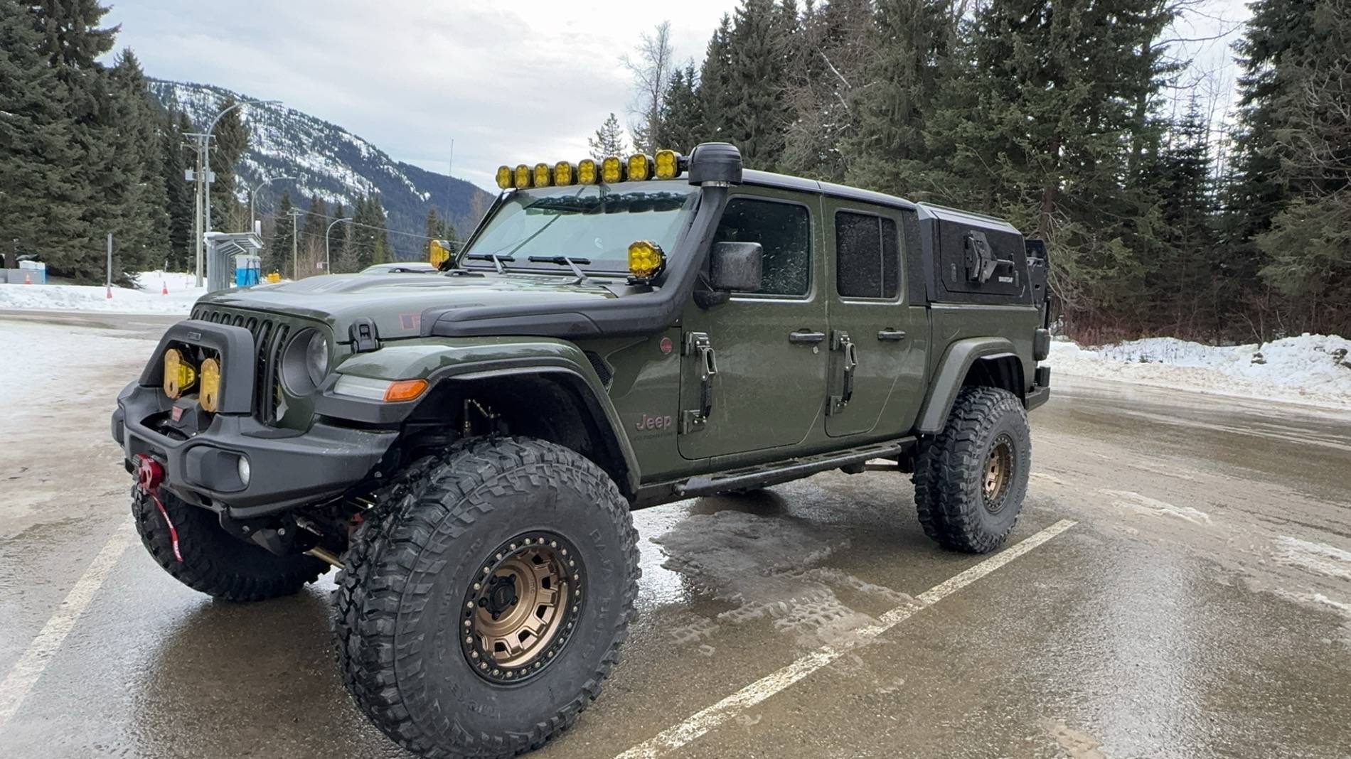

Well thanks for the help guys got it all finished made a few adjustments from
The original plan, but it turned out well…
After all that, still keeping the original wire antenna.
The OG antenna would be the last thing to go on mine. It actually does serve a purpose aside from radio signals.
