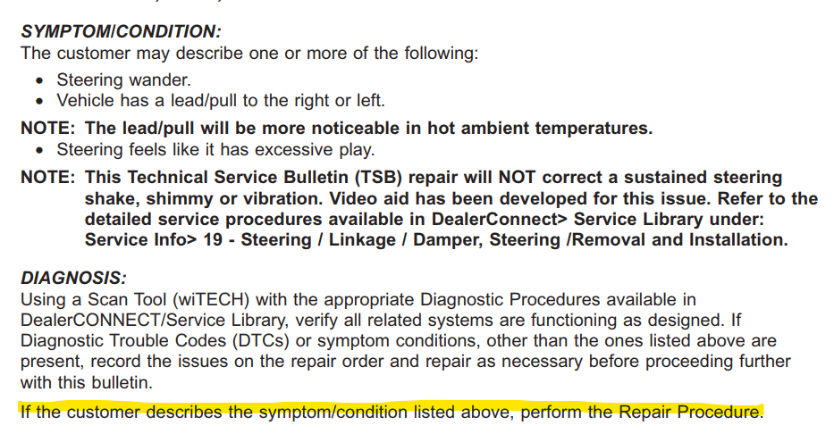

Can I get some guidance here. I bought a 2020 Mojave with 17k miles on it. Having already had a 20 Wrangler, I was well aware of the TSB and had it done on the Wrangler in 2021 no issues. When I bought the Mojave (1 month ago), the first thing I did was schedule a service appointment to get the TSB done. Told the service person that the Jeep wonders, has loose steering, and pulls to the right. My main dealership told me I wasn’t a tech and that I couldn’t make that assessment. I quickly decided to find a new dealer. The new dealer has had my Jeep for a week and told me today they couldn’t find any TSB that says to replace the aluminum steering box. Any advice on how I should navigate this? Thanks!

Point those idiots who say you aren't a tech to this - and tell them to learn to read and follow instructions -
YOU are the customer - YOU know if it has play or pulls or wanders. What a maroon.
Jeep Gladiator New JT Gladiator Steering Issue TSB 08-074-20 (for "Improved Steering Feel") 1668486160832
Then show them a printed copy of this - point out that SENTENCE.
I'm serious, I would indeed, I am just the sort to highlight that sentence and ask them to read what it says. Yeah, ask my wife - I absolutely would.
IF the CUSTOMER describes............. PERFORM THE REPAIR PROCEDURE.
Where does it say to tell the customer they are wrong? Where does it say "take it for a test drive and confirm? Where does it say to do or look at anything else?
I mean really, reading comprehension anyone?
I may not be the sharpest knife in the drawer, but that simple single sentence seems to say a career's worth.

That’s exactly what I sent to my service advisor (with the highlighted areas as well)! He said he’ll get back to me tomorrow, so we will see. I can’t fathom why it’s so difficult!
