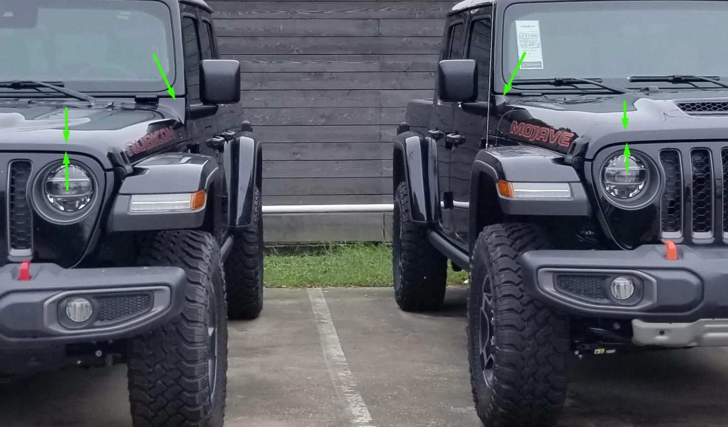

I took off the rr I had in my 19 rubicon wrangler.....I just put it next to the cowl on my 21 mojave and it looks like its the same size??
I also went to rr website, and it shows the exact same part number for both kits.
I threw some arrows to show the difference. The Mojave's entire hood is taller, as well as the cowl panels in front of the windshield. You can also tell by looking at the hood latch area, how much hood profile is above the latch on the Mojave vs the Rubicon.

Well shit....
Thanks....I guess my rr snorkel will stay in the box until a new intake cowl piece is made....if they even bother to...

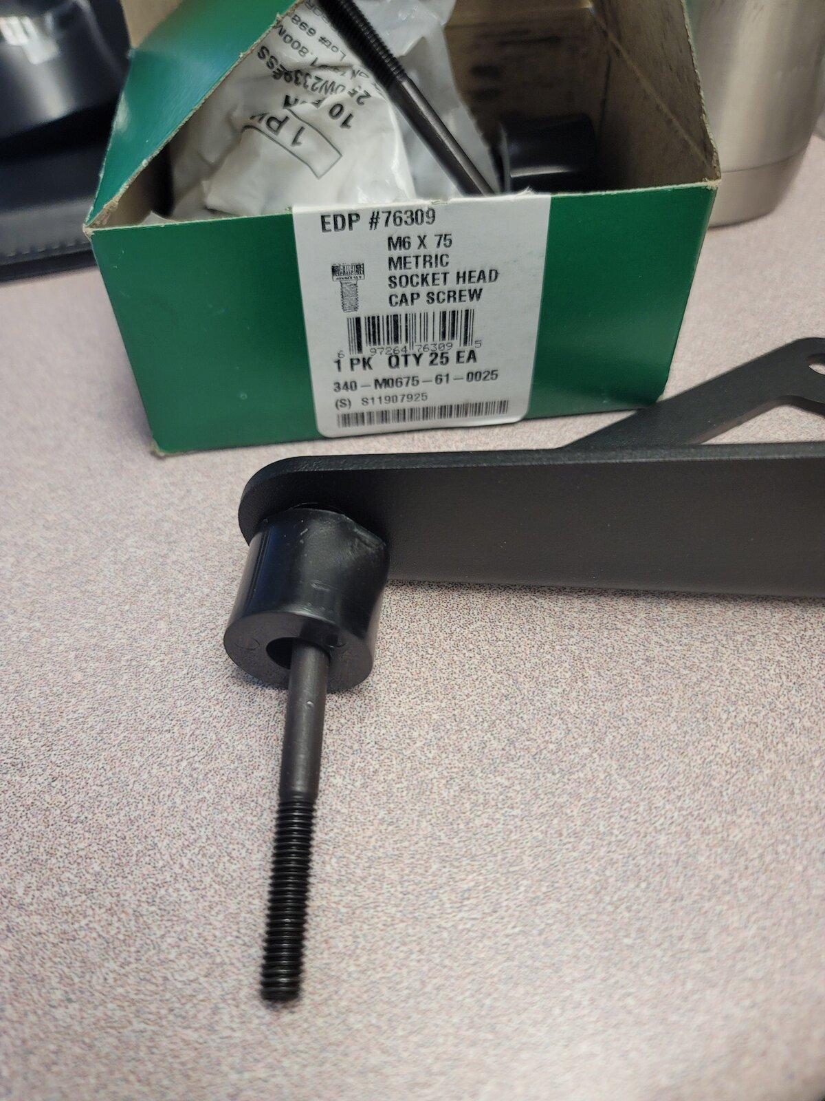

It's not at all. The bolts are 1" longer. I tried to put a cowl light bar on and bolts do not reach on my Mojave.
I just held it up in the day light.....yep it is bigger...shit,
thank you

The RR snorkle won't fit a Mojave. The cowl panels and hood are both taller on the Mojave, compared to the rest of the models.

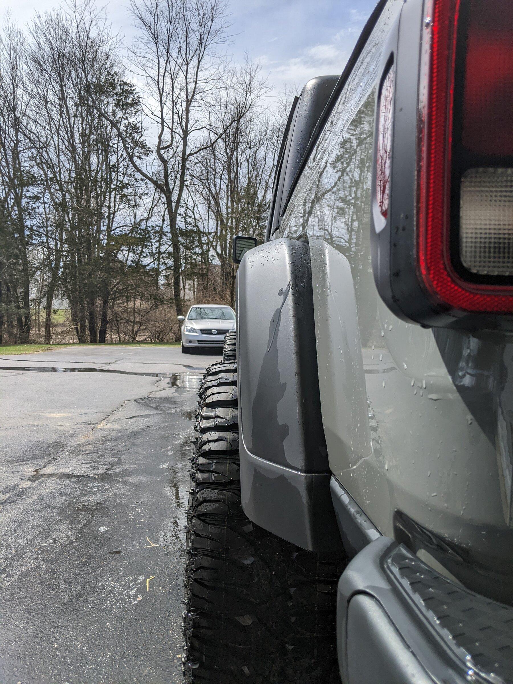

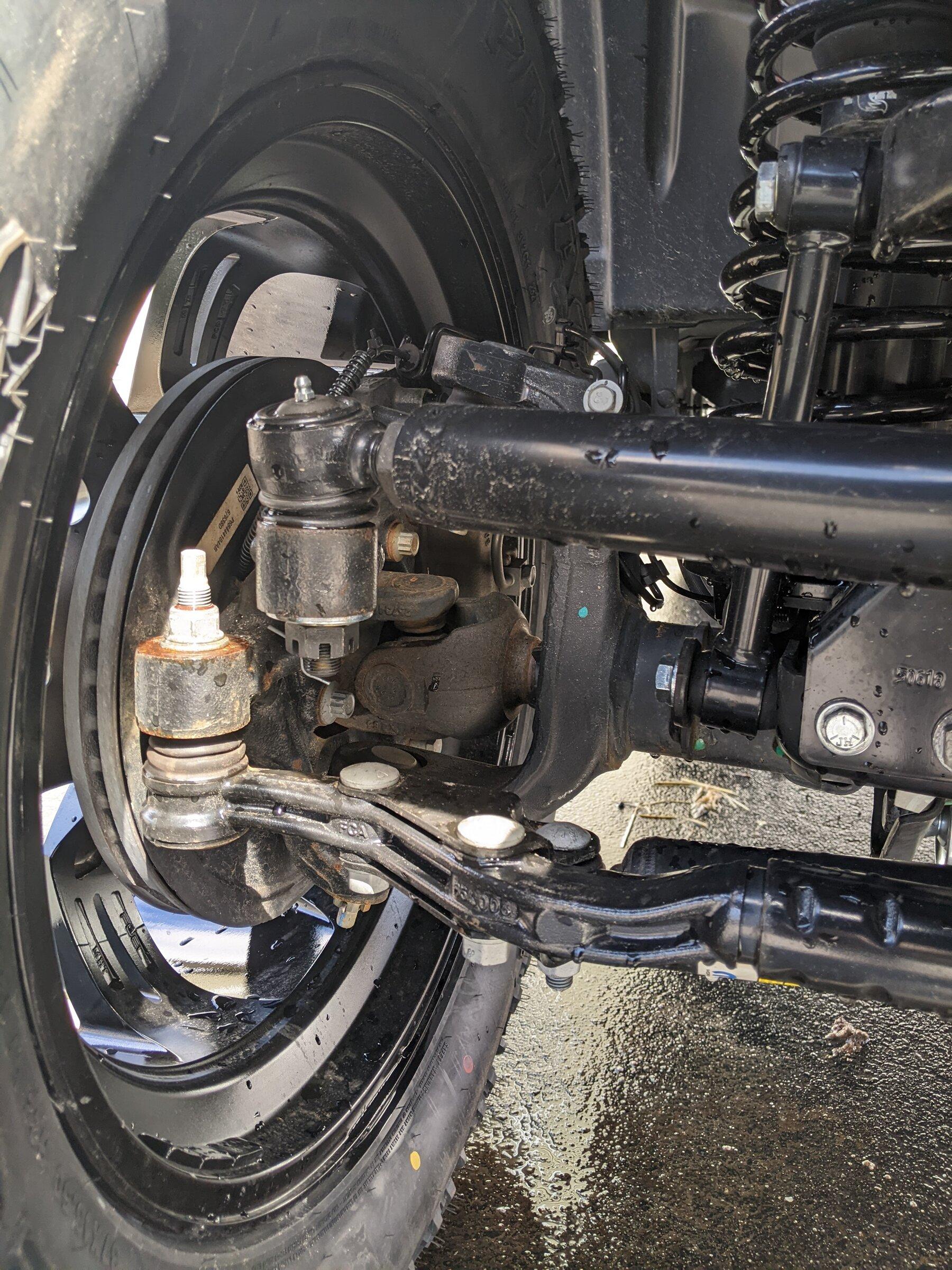

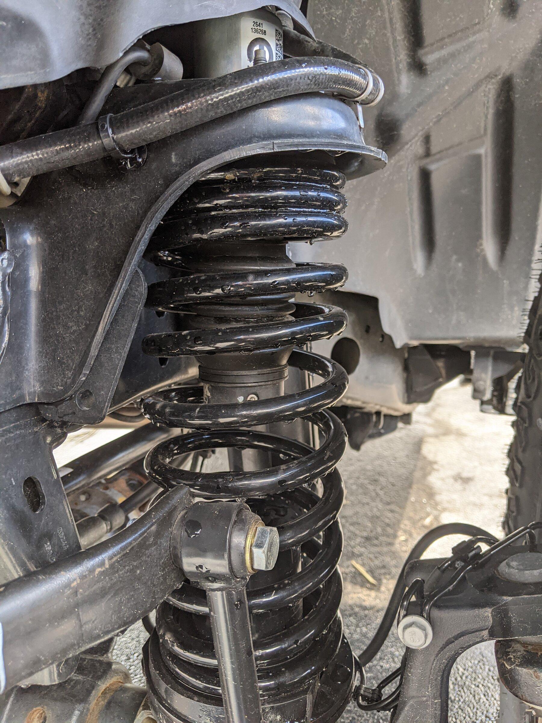

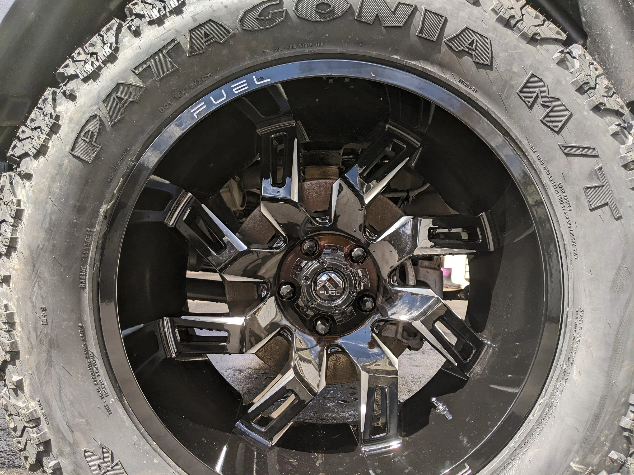

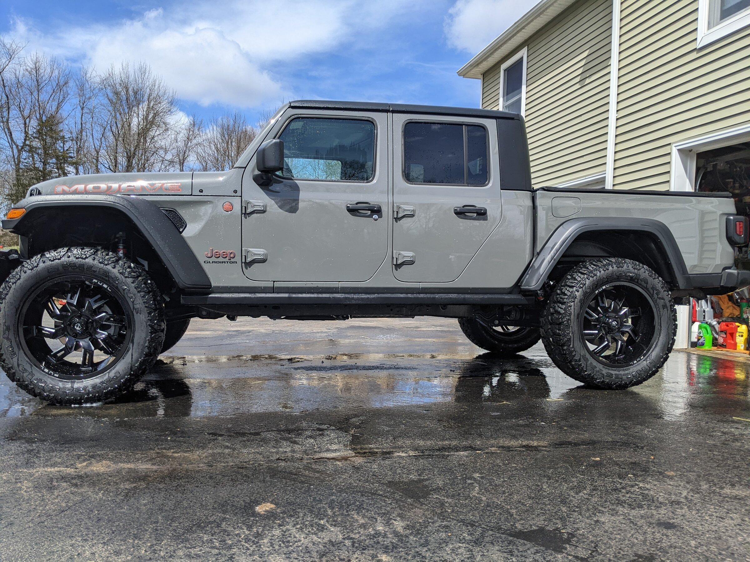

I put that same left on my Mojave yesterday. Kit was excellent, but directions are bad.

haha. I can confirm that. Couldn;t get a Lightbar mount that would fit. Took a couple vendors to figure out why their mounts would fit a Mojave.
