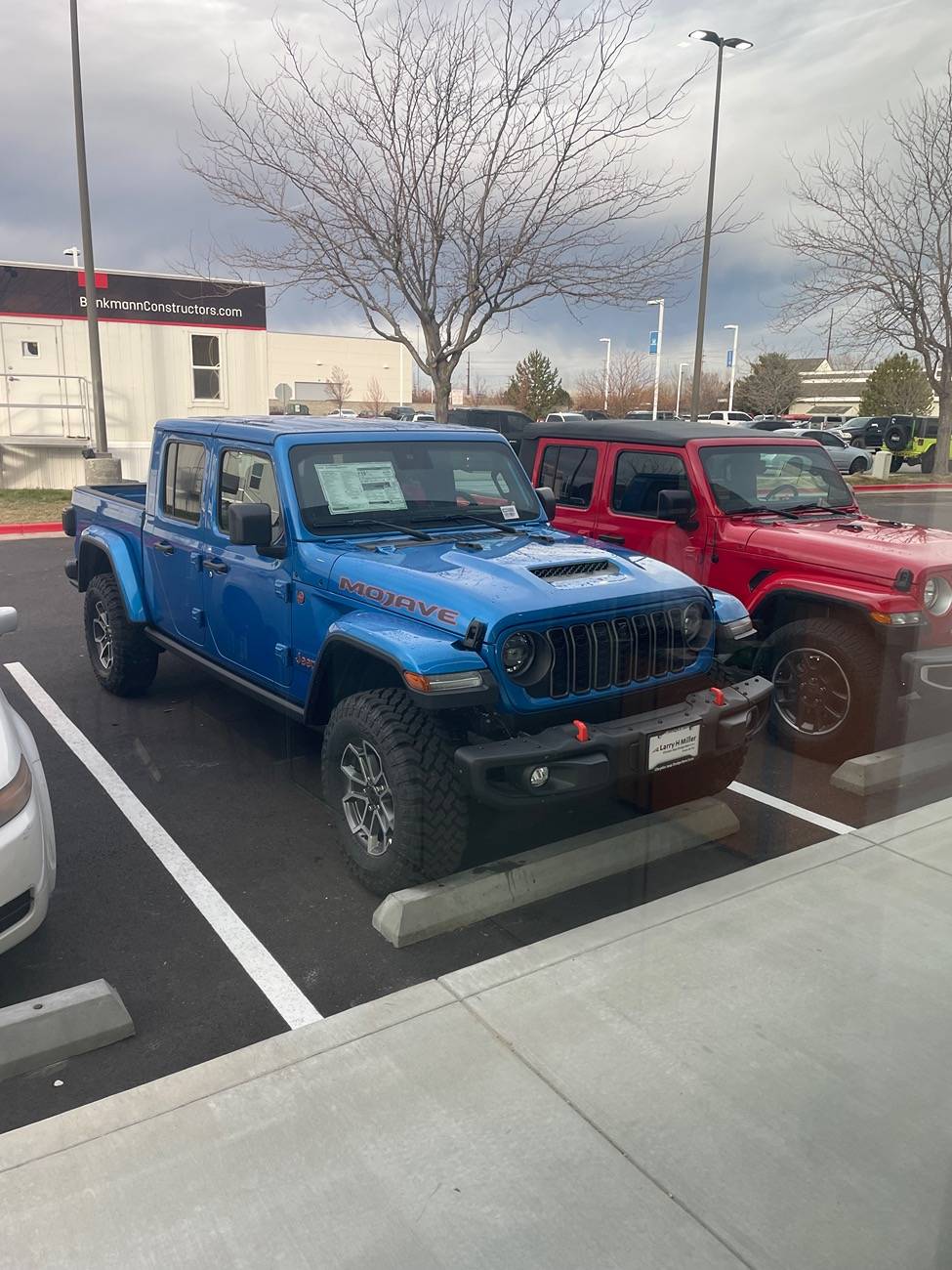

I am picking up my new Mojave X tomorrow, transfer case is “ it’s about time”. Previous Glad and Wrangler owner, traditional 2 H 4H 4L transfer case. This Mojave has these functions plus 4H and 4L Auto, reminds me of the former Quadratec full time 4WD from days of old.
I live in the West, hairpin turns, half the time ice and snow, other half in the sunshine and road bone dry. Auto setting solves the problem of shifting in and out of 4WD. Question is, how does it work?
Pic is new Mojave next to my three year old Overland.
