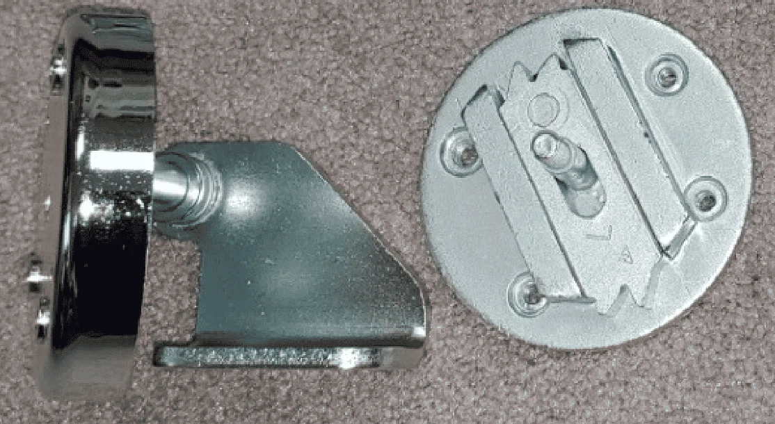

For those lurking, wondering -
I haven't seen galvanized nuts except in certain farm supply stores. I think I have some in my shop I bought long ago to replicate the fasteners used on some of my antique engines. A few used galvanized fasteners to bolt them to the trucks they were mounted to.
As far as different "coatings" - zinc plated won't matter whether it's black, yellow, blue/clear or green.
Zinc can be as bright and smooth as stainless, or as dull as cad plating.
My OCD might not like the different plating (all likely zinc) but it would only personally bother me for the appearance.
Zinc may be very very bright and smooth, or dull. It's usually more blue than say stainless but to the untrained eye - it can look the same unless compared to known samples.

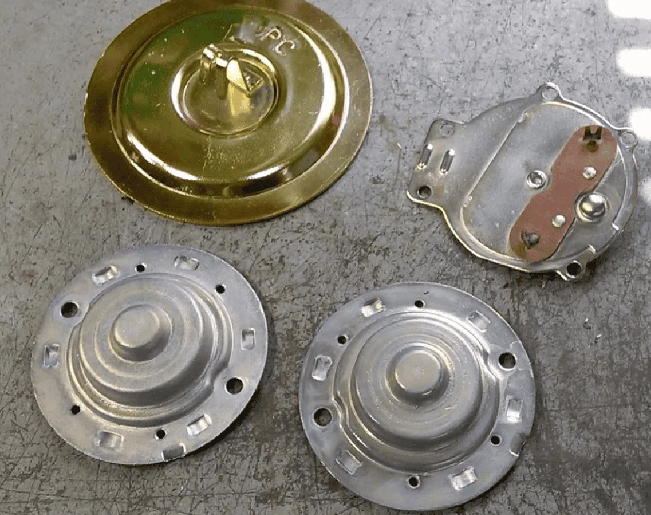

These are all identical plating - all zinc from the same tank, just done with different amperages, passivates and passivate timing ->
Jeep Gladiator New Mopar 2" inch lift coming out? 1671596041335
Jeep Gladiator New Mopar 2" inch lift coming out? 1671596075198

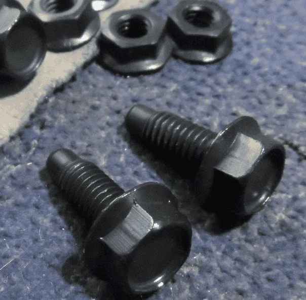

All zinc - plated on the same day ->
Jeep Gladiator New Mopar 2" inch lift coming out? 1671596150202

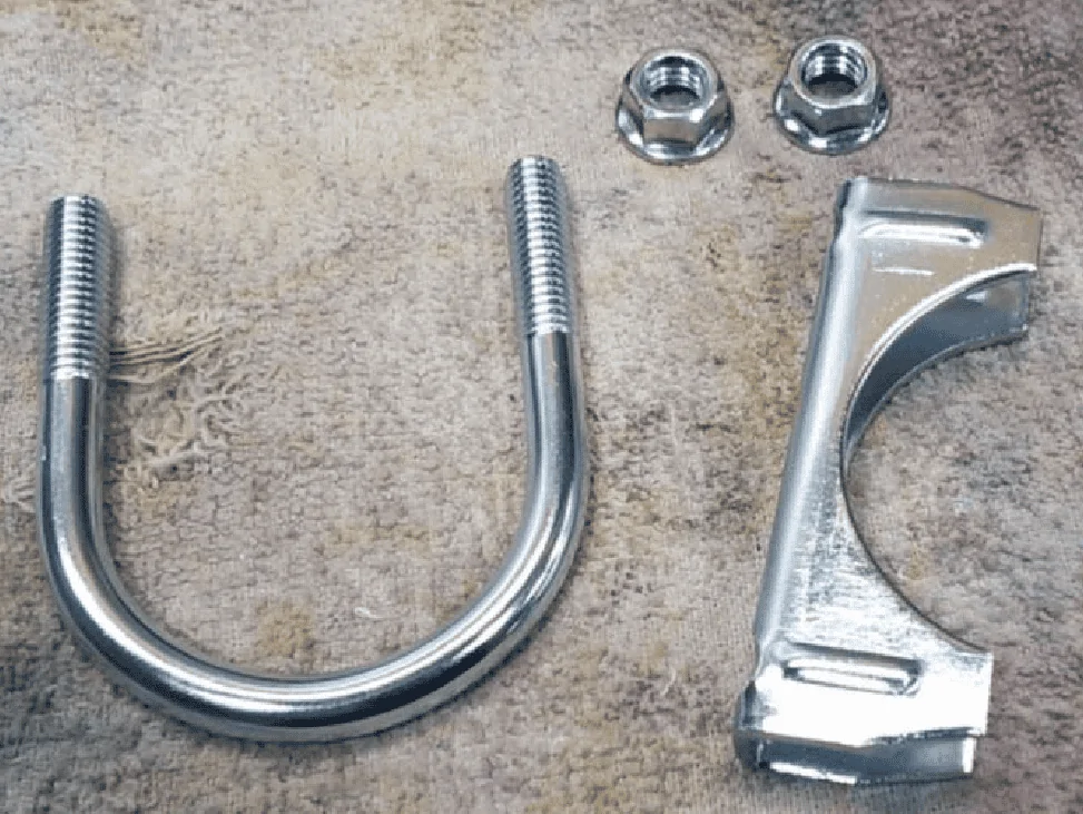

Zinc - the exact same metal as above ->
Jeep Gladiator New Mopar 2" inch lift coming out? 1671596251818
The only thing I'd not like under my truck is a black oxide but those are more dull. They don't resist corrosion worth a crap and are seldom used in critical areas.
