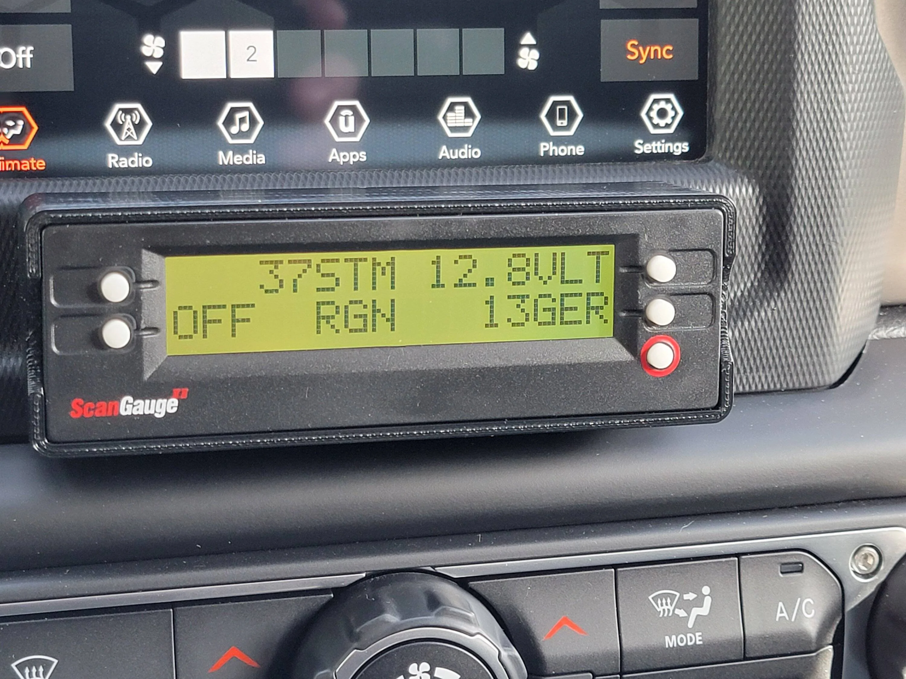

  • Change the fuel filter and drain the water at every oil change. Remember to prime the fuel system before trying to start the engine after changing the fuel filter. Otherwise, it will continue to crank. If you notice it is cranking and not starting, hit the start/stop button to stop the cranking process and repeat the priming process. My dealer killed my battery the first time they changed the filter. Now I change the filter myself. It saves the battery and a boatload of cash at the same time.
  • Use Hot Shot EDT fuel additive with every tank. Keeps the fuel system well-lubricated.
  • Use MOPAR filters, and recommended motor oil. I use Pennzoil Ultra Platinum Full Synthetic 5W-40 Motor Oil.
  • Watch the short drives. I recommend getting an OBDII scan gauge of some type. I use the ScanGauge II. One thing to note: I don’t know if anyone else sees this, but on my Gladiator, it does not always show when it is in Regen. This gauge not only tells that it is in regen but can also tell you how full the STM is. My Gladiator goes into regen at 80%.
