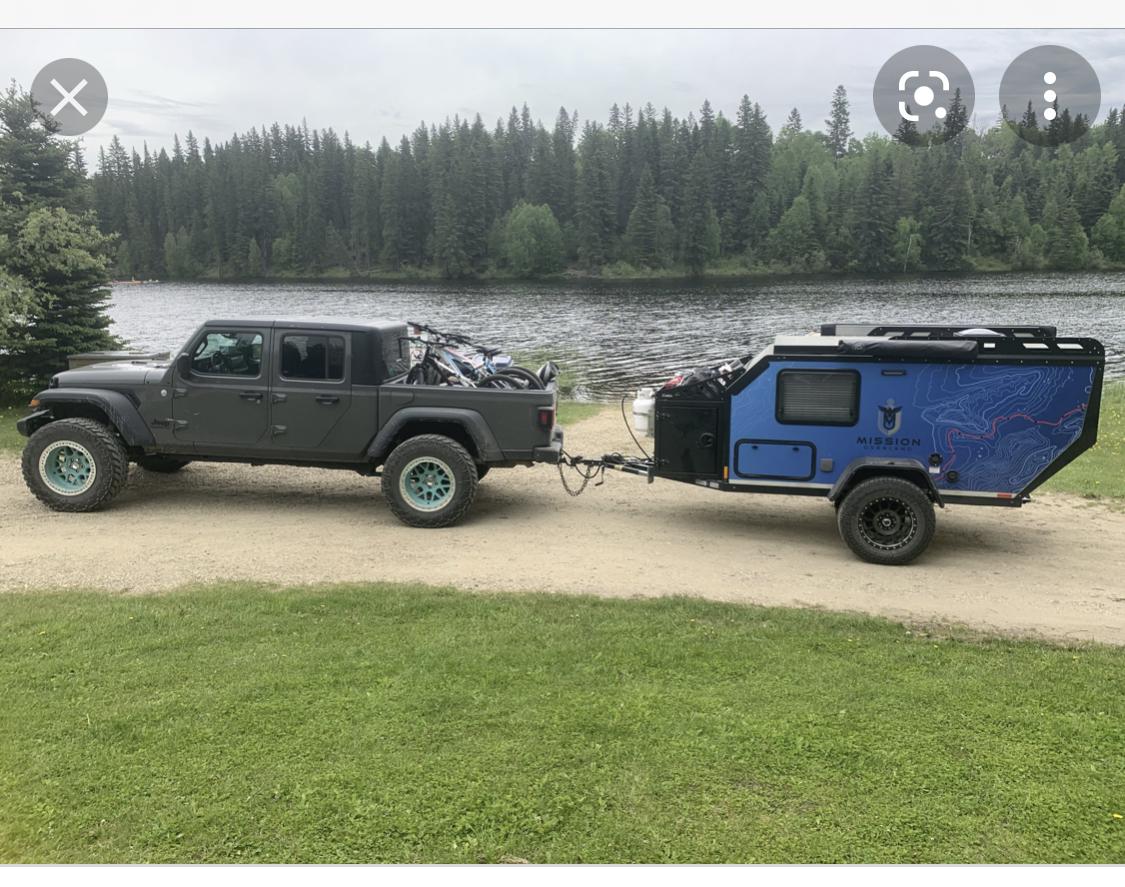

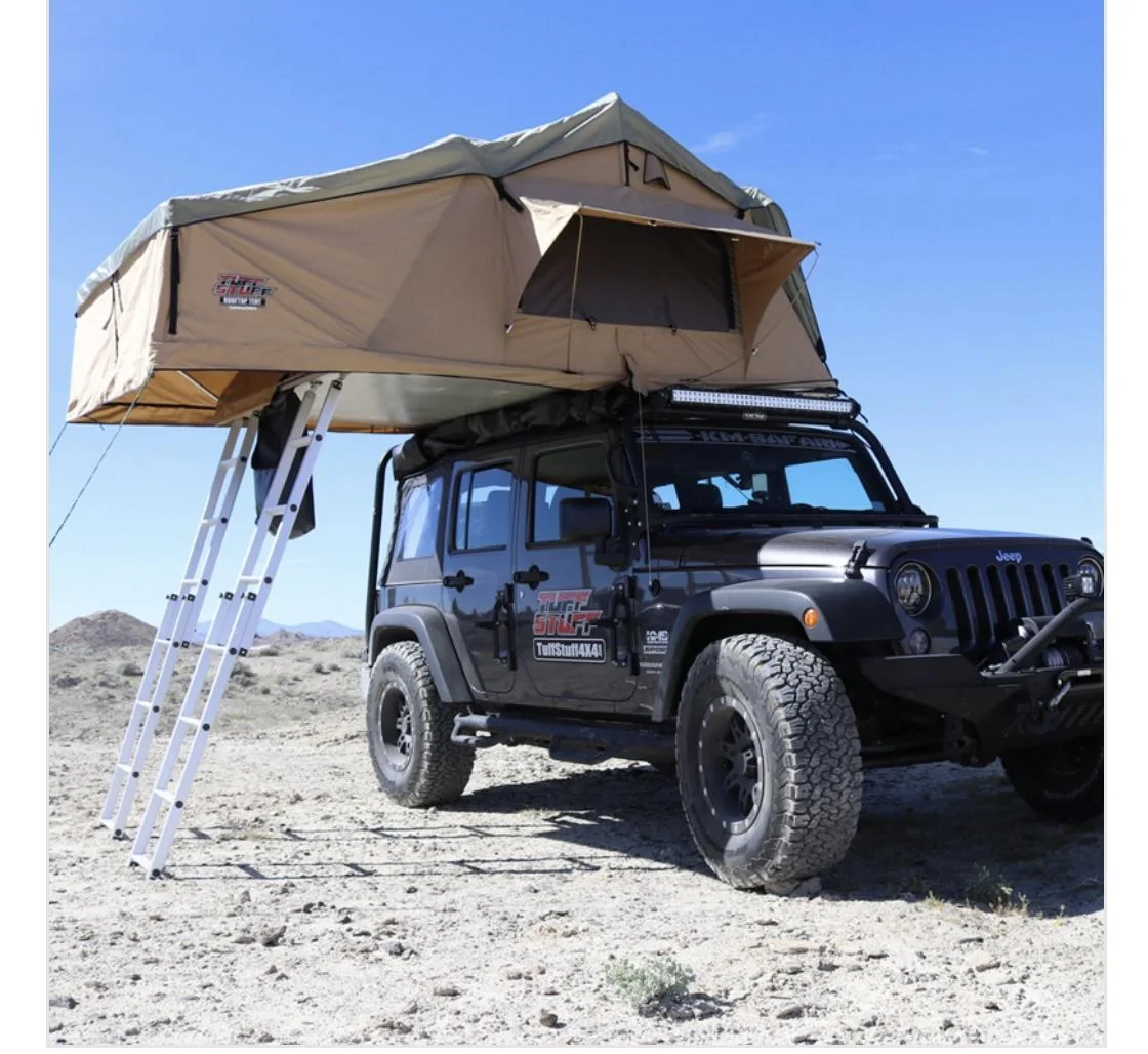

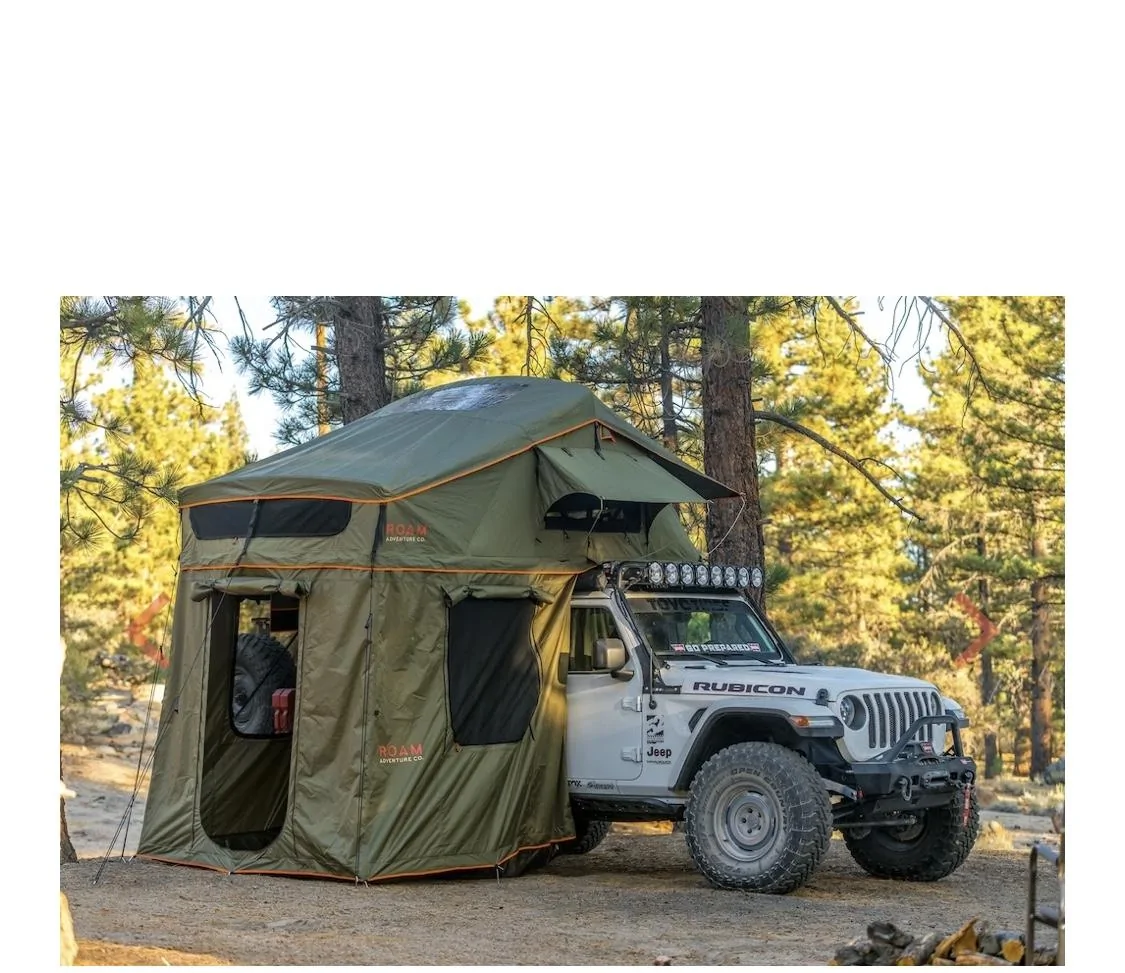

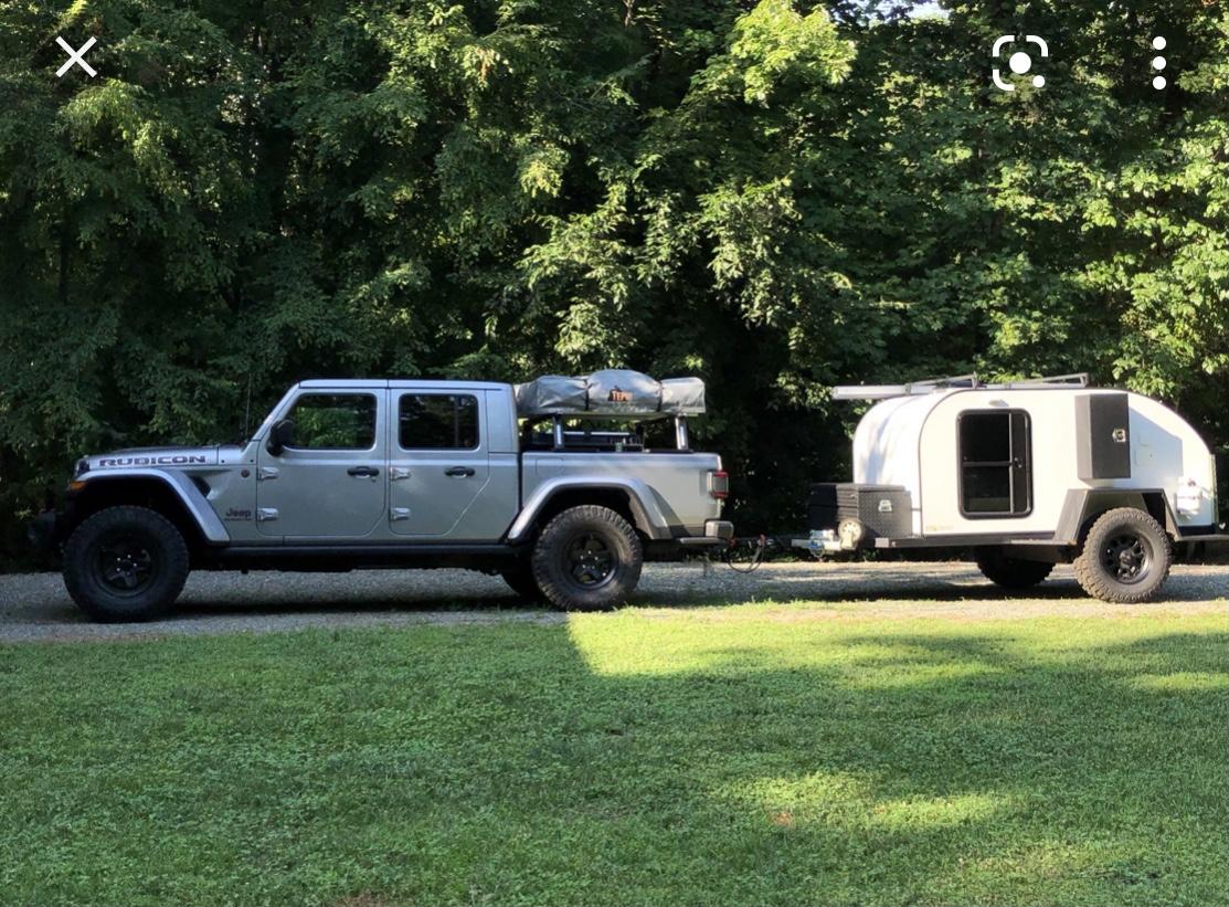

I have BIG dreams of learning all the in’s and outs / wanna take a mechanics course - but wanna buy quickly before there is nothing left to buy! (Chip shortage). So as a total newbie I really want to know what I should be asking for, what I need in my truck.
Here’s what I want to do w my jeep:
Camping - no crazy Boulder driving but def off road. Want to be able to take a small to medium trailer or a camper that sits on the back of the truck.
what are the basics I should be asking for? (I really am
Green so pretty pls talk to me
Like I have no idea - bc I dont
do I need aux switches set up?
love the idea of power in the back of the truck bed for camping purposes
do I need the better tow package?
what kind of tires?
is auto okay for towing?
Overland or California ?
already lovin the vibes of the jeep community - always wanted to be a part of it!
thanks a million in advance!
photos = what I want to be able to do.
