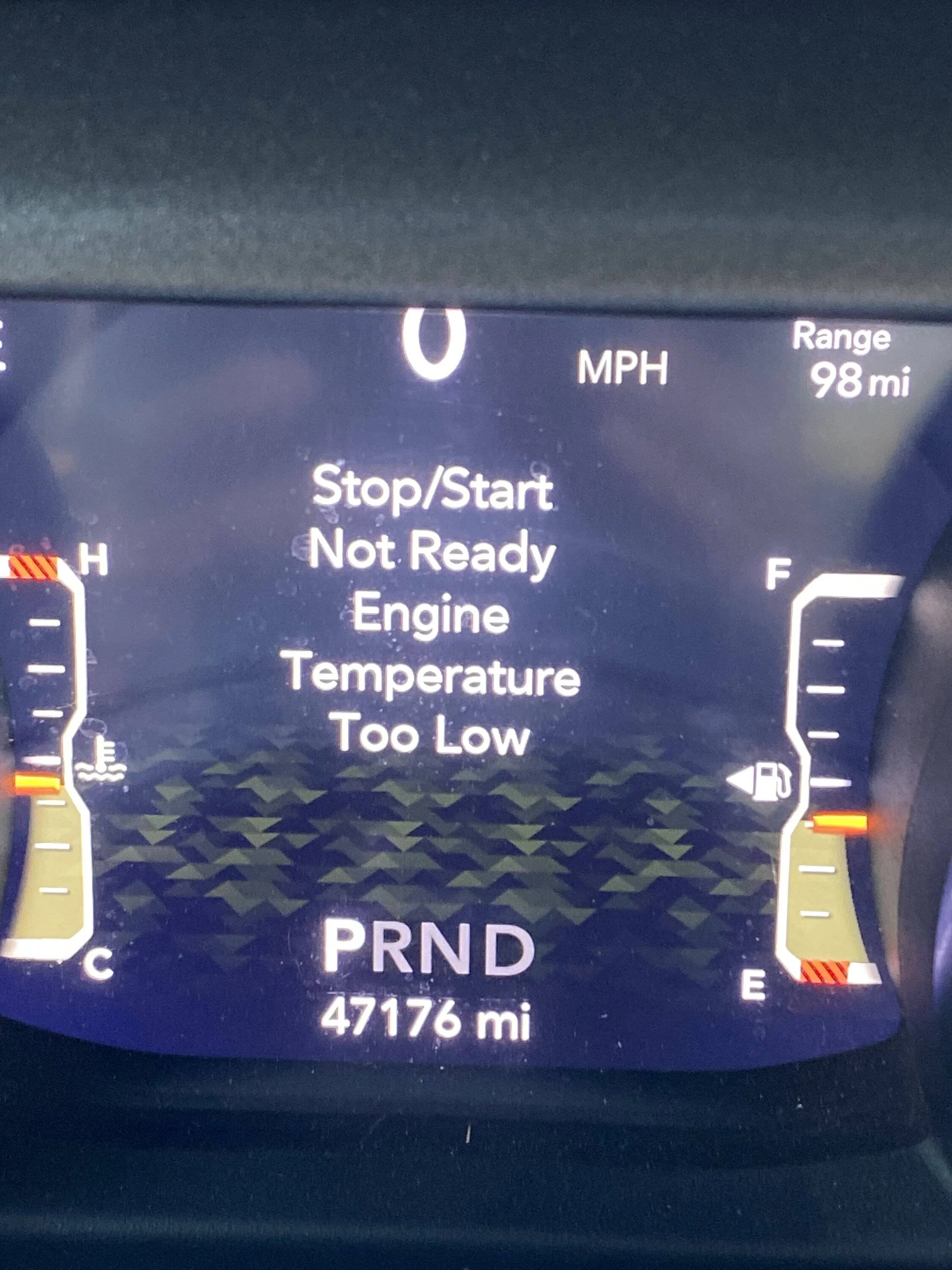

So 2 days ago I’m leaving for work and no power steering. I have had zero issues with Jeep since (new) purchase in ‘21. Researched on here and am leaning heavily on possible battery failure. No lights or warnings on dash. Had wife double check while I’m at work, nothing. But she said it tried to start but did not start. Second try it started. Later in the day she started it and left it running for a while and power steering is back. But “Start Stop not ready temperature too low” Would this be Aux battery starting to die? I’m headed home today and plan on getting a new battery. Any help would be greatly appreciated.
‘21 with no additional electrical equipment. 47k miles.

That just means the engine isn't warmed up yet and nothing more.
If it says "battery charging" that's different.
Ignore most of the bull crap that says it's the aux battery because it could be EITHER battery, or both.
PS works off the main battery, not the aux battery! The EHPS pump is connected to the main battery via the high current fuses. So that means the supply coming from the main battery was too low - HOWEVER, once the vehicle starts, you should have PS because the alternator is what really powers the power steering.
So this tells me your main battery is an issue - it was too low to start, then when it started, it was such a draw on the alternator that there wasn't enough power for the power steering pump.
Go to a dealer and have them check the batteries - BOTH batteries. My gut says the main battery because of the fact the EHPS wasn't working properly even after starting - it's connected to the main battery and alternator once running. Not the aux.
Don't rely on what you read in forums as far as batteries - at least half of it is wrong.
And take a look at what that message says - read it - does it say BATTERY, or does it say ENGINE TEMPERATURE.
Yeah, the engine wasn't warmed up so of course ESS won't work. There's at least 24 things that must line up for ESS to work.
If you saw battery charging, then it's an electrical issue - like a battery bad or low.
