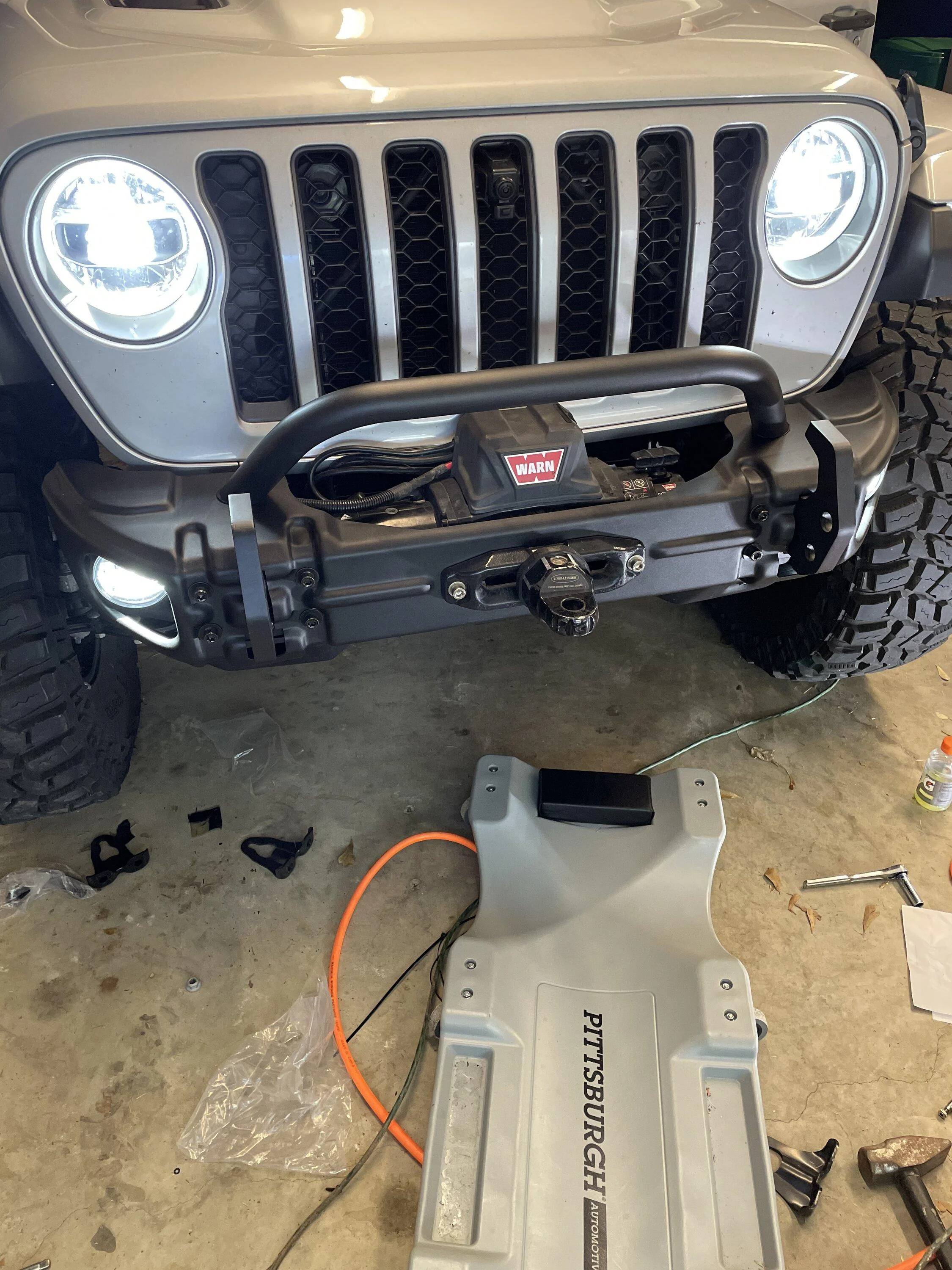

Has anyone who installed the Rugged Ridge Arcus also installed their OEM LED Rubicon Fog Lights ?
RR instructions say the oem JTR LED fogs do not fit / mount.
Any input as to if a fabricated adapter ring / mounting bracket would make theses fogs compatible?

Contrary to the online instructions from RR and the YouTube install video, the OEM Rubicon LED fogs will work with the Arcus.

Installed last night rubicon led fog
Yes sir they do work.
When 1st checking out the Arcus
I found 2 places that said those didn't work

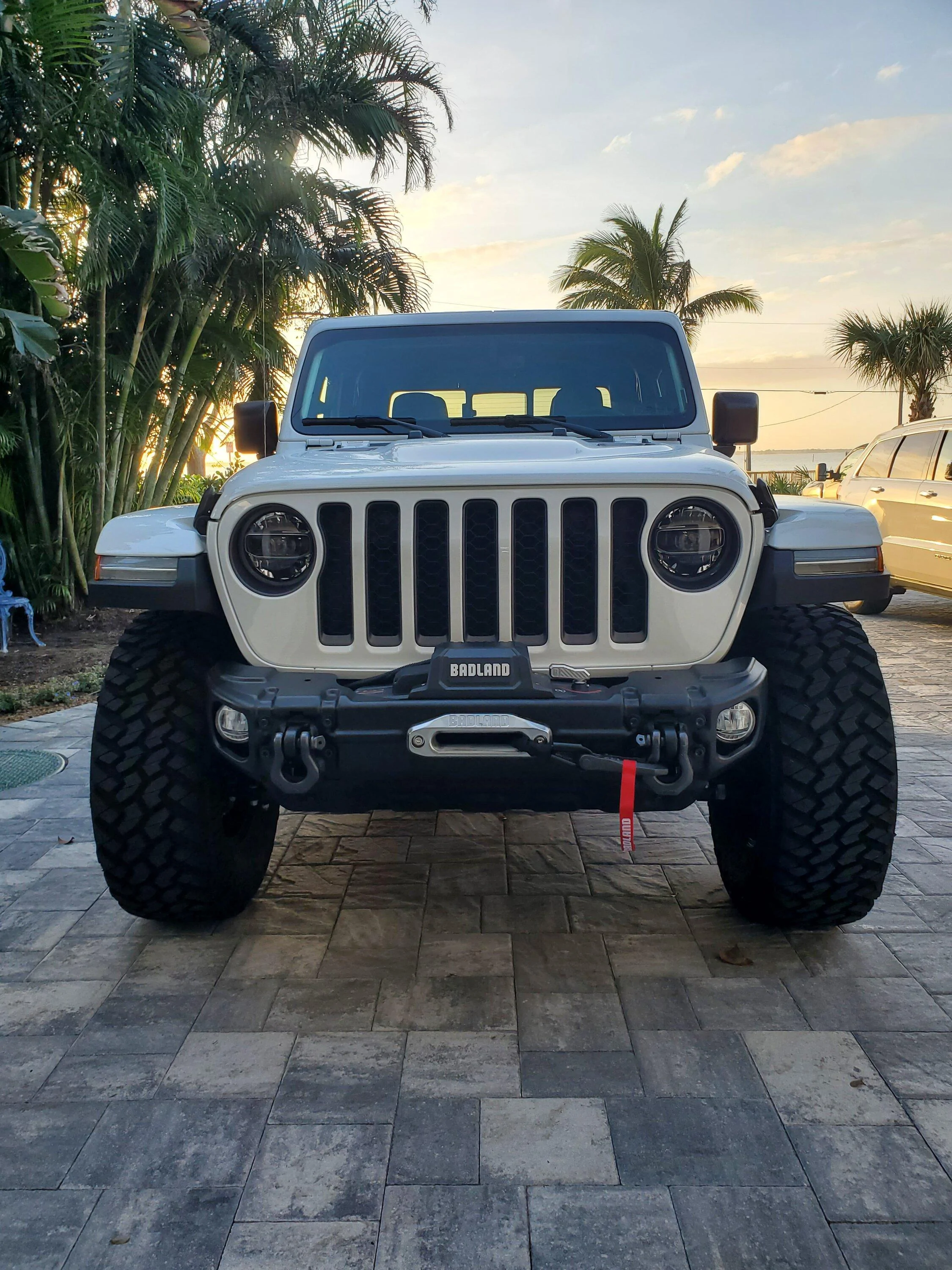

Do you have a link to your shackle mounts? I don't like the tusks all that much and think yours looks great.

https://teraflex.com/jk-d-ring-mount-each.html
You will need to cut a small round nib off the back
I bolted it onto the frame horn in 2 holes with the Arcus nut plate to hold it while I used a Sawzall with a good metal cutting blade , same for both sides
Then touched up with Krylon

The Teraflex extended out further than the Rugged Ridge similar mount .
RR doesn't extend out enough to clear the Arcus shell and leaves the shackle hole too close to mount a shackle
The TF was also quite a bit less than another tall tab one that I found.
RR doesn't extend out enough to clear the Arcus shell and leaved the shackle hole too close to mount a shackle
Thank you! I had read the RR didn't extend enough. Adding the TF to the list of mods to be done.

1 more thing
The TF has recessed ring around each bolt hole
I put a 5/8" galvanized split ring washer in each one to back fill the space between the shell and mount.
